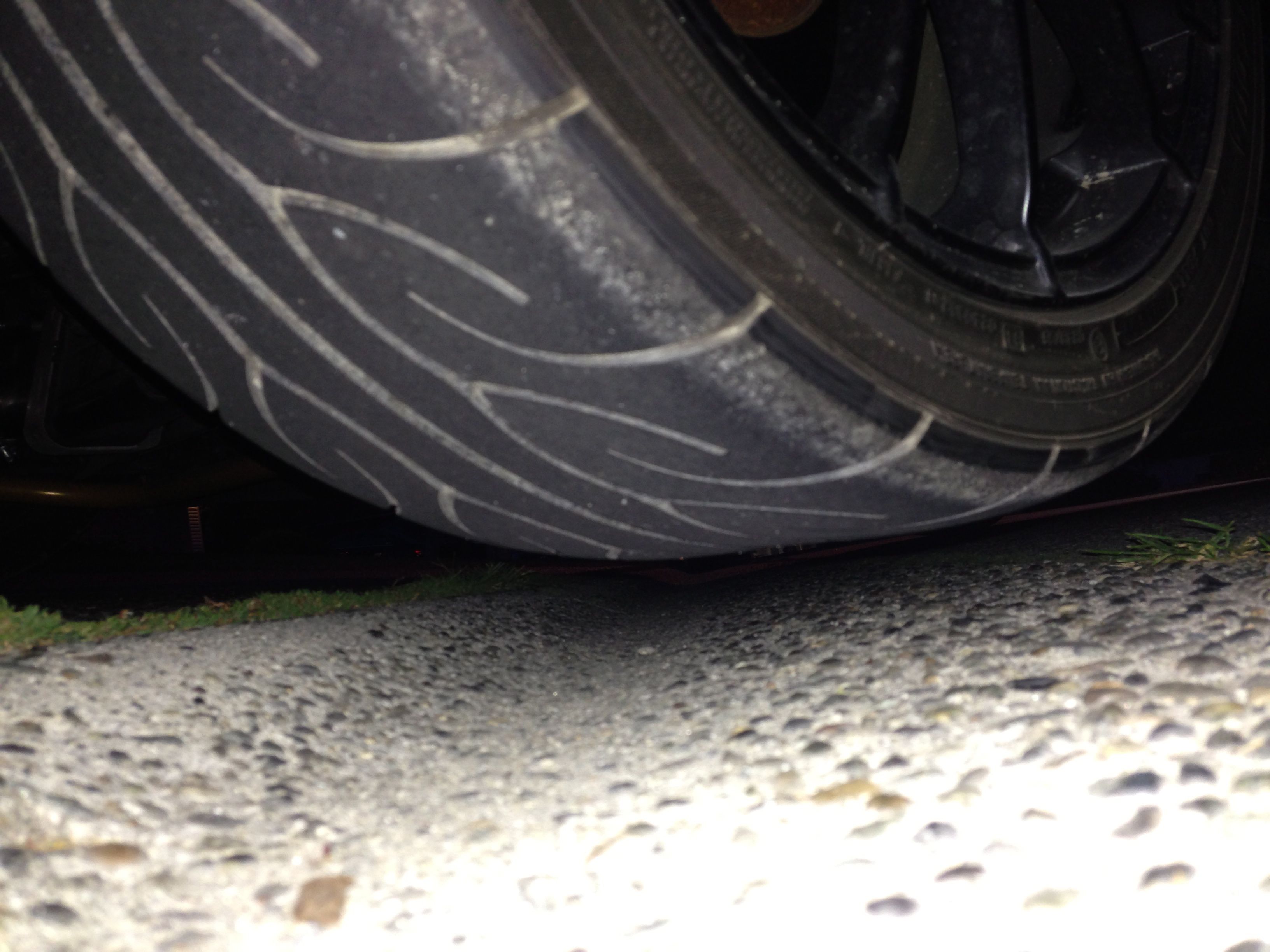

Old Nov 22, 2013 | 09:33 PM
kzak104's Avatar
Joined: 03-18-12
Posts: 1,887
From: Langley, BC
I dont rub with 235s on my 17x9s +30.. granted im not that low in the rear, maybe one finger gap or so
i do. lol, not to bad tho. just touches sometimes, going 225 next summer
