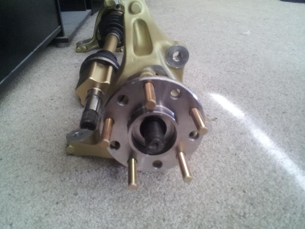

I had 4 x 100 put onto my 5 x 110 hubs by member ItailianJoe1.
Been on my DD x 6 months now, no problems, & 12.5s at the track...

I converted my LS to a 5x114.3 pattern. You need to get LSJ hubs for all 4 wheels to re-drill them, I had Jeff (Screen Name Mongorat) re-drill mine for me. YOU DO NOT HAVE TO SWAP TO REAR DISCS FROM AN LSJ TO CONVERT TO 5 LUGS, I DIDN'T.. Chevy made cobalts with a 5 lug rear drum. just buy those drum brakes and drill the 5x114 pattern on to them the will literally bolt right up to your drums. with the conversion.
Link to Drums:
http://www.ebay.com/itm/Cobalt-HHR-Pontiac-G5-2-80122-Brake-Drum-5-Lug-Drum-/220734754678?pt=Motors_Car_Truck_Parts_Accessories&hash=item3364d10f76&vxp=mtr
To do this conversion you will also need an LSJ brake setup for the front. your calipers will be too small for them to bolt up to the new, larger discs.

If You swap to LSJ hubs and re-drill them for the conversion you NEED an LSJ front brake setup as well. Your LS rotors are too small and will not fit over the LSJ hubs.
You will need:
LSJ Hubs All around (2 front, and 2 rear)
Front LSJ Calipers
Front LSJ rotors
Front LSJ Pads
Rear drums from a 5 lug cobalt (the ones I linked to earlier)

Wrong, HIS 4 LUG ROTORS WILL NOT FIT ON THE LSJ HUBS, they are too small. I tried to do this with my setup and found out the hard way. He needs an LSJ brake setup to for the front if he plans on using LSJ hubs.
