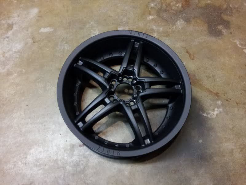

Local guy is selling them for 200$ w/out tires and was wondering if they would work...came off a g6. they are 18x7.5s
wondering how they'd look on SRTC, think it'd be okay. looks p.similar to stock spoke design wise.

I dunno if they'll clear brembos.... but otherwise they'll fit

so is the pattern 5x110 or 5x114? 200$ is a good deal tho it seems.
and before you buy them jus mount one on the front to verify they clear the calipers

Its prob dual bolt pattern an by the look of it I dont bink itll clear the brembo's because of the way it curves

The redrill looks a little too close for comfort.....they might need a small spacer to clear the califers but I'd be worried that the wheel won't hold up.

that is also something i noticed, on how close together the drilling is...if it was going on something slow like my Passat I wouldn't worry about it...but the Cobalt has well over twice the power and the thinness of the metal between the bolt holes kinda scares me.

Walk away

why are they drilled so close? you got like a tooth pick of metal there

not a fan of that redrill at all

/\ What they said. Looks like there might not even be metal in between in some places.
Also with that concave I doubt they will clear the brembos.
I took my old rims from my G6 and used them as winters and they were concaved a bit and 18x7.5 I needed a 5mm spacer but those ones seem even deeper.
