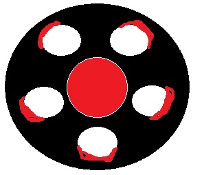

Here's a shot in the dark... Any of you know of a car with a 5x114.3 bp and 65.1mm hub? I'm looking for a spare tire. Since mine is literally nothing more than dead weight now lol
If the Genesis spare is that size, that'd work. If you want piece of mind, you could get the Genesis rim and zip tie a 65.1-67.1 hubcentric spacer to the Genesis spare in case you ever mount it. Or just get any 5x114.3 spare with a larger center bore than 65.1 and buy the appropriate ring and keep the ring with the spare. Of course there is the issue of clearing Brembos.
The NA SS steelies fit but they're hard to find. If you can find a single that'd work. Only problem is it doesn't fit in the temporary spare hole.
You could always file the outter edge of the bolt holes on your current spare out a little. The center bore of the spare is gonna fit snug against your hub anyway so the wheel will not be off center. As long as you put the lugs on snug, you'll be fine temporarily. Like this:

Ill probably just snag one off of an intrepid/cirrus/crown Vic or something like that and make a ring to keep with it. Not that big of a deal.
