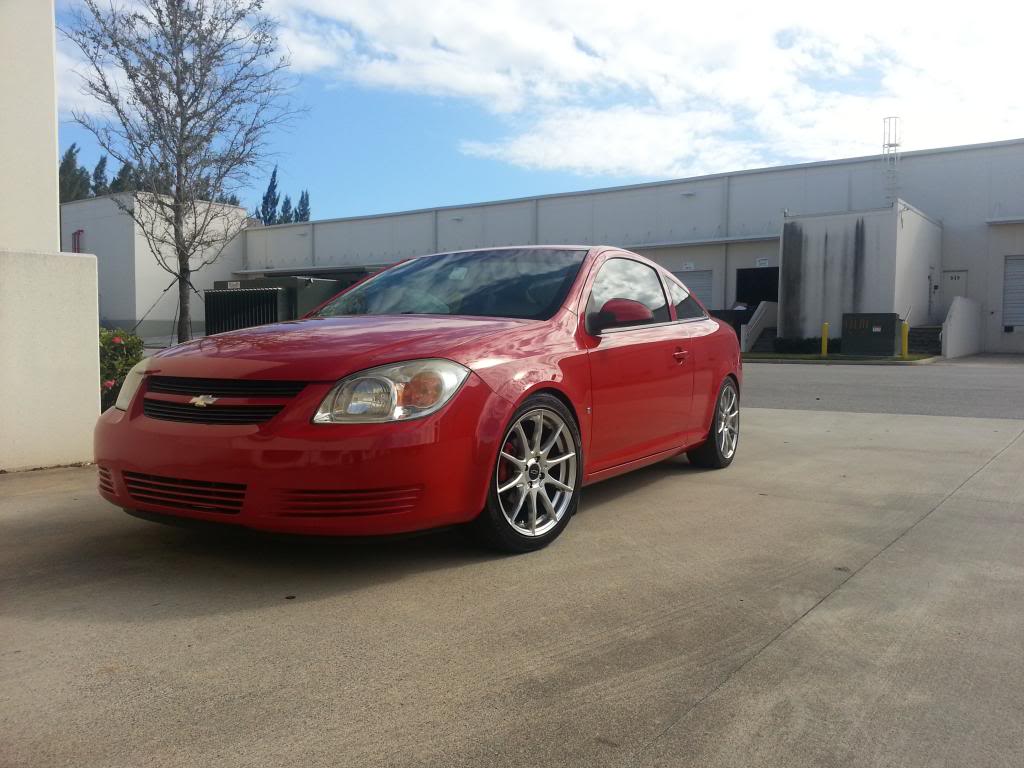

Old Dec 4, 2012 | 02:10 PM
Mr.Tozzi's Avatar
Joined: 11-02-08
Posts: 527
From: Coral springs, FL
This is what mine looks like. 215/45/17 on a 7" wheel
