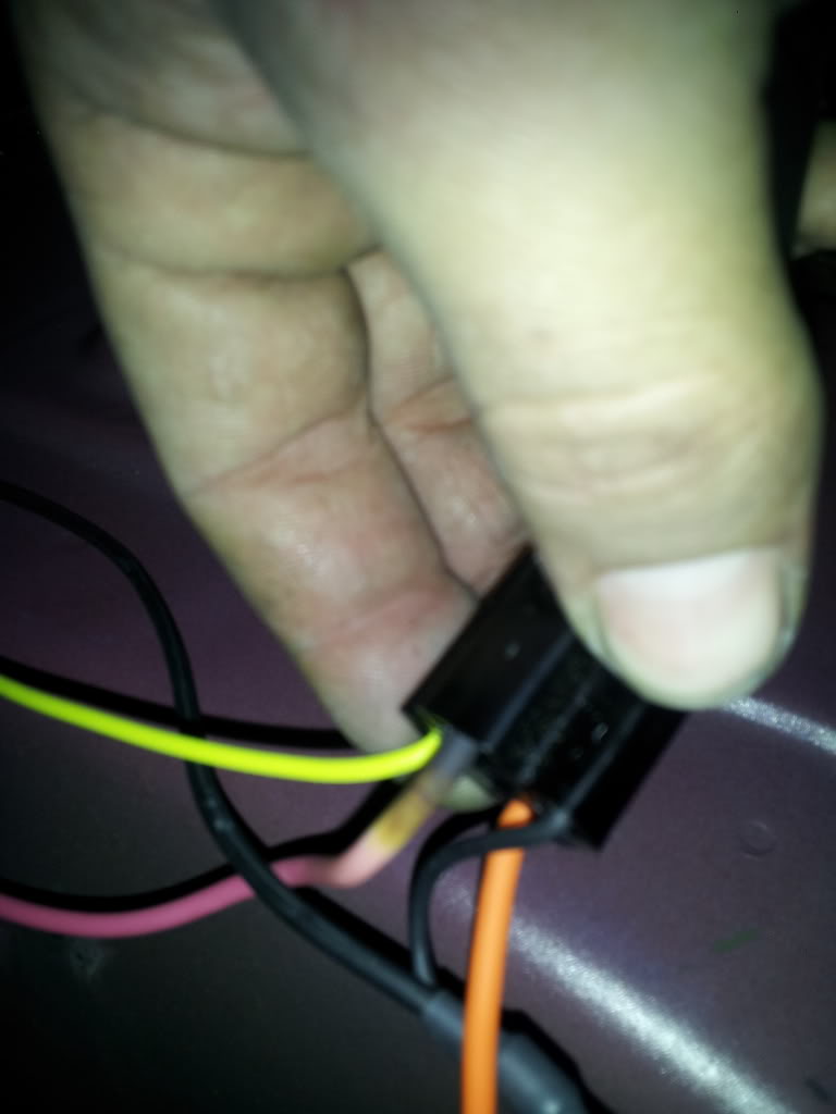

I'm not here to bash anybody about anything I'm just here to shed some light on what I found. I got stuck about 100 miles away from my house because of this. I've been using this kit for about 6 months now so I know it was not something that I did wrong during install.

What's weird is the relay got hot but the wiring does not.
I did a little looking around and found that there is a momentary relay and a constant relay.
Momentary relay meaning nitrous control or something that is used for a very short amount of time.
Constant relay well that explains itself it is meant to run constantly like a fuel pump.
And the way they explained the momentary relate failure was exactly like this 1 it would end up melting under a small load before it pops the fuse.

right but theres a good chance that that 40a relay wasnt actually a 40a relay. audiopipe is a shitty brand meant to run car stereo equipment. im sure whoever made the fuel pump kit just looked into the cheapest realy they could find and would never pop it open to even attempt to see if it was actually a 40a relay. I just wanted you to check becasue if it was a 10a or whatever relay in all actuality then you could spend the 5 bucks or whatever on a new relay and that would probably be the end of it assuming those wires arent fucked now
