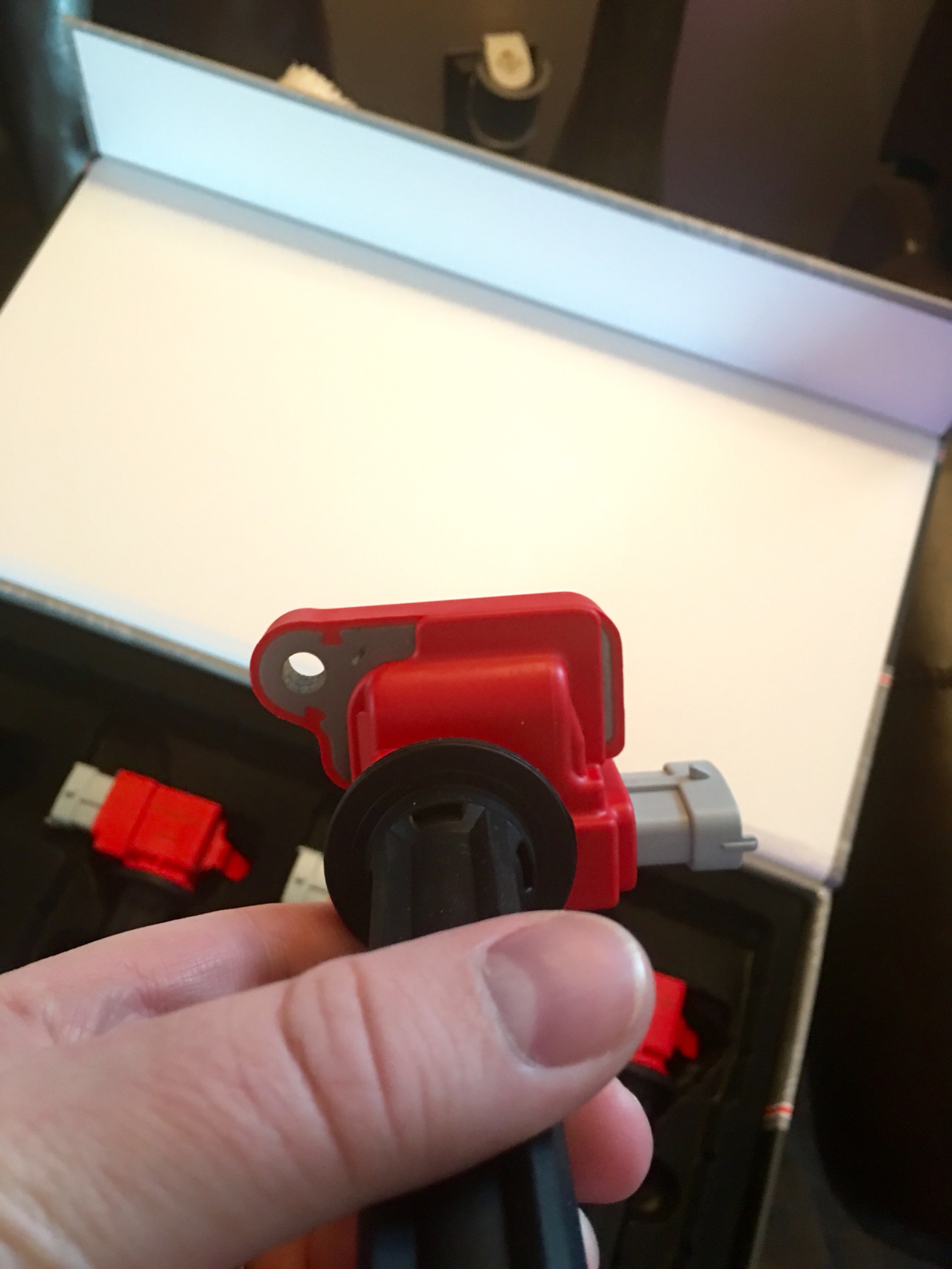

Hey guys my new ZZP high voltage coil packs just arrived ! I'm so stocked to install them. The packaging is awesome. They came in a nice box, let's just hope they perform as good as they look!

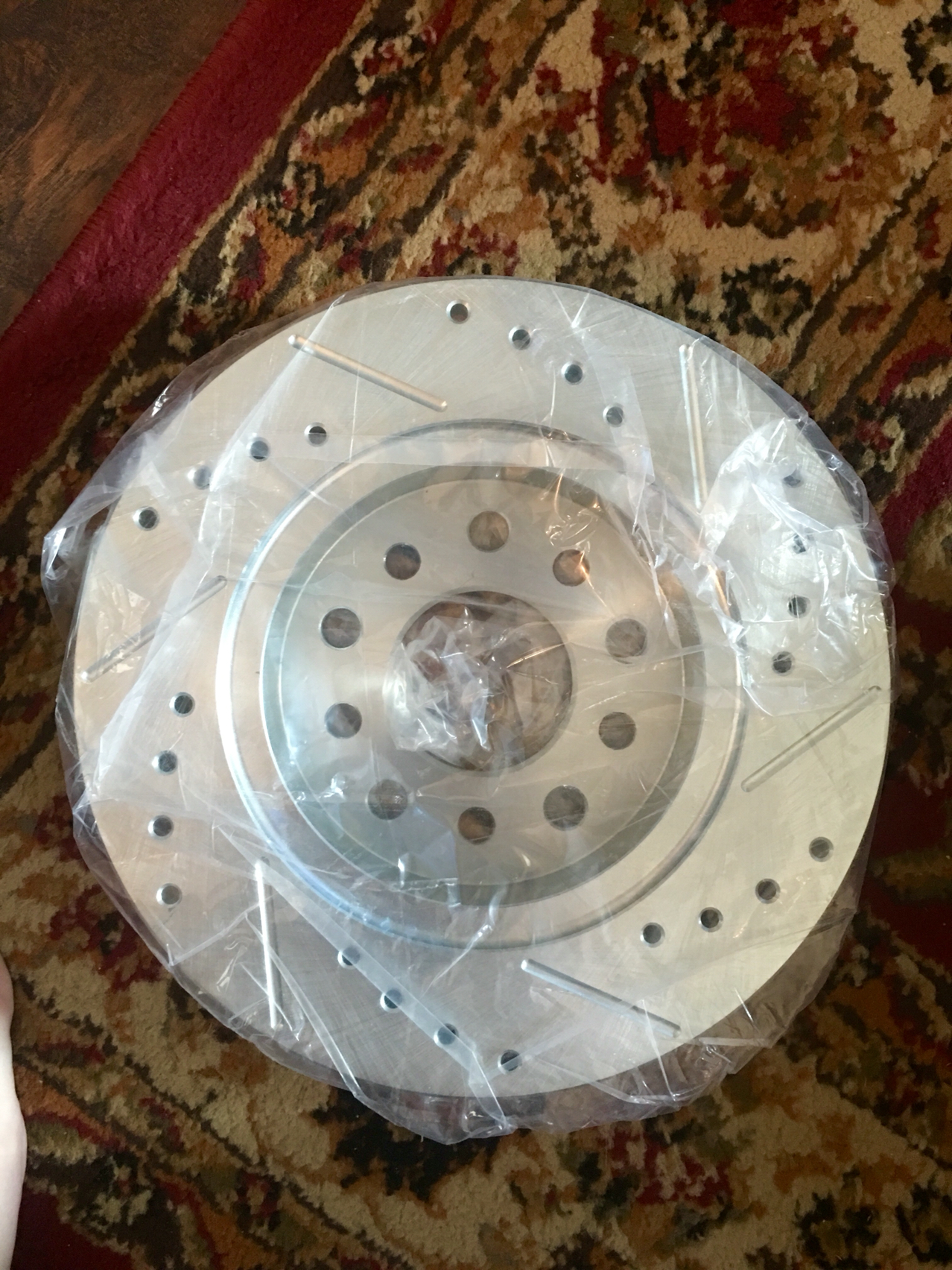

Picked up a new set of drilled & slotted rotors for the rear while I was @ it!photo921.jpg

They perform great, but u need to understand what they do.
They will allow u the ability to run a larger spark plug gap w/o spark blowout at high rpm. A larger gap provides a more efficient burn of the airfuel mix.
Don't expect to gain horsepower. They will give u the ability to make more power efficiently as u add more mods.

Hey staged what gap do you recommend running with these coil packs ? The plugs that I just picked up come pre gapped at .033

I ran a 0.036" gap on my 300whp LSJ. No spark blowout reving to 7750 rpm tested on a 38 degree day.
You should be good with a gap of 0.036-0.039 for you car.

i have the ZZPcoil packs for LSJ , only issue i had is 2 of them was hard to get the electrical plug on, i run a .040 gap with no issue at all with a 2.8 pulley plus they look great
