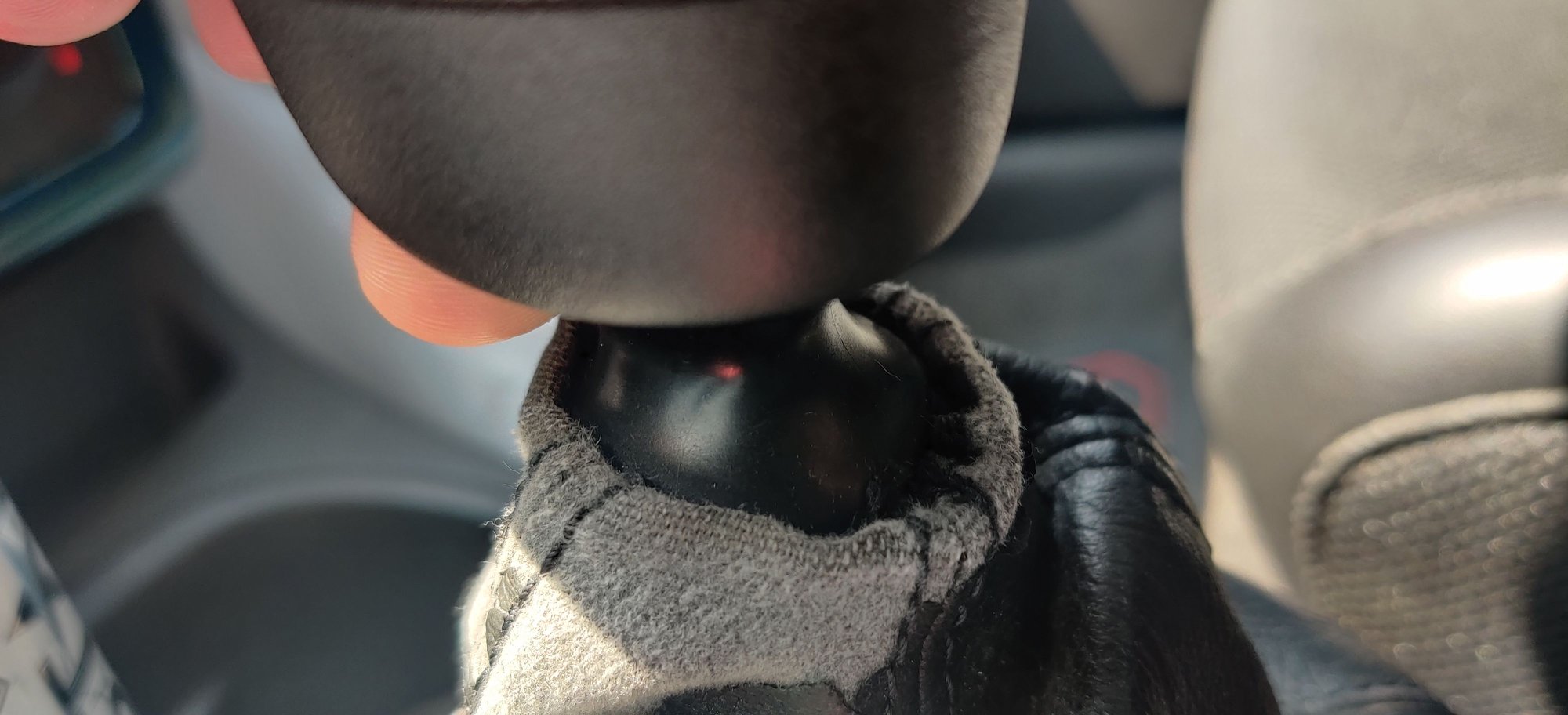

Reverse ring not engaged.
Reverse ring engaged. You pull up.

If the car was swapped to an F23 transmission, you won't have a reverse lock-out anymore (I doubt this is the case, but anything is possible). The lock-out can be deleted from the F35 shifter, but it's a little bit of a hassle that most people find not to be worth it.

Yea mine doesn’t have that ring the shift knob isn’t stock either so I was just wondering why my shift pattern was a bit different and possible reasons that it is
Post a picture. Pull your cupholders out, as well (pull up on the back portion, should pop right out)... and take a picture of the shifter cables connection to the black shifter base.
