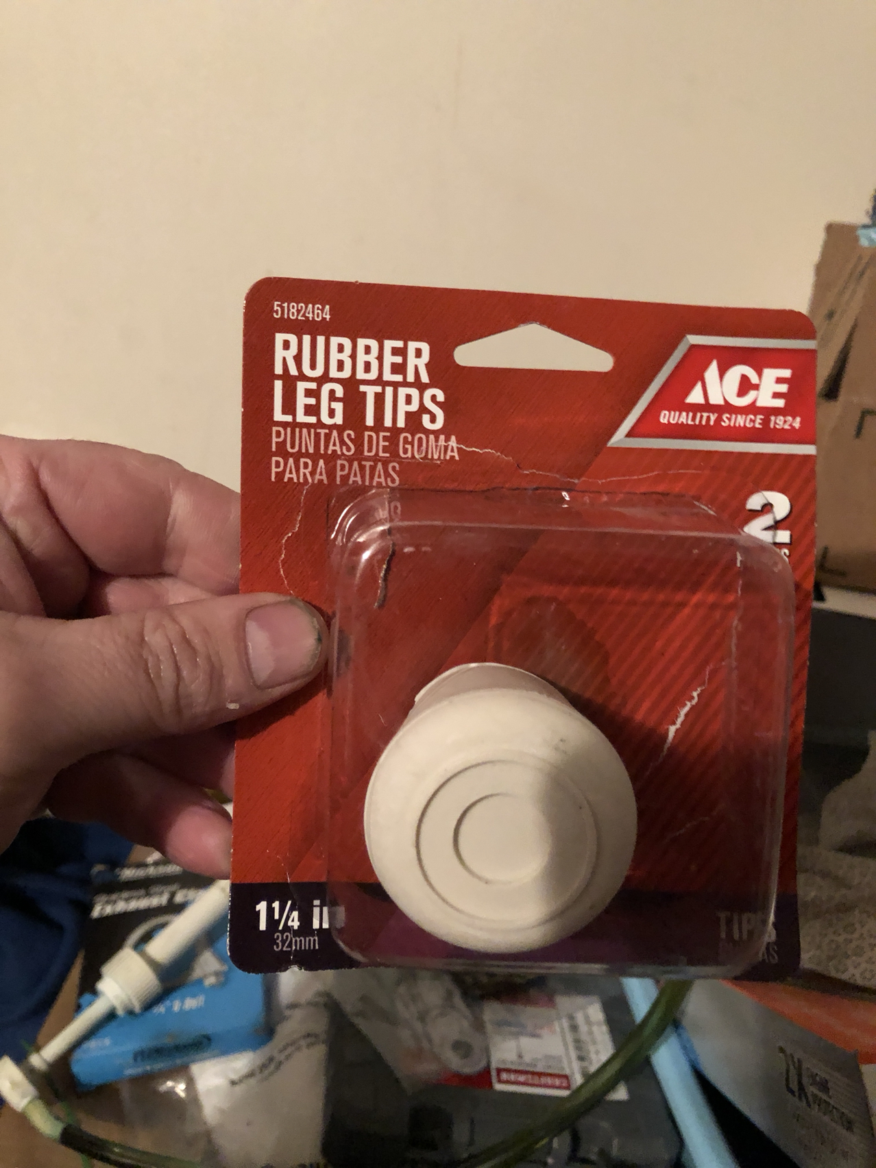

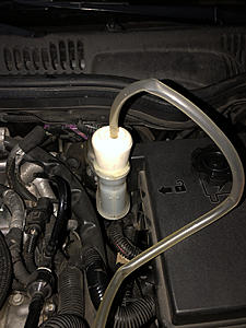

Or instead of using a plus stopper thingy you can use a appliance leg/furniture pad thingy and drill a hole in it to insert into the brake reservoir. I hope you pre-filled the tob it helps.

Like these
Old Jan 2, 2019 | 06:39 PM
Like these
Haha that's awesome I'll probably get one of those
