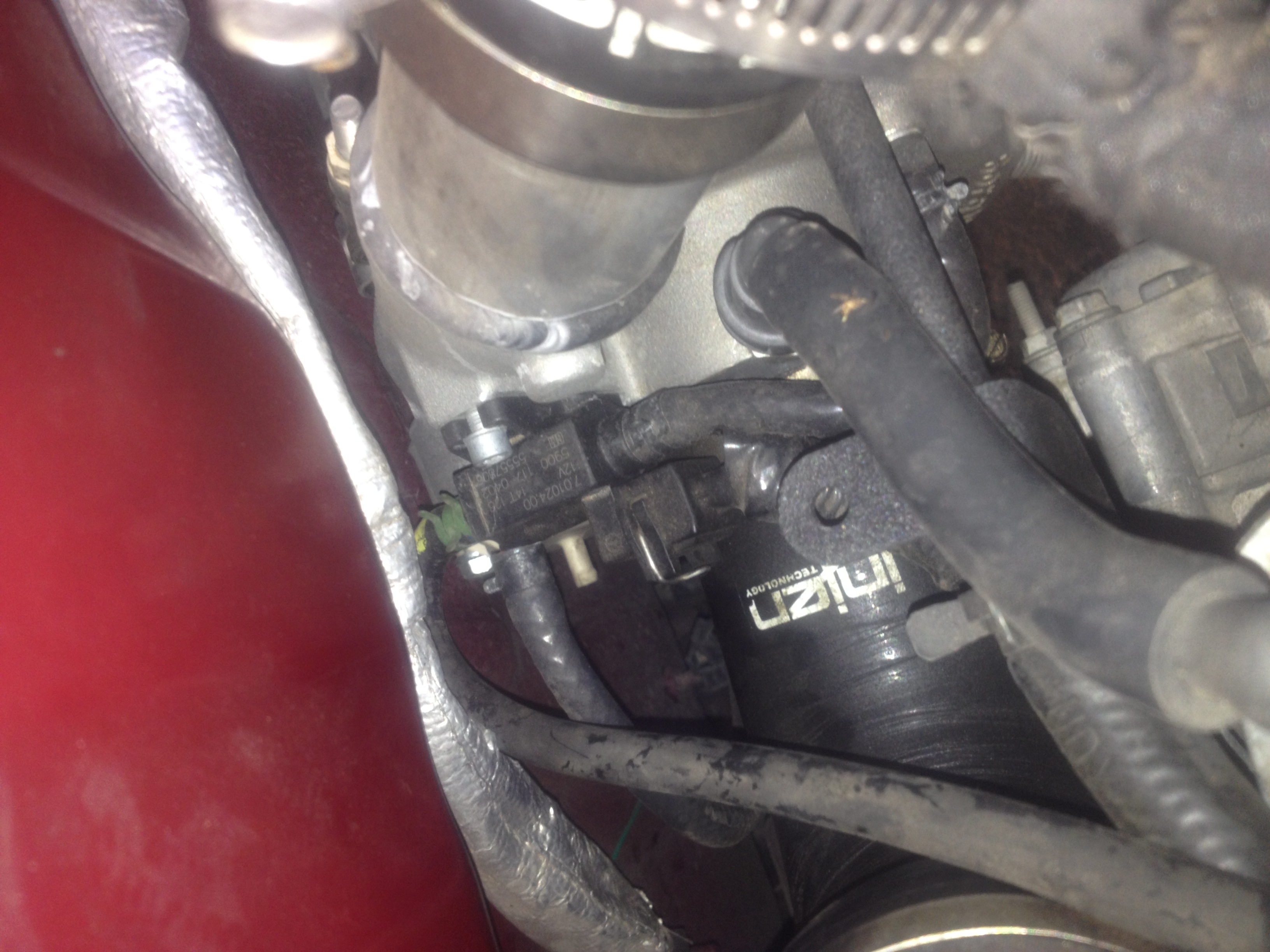

Okay i am pretty sure i found the boost leak. There is no vacuum line going to the by pass valve on the turbo. The only problem is i cannot find a vacuum line that isn't connected to anything. Am i suppose to tap into another line in order to run it to my bpv? Here are some pictures and it would be nice if someone could tell me which vacuum line is suppose to go to the bpv. thank you.
