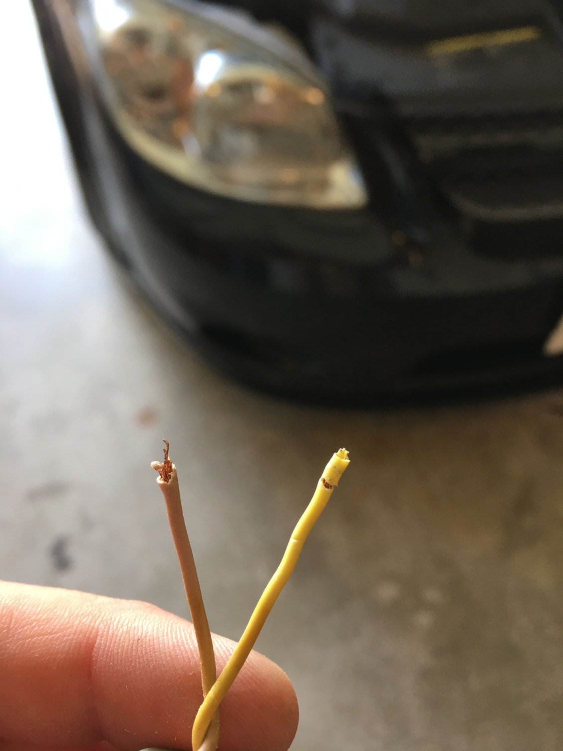

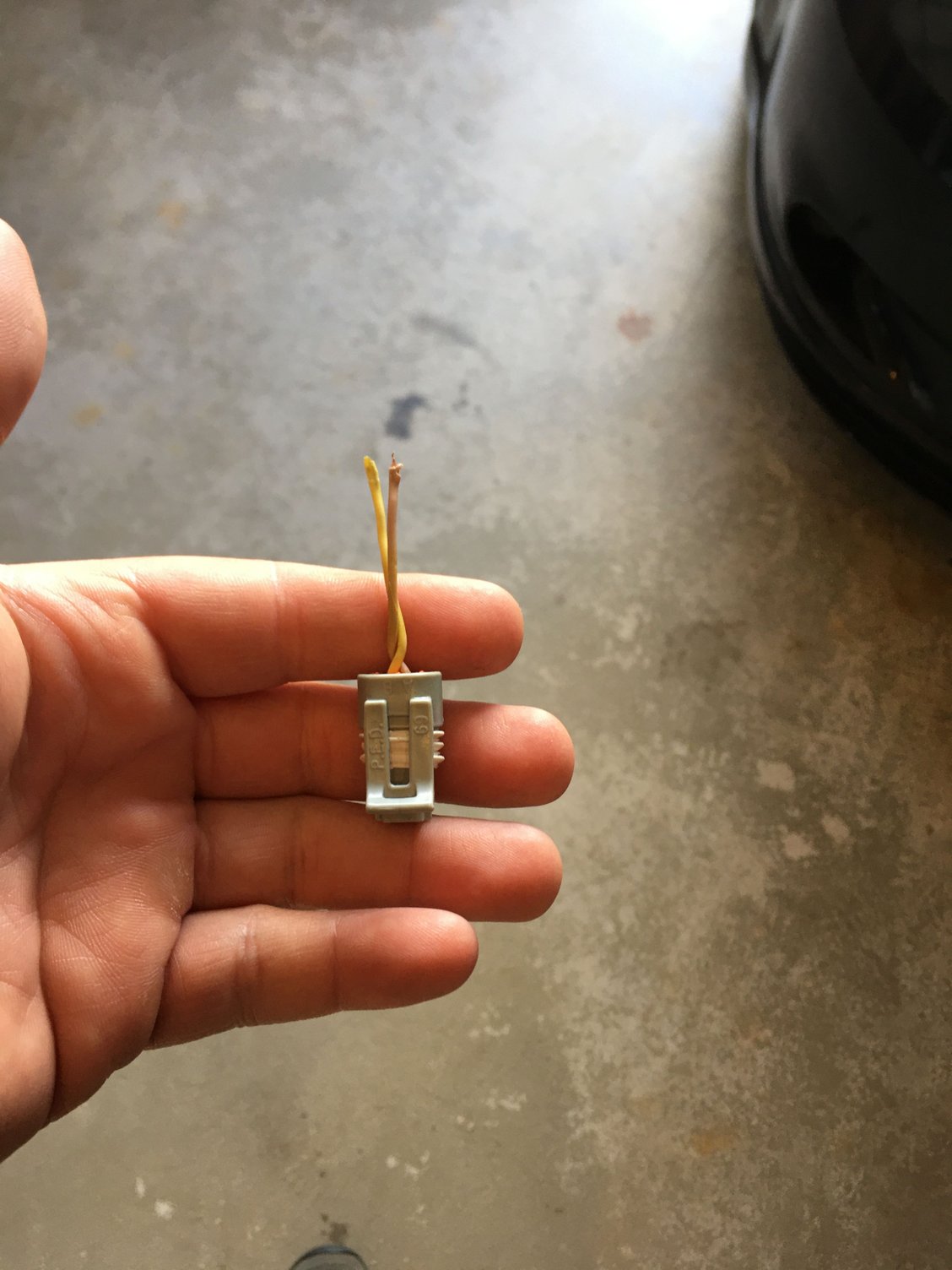

Hey guys, my car threw a p0118 code on me with the typical symptoms. I went ahead and bought a thermostat and ect sensor. I replaced the thermostat and when i went to unplug the wires to the sensor, it appears something chewed through the wires. So the wires and sensor have been severed. I'm hopping on here in hopes anyone has any bright ideas as to what i should do now. I thought about trying to splice into the wires and just adding more but wasn't sure if that's a good idea to begin with and i have hardly any clearance to get in there. I have big forearms and really struggled getting anything done in there. Ill attach a pic of the sensor plug, but I cant really get an accurate pic of the wires connected to the harness. Any help would be greatly appreciated

You can add more wire but use only as much as necessary and as long as its not a thinner gauge wire. Soldering is my personal preference over using butt splices but they probably make weatherproof splices if you can find them.
Soldering Procedure: (How I normally do it)
Slip some heat shrink tubing onto the wire and move a few inches away from the joint, you don't want the heat from soldering to accidentally shrink the tubing. Twist the wires together "inline" then clean the wire with flux and solder the wires together, keep the joint thin enough for the heat shrink tubing to slip back over. You can either use liquid black tape, epoxy or dielectric grease to coat the exposed wire in the joint. Move the heat shrink tubing over the coated joint before the coating cures (if using epoxy/liquid tape), shrink the tubing with a lighter or the soldering iron. Let the joint cure (if using epoxy/ liquid tape) then wrap the joint tightly with electrical tape and that should be it. Covering/coating the wires and joint are crucial to ensure that the wire doesn't corrode as capillary action will draw water into the wire causing corrosion over time.
