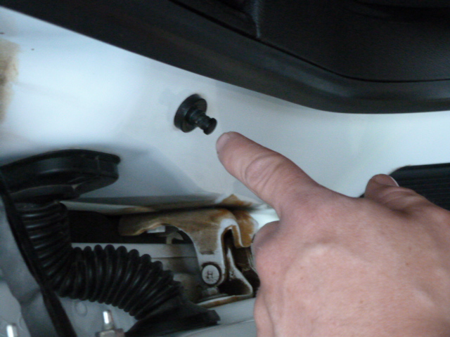

this is the sensor your talking about rite? and the radio wont go off if I open the passenger door either.

Old May 19, 2013 | 05:42 PM
iameric's Avatar
Joined: 07-20-12
Posts: 10
From: windsor, On
yes thats the one you need to replace, and the passenger door does not ''break the seal'' for the radio lol just the drivers side

yep, tested that on my buddys yesterday
thanks

thanks guys all fixed, $6 at the dealer
