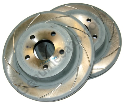

GenuineSaab.com, slotted front rotors - $280/Pair

GenuineSaab.com rear slotted rotors (machined in house from genuine GM rotors) $182/pair
R1 SLOTTED rear rotors! $185/pair - r1concepts.com steven@r1concepts.com - currently not listed on their page but if you call or email they can get em to you!
The rear rotors for a 2003 saab 9-3 DO NOT FIT. The measurements are the same, and they use the same pads, but they do not work.

Originally Posted by Jbernal4368
I am just wondering who sells really good high performance pads, and some slotted/drilled rotors for these cars... I would like to purchase some in the near future.
Read the original post, toward the bottom. Hawk has an entire line of performance pads, and genuinesaab.com carries machined (slotted) stock rotors, front and rear. I cant vouch for this company, but they do carry a (currently) unique part.
http://www.genuinesaab.com/catalog/p...roducts_id=692
R1 now has the rear slotted rotors, but you need to call
