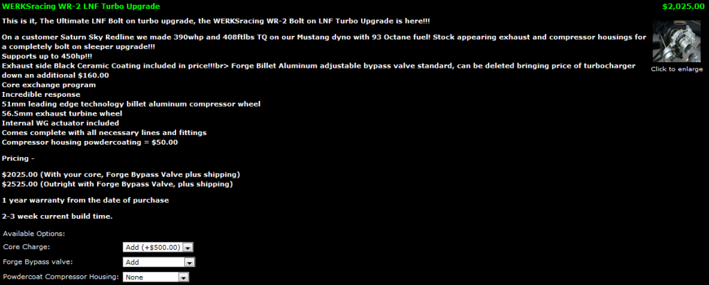

Turbo:
Other Items I will be getting are:
--Trifecta Tune/HP Tuner...not sure yet
--ZZP LNF Upper Intercooler Pipe
--KY Clutch with TOB
--DVC-30 Stage 2 Meth Injection
--2.25 Gallon Sumped Tank
So please help me out here, not really sure what else I need, or even if this is a good set up!

when it comes to clutch -
need rear main seal, axle seals, clutch pipe, flywheel, flywheel bolts, transmission fluid, brake fluid.
as far as turbo swapping i'd say go with an s252.
if you want a bolt on solution then go with werks' new bolt on turbo.
shame the efr is going to take so long or i'd say that.
bnr has to be pushed to the limits for a little bit over 400 hp
keep in mind you'll need cams or a fifth injector for anything that puts out more power than the stock turbo when you're using e85.

Justin, you're probably going to have to add in a 5th injector if you're going for 400+ on e85. I think their 400 hp number is on 93, right? So with e85 you should be able to go even more. 430 hp maybe? I believe our injectors are nearly maxed on the stock turbo with e85.

Zzp sells a 5th injector kit, and from what I've read you have to tap into your intake manifold to add another stand alone injector. That injector will supply additional fuel as the throttle is increased. Pretty easy principle.
For your application, Zzp's fuel lobe cams might work as well. The cams are running a bigger lobe for the hpfp so it basically strokes the pump further to provide more fuel/higher pressure, but there is a point where the injection window just can't get any bigger due to the duty cycle of the injectors.
Idk if I'm getting all of this right, this is just from what I remember reading. There was a thread called "zzp 5th injector". The first few pages was a pretty good read.

Okay that Werks turbo...here is the results of it on a Kappa (RWD)...so the power would be SLIGHTLY higher on our cars due to less drive-train loss.
-390hp on 93 octane BASE TUNE. That was literally just a canned tune they tossed on it. Obviously more of a custom tune will yield better power.
-that was also only at like 21 psi i believe. Bumping that up a few PSI will net more power as well.
-Adding E85 (or more likely an Eblend) will again add more power.
-Meth Injection could also be a good option!
If you ask me, 400hp is VERY achievable with that turbo.

Im thinking im gonna go with the Werks for now, tuned for 24psi? run 93 oct, with meth injection till I get back to the states.
At that point I can then really start building it up more!
Old Aug 21, 2012 | 05:50 AM
FrossB's Avatar
Thread Killer
Joined: 10-19-09
Posts: 7,431
From: Gering, Nebraska
93 octane with meth inj at 24 should most def give you 400hp
