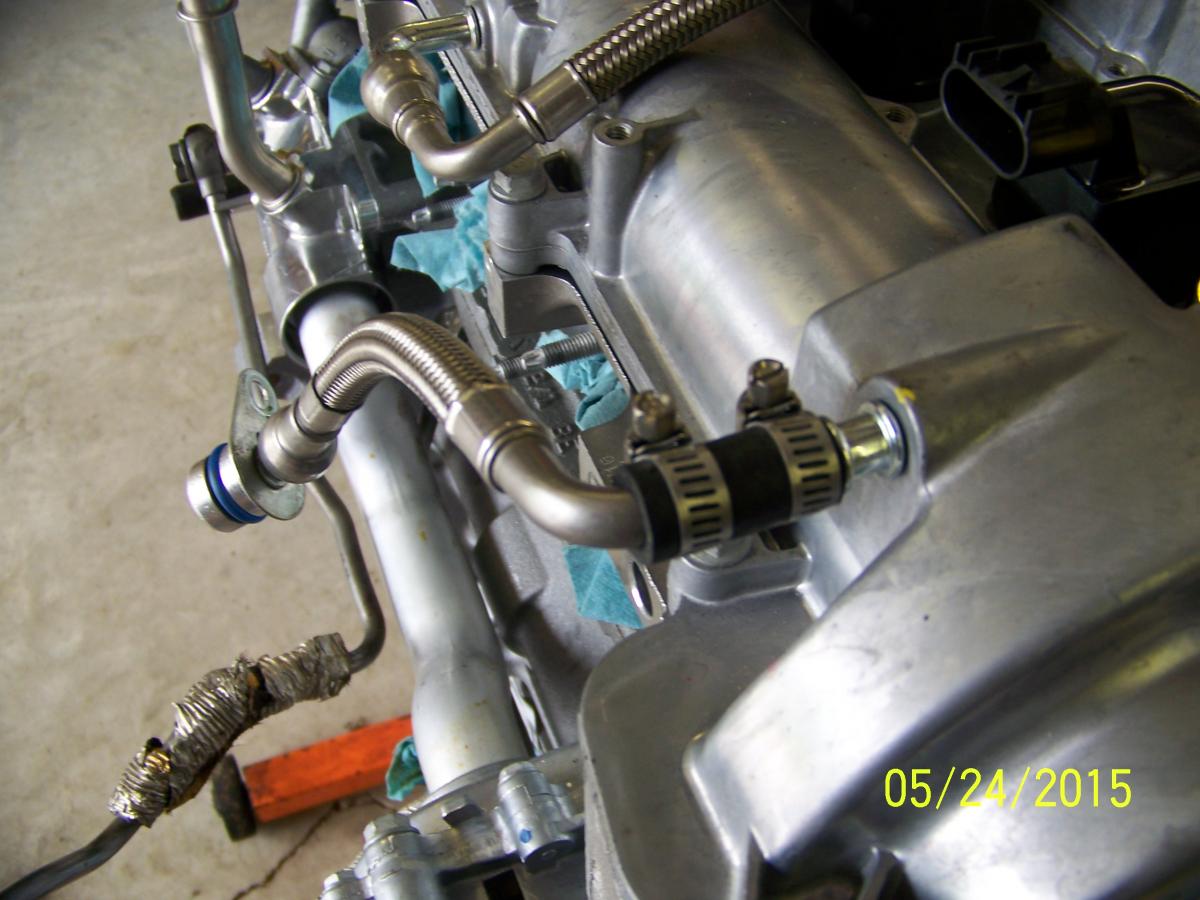

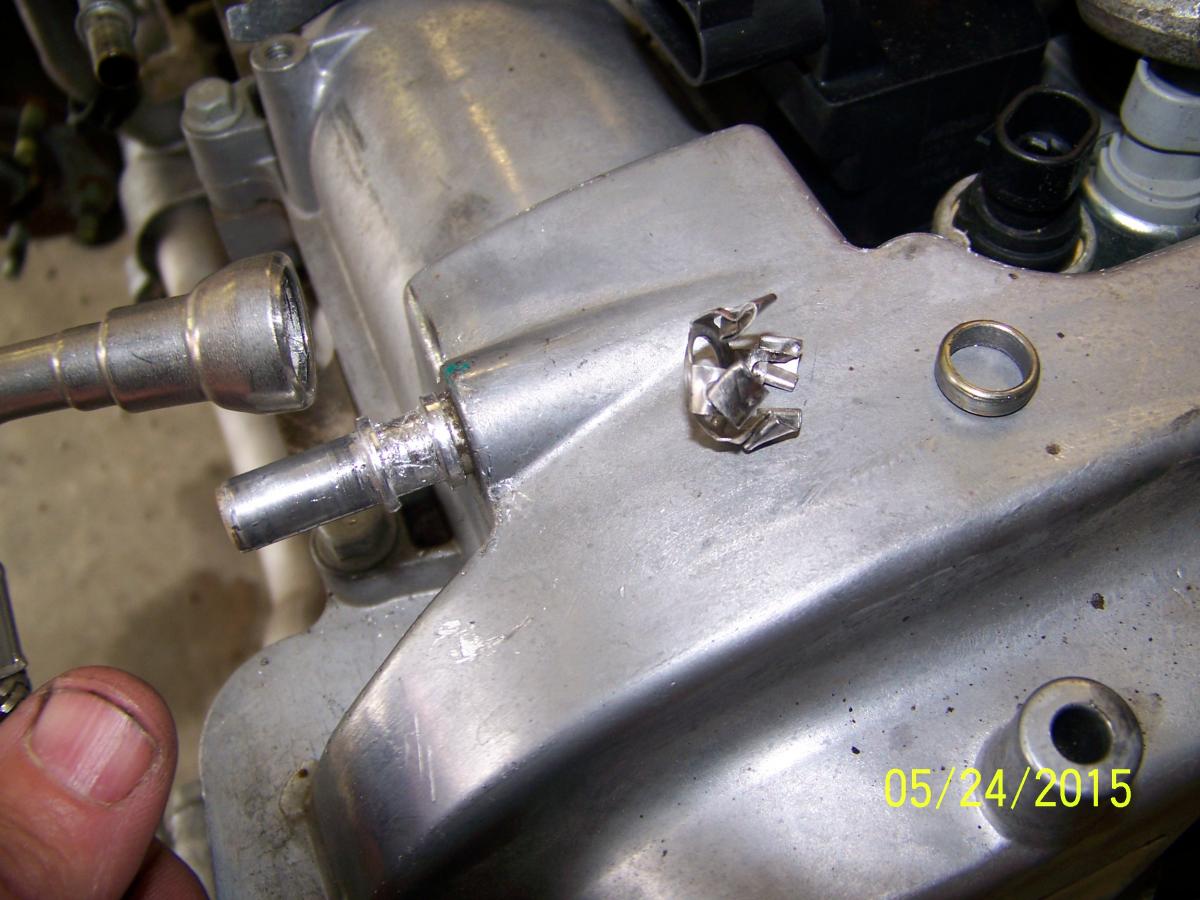

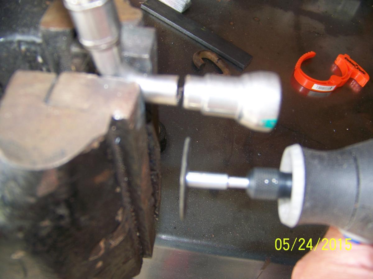

I tried the zip tie method to remove vent line from valve cover but it was going no where fast. This was my fix, not real sexy but I think it will work, the fitting coming out of the valve cover and the smaller diameter of the line are both 3/8 so I used some 3/8 fuel line. I just pried and twisted on the fitting till it came off.

Should be fine. I wouldn't have cut it, but you won't have a ton of pressure in there so I doubt it'll come off. If it ends up not working you can always get a new line.
