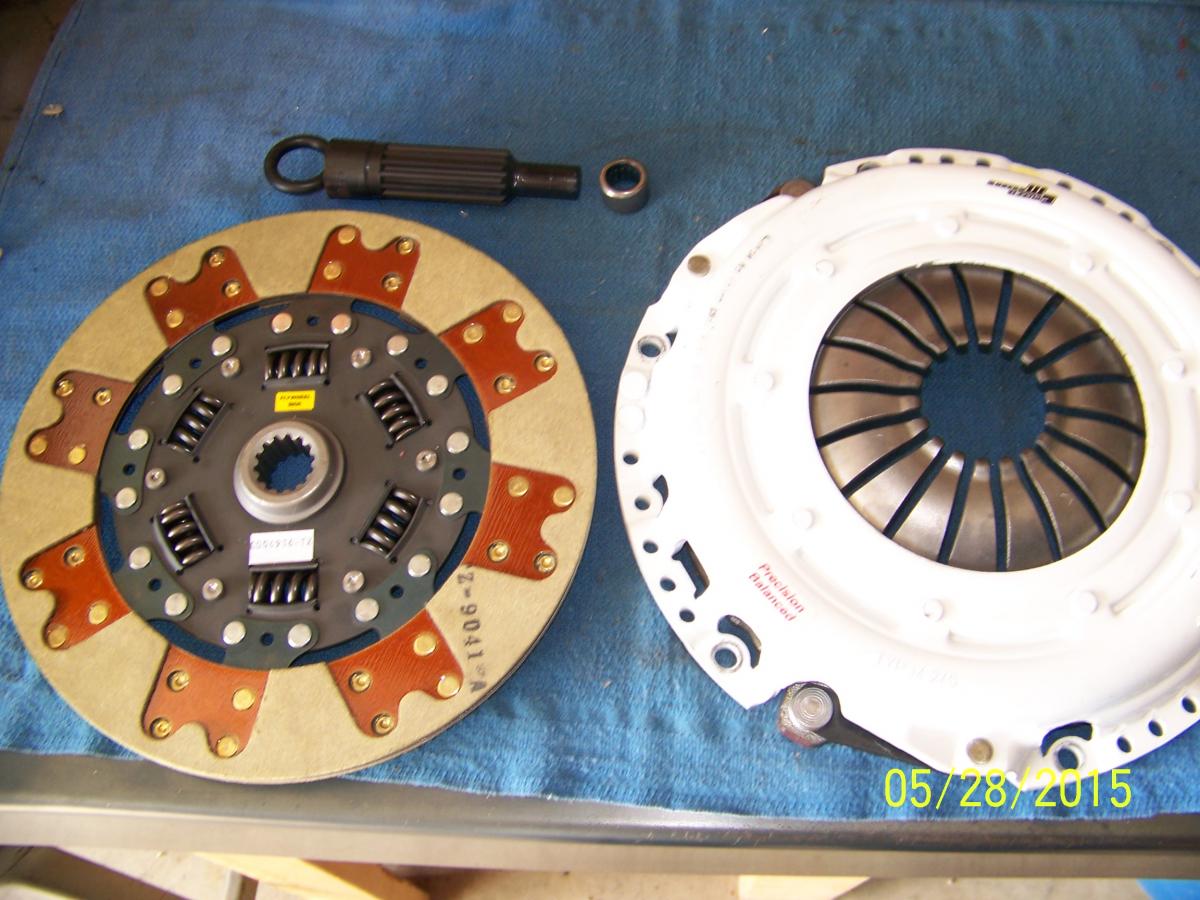

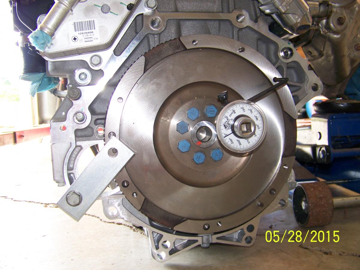

Got most everything bolted back on the engine, torx bolts on TOB were snug but came out with no problems(T30). UPS dropped clutch and flywheel bolts off 30 minutes ago and clutch kit came with an alignment tool and also looks like a pilot shaft bushing stuck on the end of the alignment tool, I think it may be just for alignment purposes only. Off work tomorrow so I will spend the day getting it back in.

My clutch didn't come with anything like that so as you've figured out you're fine.

That metal piece was clever. I used a breaker bar on the crack pulley bolt on the other side of the engine.
