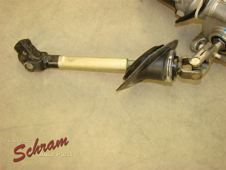

I bought a brand new 2010 Victory red Cobalt SS earlier this year. I had to drive all the way to Escondido CA to pick itup because it was one of the last SS coupes in the whole country.
I got it with 45 miles on the clock. Well, last week, a warning chine went off while I was driving, and "POWER STEERING" popped up in my display, at which point my car developed 1959 Peterbuilt /Frieghtliner big-rig steering.
It happened as I was driving down the freeway. Once I got off the freeway, and had to make slow left and right turns, I had to use my Vulcan death grip to get the freaking car around corners.
The odd thing? My car only has 5,500 miles on it. I'm not even due for my first oil change yet! (although I already changed it once).
So I get home and start researching this issue. Ok, there's a GM recall on the electric steering, but this is one of the last SS 'Balts built. Why didn't they do the recall WHILE IT WAS ON THE LOT?
I have read horror stories regarding the electric motor replacement by dealers. Many owners get there car back with more problems then when it went in......

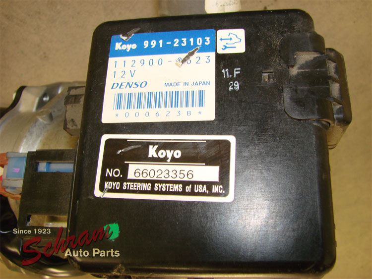

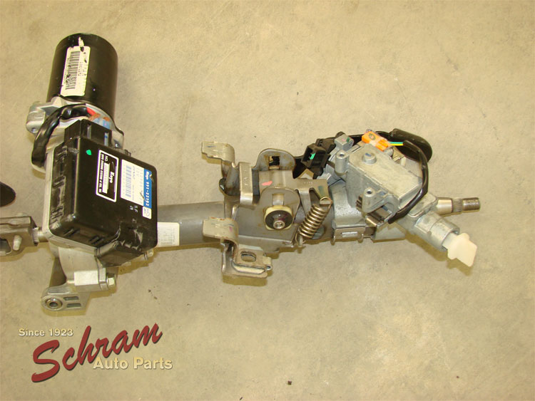

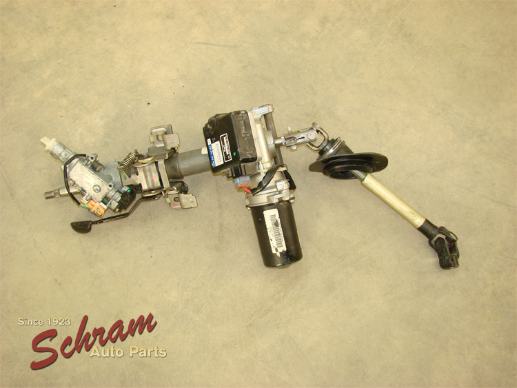

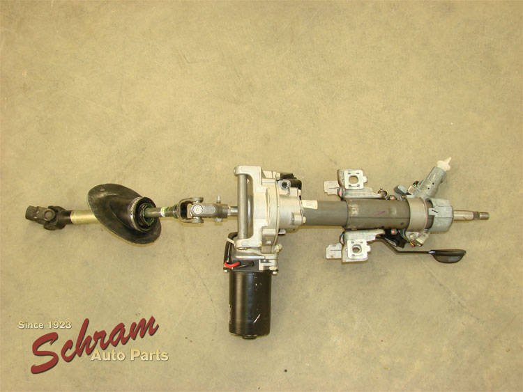

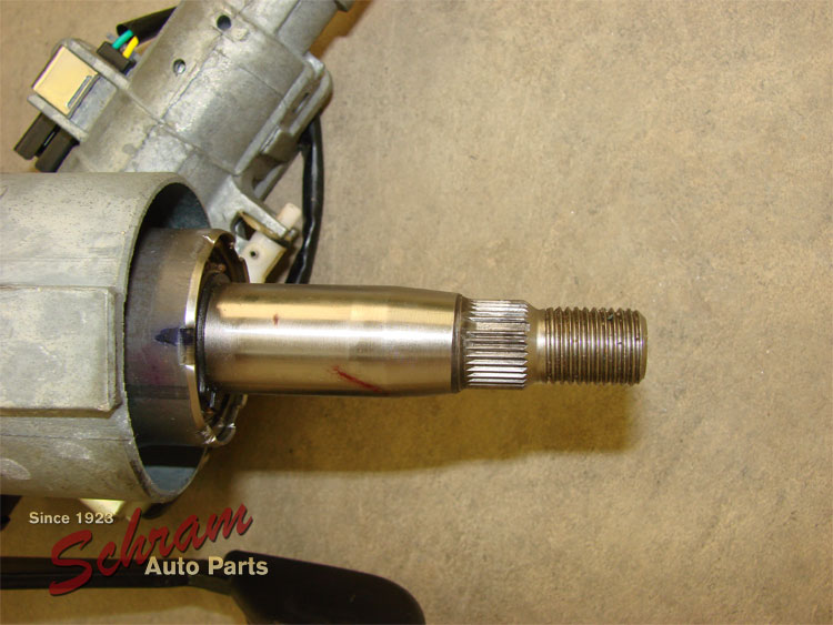

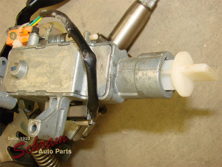

So I have decided to fix the damn thing myself. I am pulling the motor off and taking it apart. Oh, and guess what? The motor and controller and made in Japan by Koyo Denso Corp. They make the electric steering for the Toyota RAV4 and the Prius, along with most of the hybrids out there. The Chevy Malibu has the same steering unit, as does the Pontiac G5.
Please see pics below.....

The reason I don't want to let the dealer "fix" it is because they put the same damn motor back in. In other words, they replace a defective part with a defective part, and the dealer hopes that it will last until your warranty expires.
"that's just dumb".................ok...........you think it's dumb.
I bought a "used" motor from a wrecking yard and I will use that while I take my original motor apart. From my research, the problem lies in the brush pressure on the commutator. The springs get hot, and weaken. This causes the carbon brushes to not make a solid contact on the commutator, which then causes arcing, and carbon surface damage. That is why the motor fails. Is it a FAULTY design, but only for the GM product. The Toyota's and Honda's are not experiencing this problem.
I am going to replace the springs with tempered stainless springs with a higher pressure.
If this works, then I will recommend this fix to all.
Here is a link to the Koyo company. The maker of our electric steering: http://www.koyousa.com/DesktopDefault.aspx?tabid=550
Another link: http://www.ebearing.com/news2001/news400.htm Looks like most Saturn vehicles also use EPS (electric power steering)
