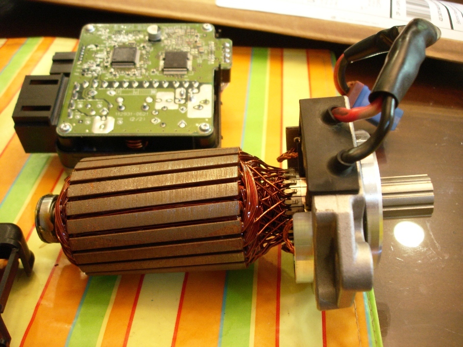

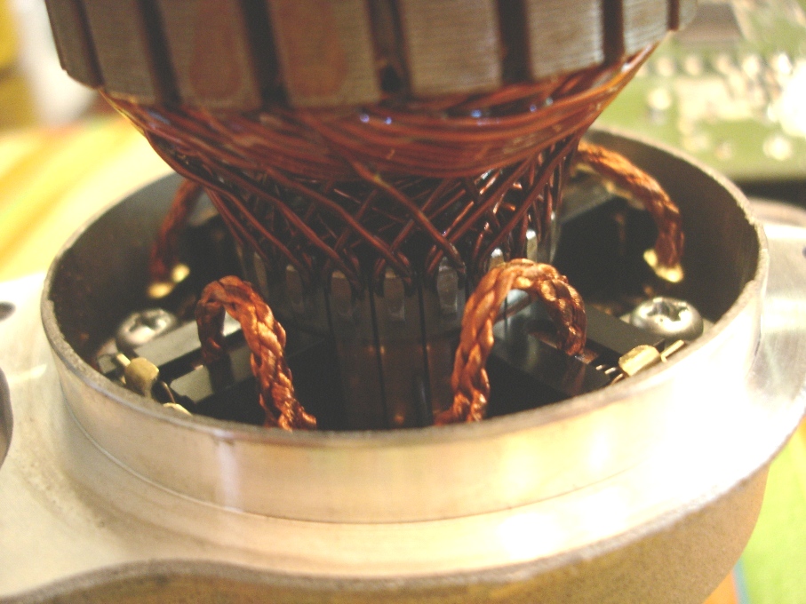

This is my temporary steering motor until I can get some stronger springs for the brushes. So this is a wrecking yard motor and controller that I took apart to get an idea as to the spring size. As you can see, this motor has four brushes. The spring tension against the brushes is very weak. I was really surprised as there should be more than 2.5 psi spring pressure. I would say that 5 psi would be optimum.
At least the spring tension is even; all the brushes has the same amount of wear.
I will rebuild the original motor as use this one as a spare. Hell, it only takes 5 minutes to replace.....

The Cobalt uses a "manual" steering rack with electric assist. When the electric assist stops working, not only do you now have "manual" steering, but you have to fight against the worm-gear transmission and the motor itself. Think of it as "double-manual" steering, so double the effort.
Well the used steering motor is in and I am back on the road!! Success! Works like a charm.
I am still researching if GM is now using a revised steering motor. Not too much info out there. If it is true that the HHR SS has a "stronger" motor, I would certainly like to see some documentation.
