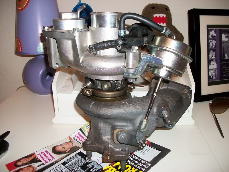

What is your vac reading at idle? It should be around 19-20. This sounds like a vac leak, but could also be that your wastegate is stuck open. Did you replace the turbo along with the motor? Check the wastegate controls, like the vac solenoid/connector and all related hoses. Check the wastegate rod and make sure it didn't come out of the arm, and make sure the lock nut is still tight. Vac test the wastegate actuator if you have a Mighty Vac Hand pump.

Pic of wastegate actuator, solenoid, hoses:

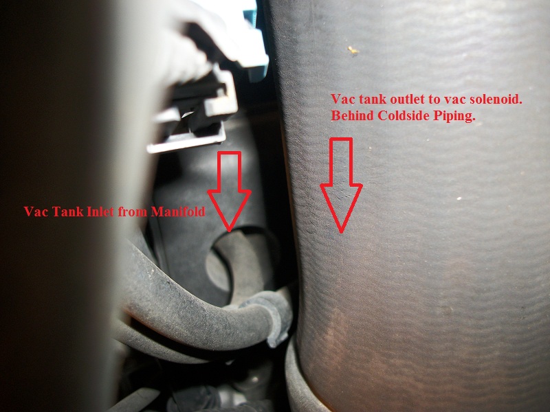

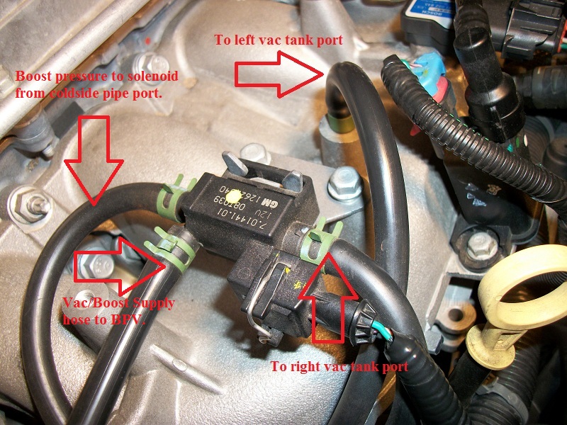

The vac tank is a good thing to check. It's under the intake manifold and is hard to get to, but you can see if better from underneath the car. You have the vac tank source tube coming from the center of the intake manifold and going to the vac tank source port on the left of the tank, when facing the front of the car. You also have a vac tank outlet tube going to the vac solenoid on the manifold. Basically, vac is supplied to the tank from that tube in the center of the manifold and is stored there until the vac solenoid opens and delivers vac to the BPV. When the solenoid is open the other way, it supplies boost pressure to the BPV, via the coldside piping tube. This holds the BPV closed when you're under boost.
The vac tanks have been known to crack. You can bypass it to test if your tank is leaking. When bypassed, if your car runs correctly, you know the tank is leaking.

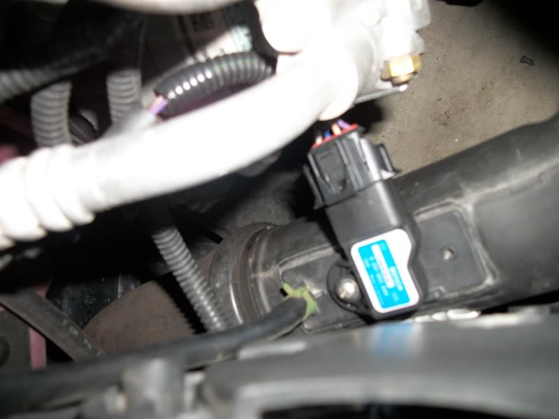

You can see the boost pressure supply tube next to the GMS1 MAP sensor.
