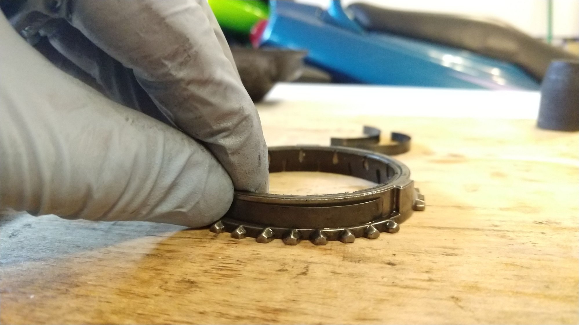

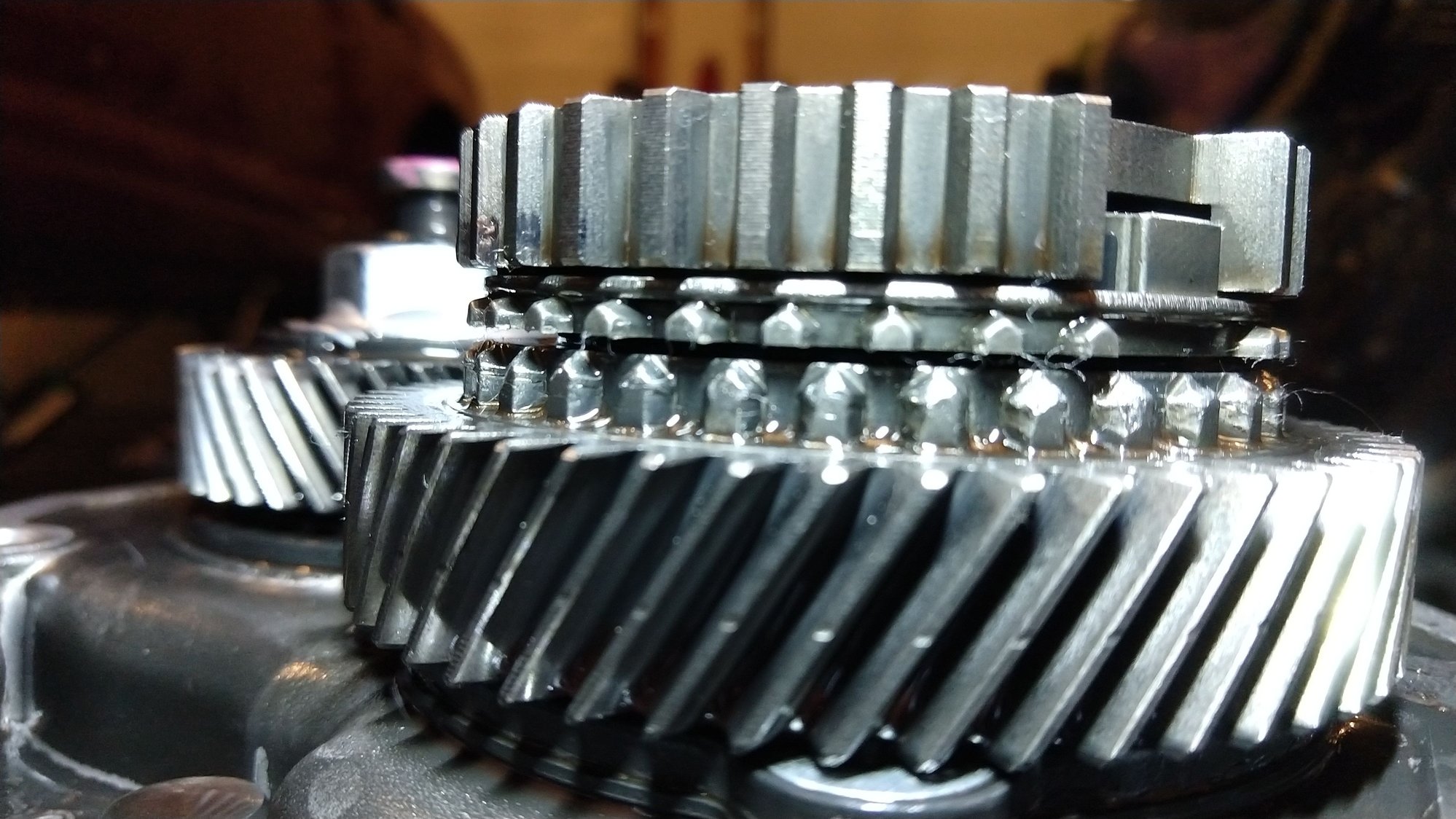

I have two F35s, one has a shredded 4th gear and the other won't stay in 5th gear. I'm planning on pulling the 5th gear syncros from one and transplanting them into the other. I still have to get a gear puller so I've only made it as far as pulling off the syncro ring. I was assuming I'd see some better visible evidence of damage on the dogteeth, I do see what looks like could be damage, but I'm not certain. This is the "good" one:
This is the "bad" one.

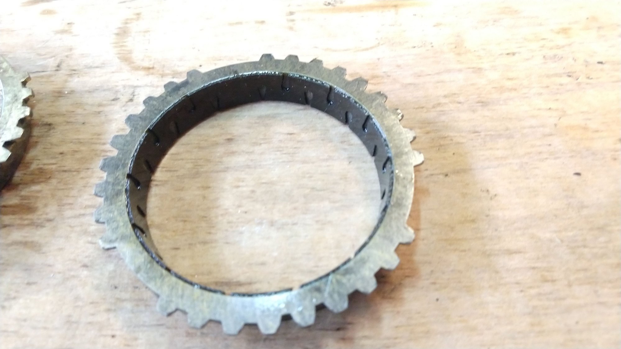

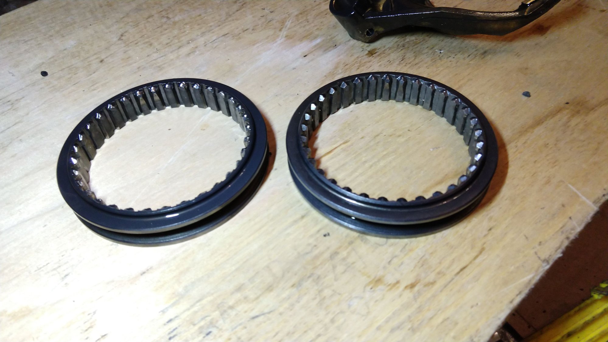

I do see some marks and what-not, it's hard to tell. It's also worth noting that the syncro rings don't seem to be interchangeable. Is this by design or is it because something is damaged? Here's the rings with the "bad" one on the left and "good" one on the right"
Once I get a gear puller I'll get both gear sets off for a closer look as well. Lastly, why does the one syncro set have a different colored ring? I'm assuming its made out of a different metal but why the difference between the transmissions?

Interesting that the "bad" one doesn't appear to have brass synchros. The other transmission that I've known to ditch the brass (VW/Audi's) have to use a DMF, otherwise the synchros will destroy themselves.

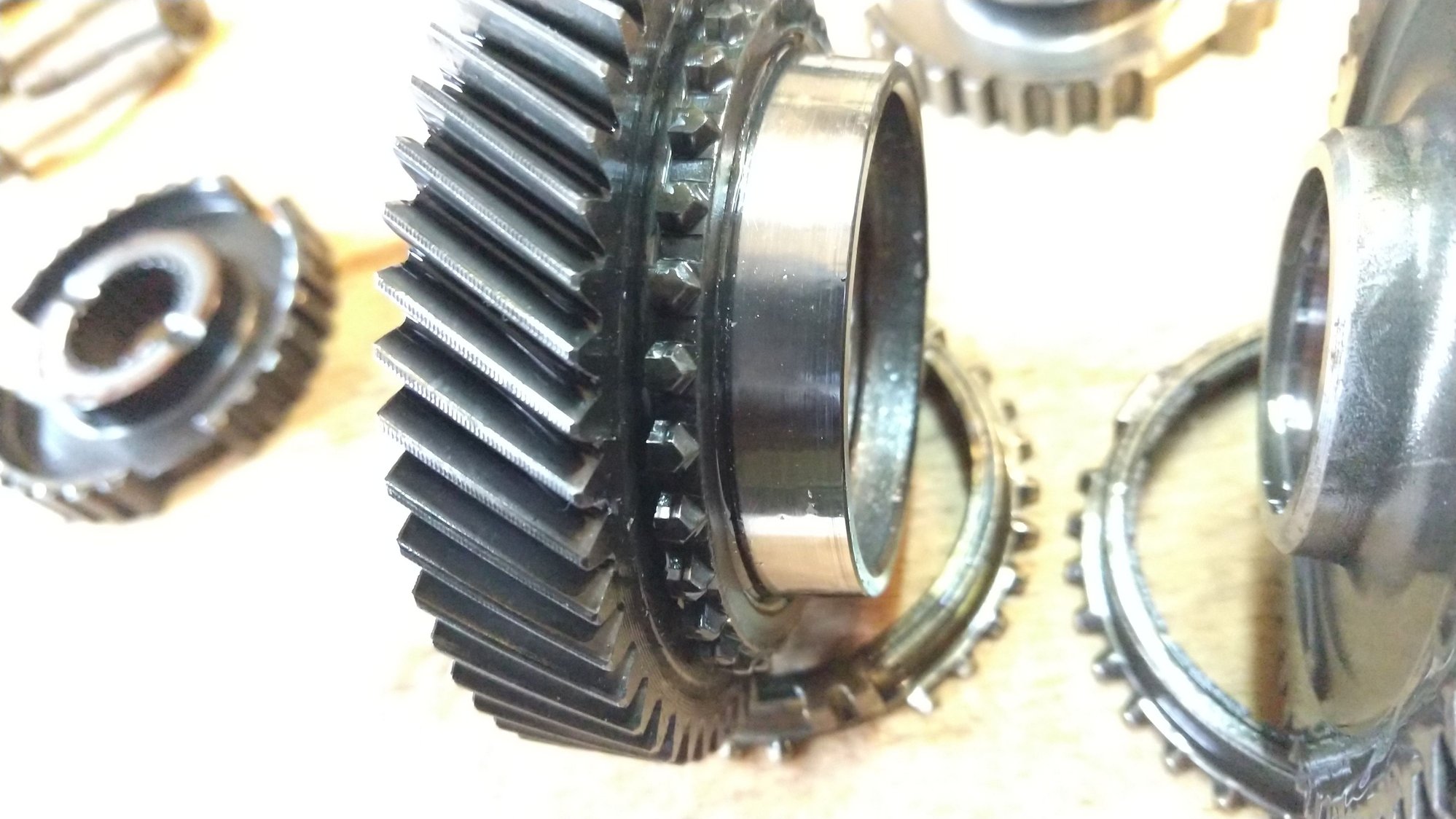

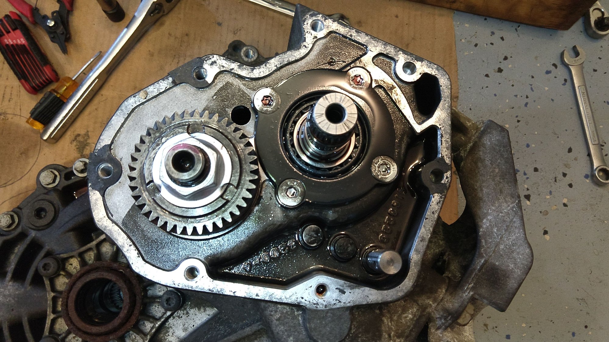

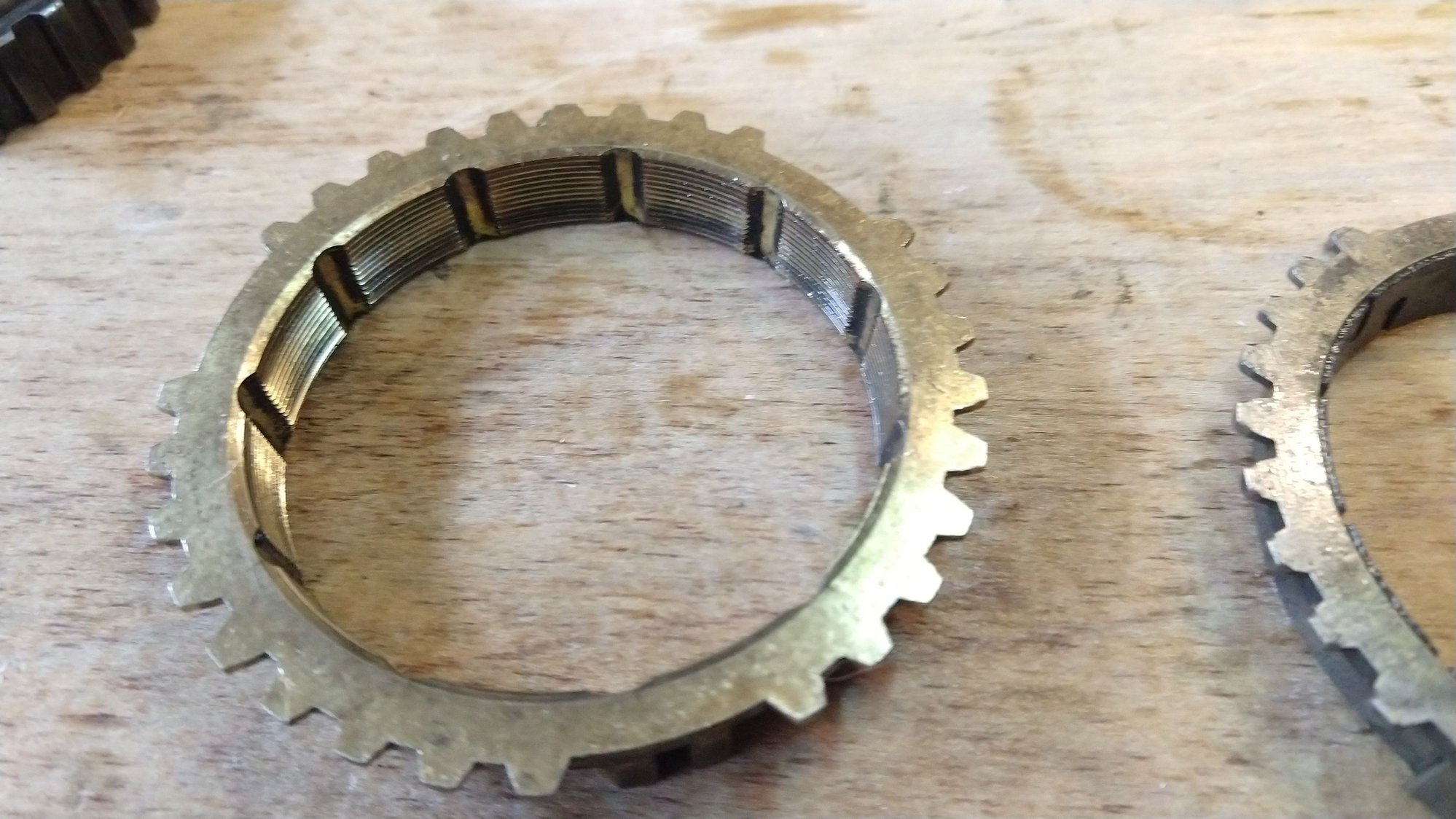

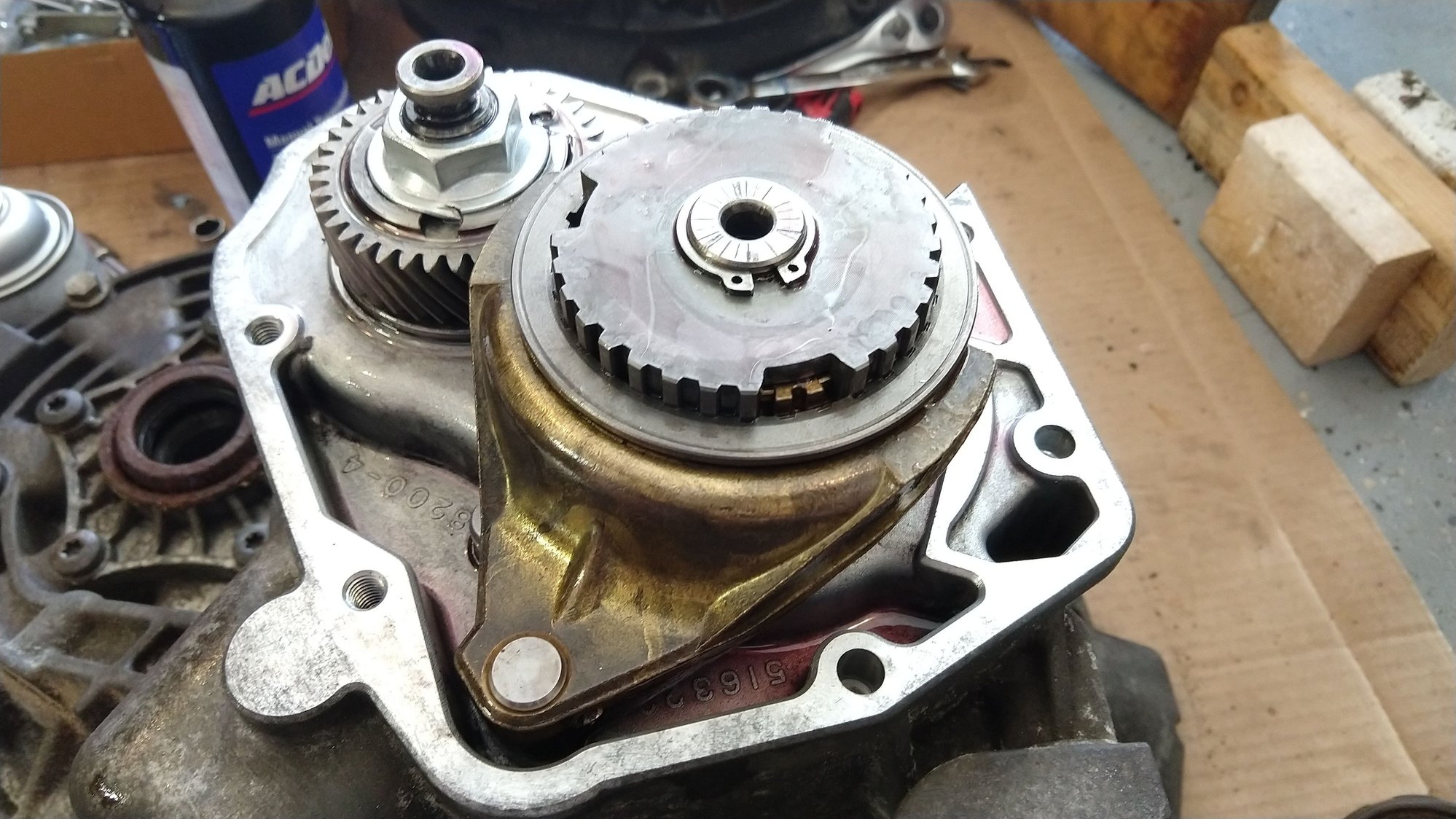

I really hope someone can help me with this. I've gotten 5th gear apart on both of my transmissions and there are variations between the two. They're definitely not interchangeable. What I was hoping to find out is *can* I install the 5th gear from one into the other safely. Here's the differences I found:
First, aside form the synchro rings being made out of two different materials, the synchro's themselves are different:

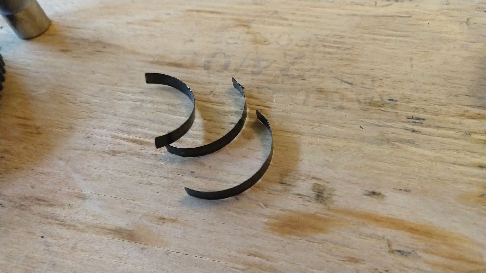

Next are these springs:
They were seated along the outside of the synchro ring. One transmission had them, the other did not.
Next the dog teeth gears on 5th gear are different lengths:

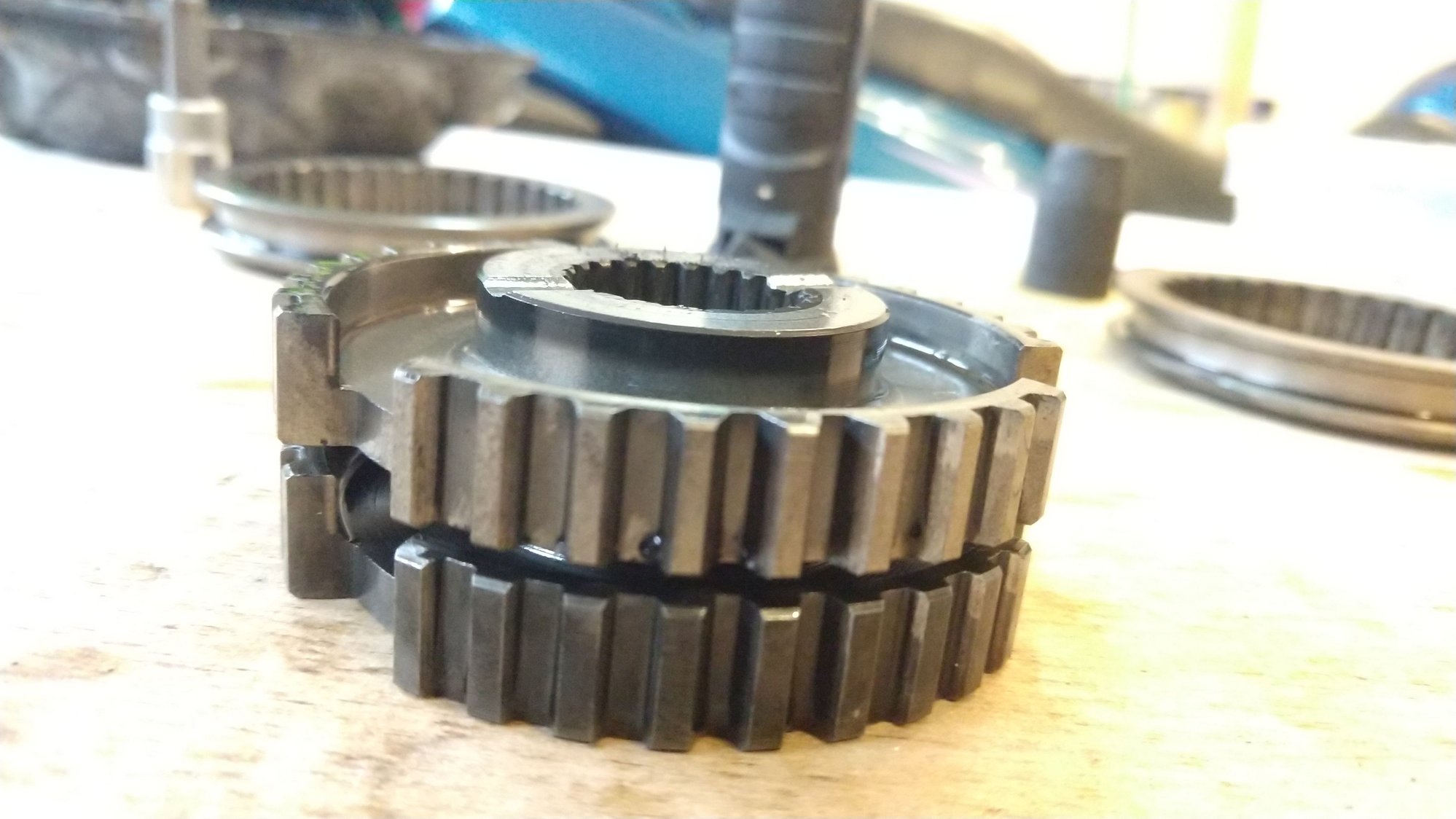

I'm also seeing the thickness of the teeth on the synchro sleeve and hub are different width, I haven't counted them as they seem the same but the shape is different enough that they don't mesh if you swap sleeves:

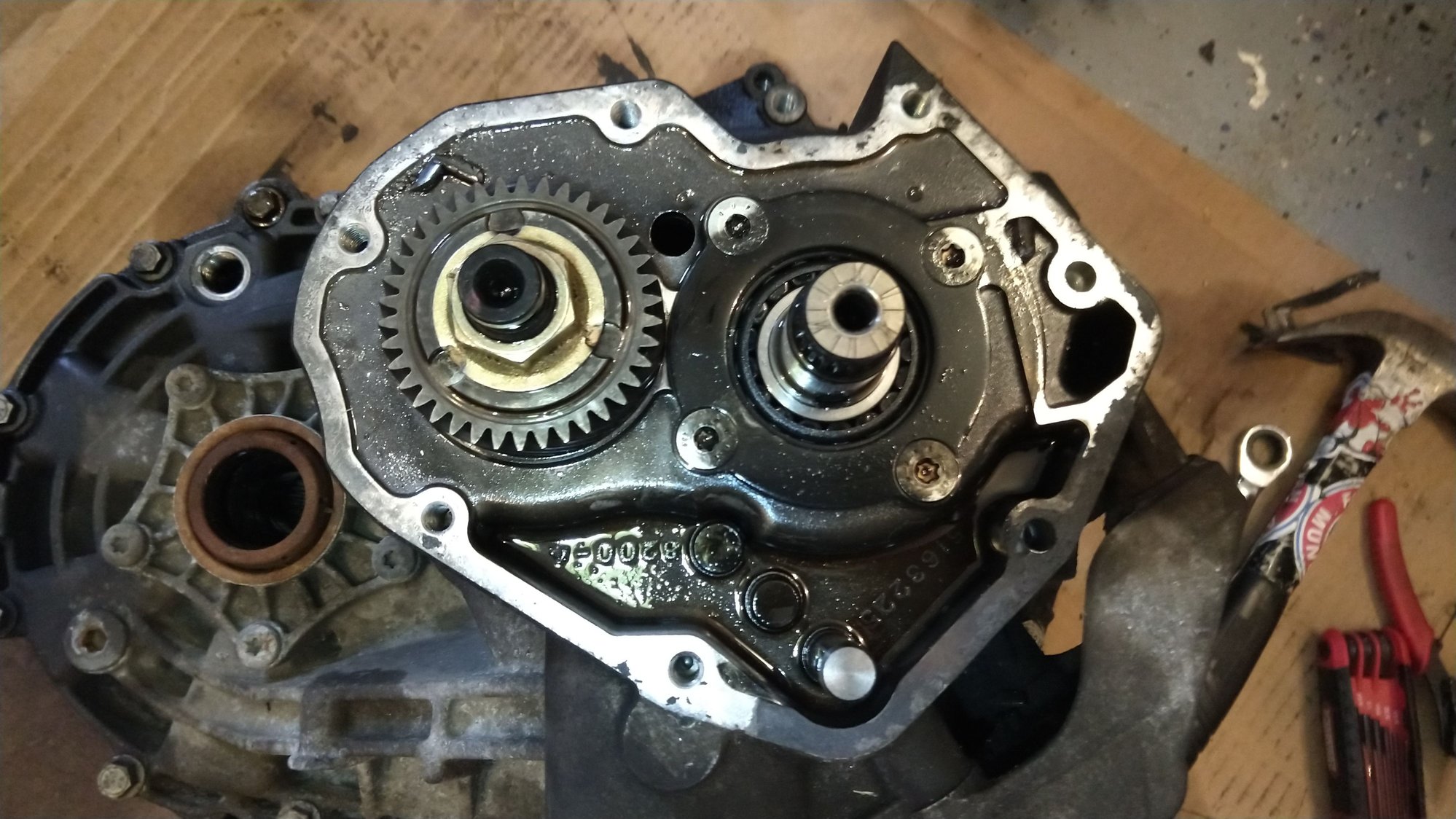

Lastly, on the transmission itself the drive gear bolt is different. Either a different metal or a different protective coating. Are both 5th gear sets interchangeable with the drive gear or do I need to swap drive gears as well?
I'm a bit stuck right now as I don't want to assemble the whole thing, get it all back in the car and then have the transmission eat itself before I get out of my driveway or my first time on the highway. Any help at all would be much appreciated.

So I was visiting my folks today and talking to my Dad about the transmission. He recognized the brass synchro. It's very similar to the synchros he replaced in a transmission he rebuilt years ago from a 1938 Buick Special, I actually helped him but I was about 8 at the time and barely remember. The brass material in this case is a single casting with the synchro surface milled into it. The other one is likely a hardened steel casing with a friction material adhered to it, likely to improve durability and handle more torque.
I picked up a set of 3 arm gear pullers from Harbor Freight for $30 and used my 20% coupon on them to save $6. Anyway, the 3 arm pullers needs to have one of its arm hooks ground down to fit under the 5th gear as there's not enough clearance. I do believe a 2 arm gear puller may work better for the 5th gear. I believe Harbor Freight sells a 2 arm gear puller as well.
