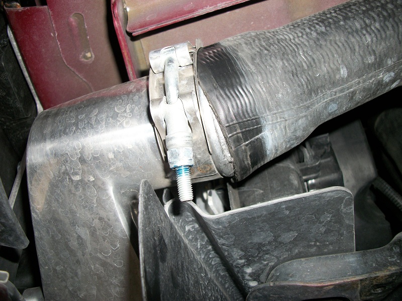

Well idk what the heck happened today but i got traction lost today and then it went to power reduced mode. Stopped the car amd it was running super bad sounded like a bad vacuum leak. Havent done the tank delete yet
Get your ECM read. You don't get the MIL sometimes, but there will still be a code listed.
When you said you lost traction, did you hit the rev limiter?
When you said you lost traction, did you go from full boost to completely letting off the gas pedal? If so, you likely slipped a clamp on one of the pipe connections at the IC. See pic below. I've had that happen twice before.
