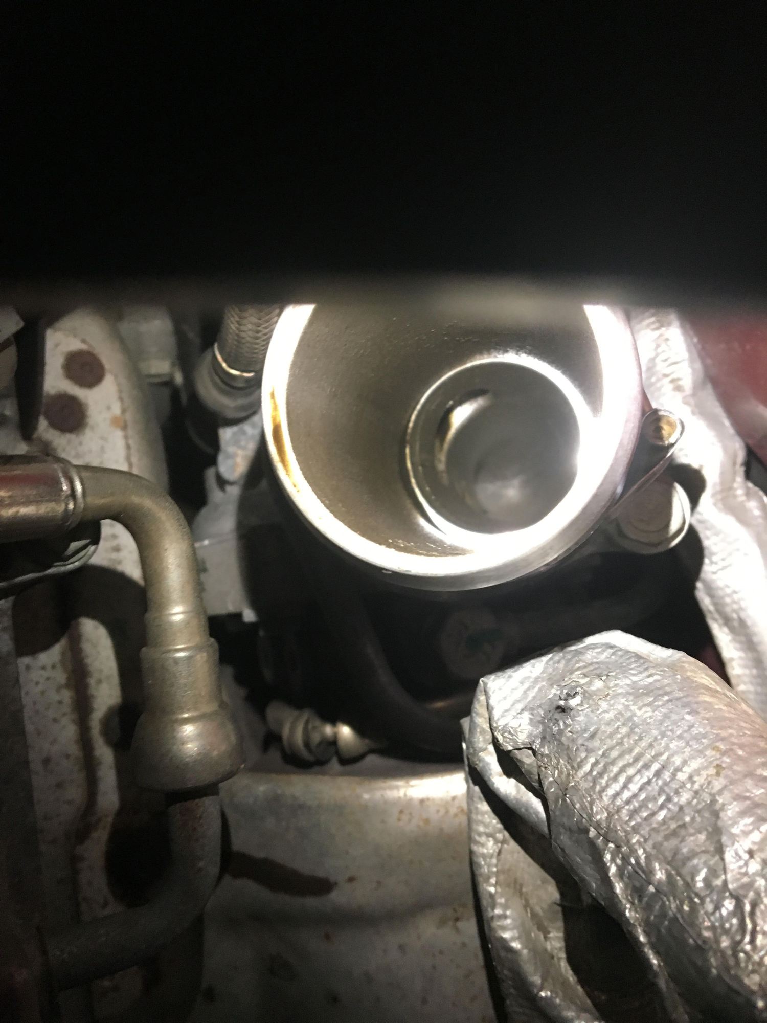

thats the picture of the turbo with the oil i have seen in it tonight. like i said im going to dig into it more tomorrow. if you have any suggestions or ideas please share.

Check code and report back, could be a bad turbo...could be fried piston rings or anything in between.

oil in the charge pipe is normal. I sure I have a pool in their myself. Probably piston ring or turbo.

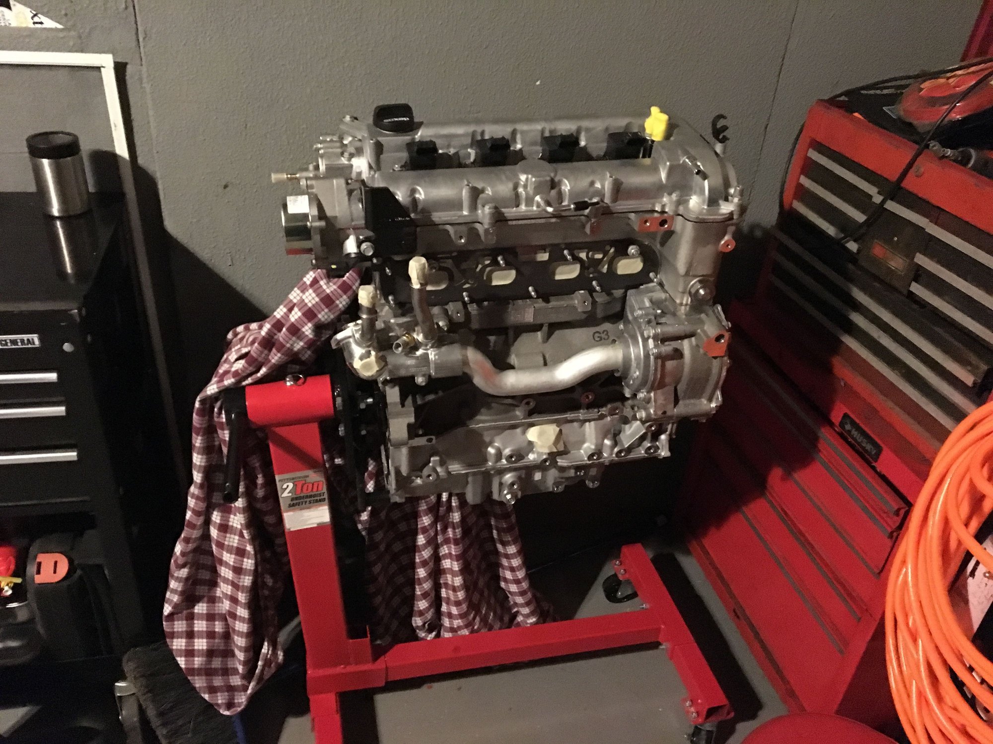

She is on the stand. I know I'm super slow at getting this all going. But I'm currently looking for a zfr 71 now to go with the ldk.
