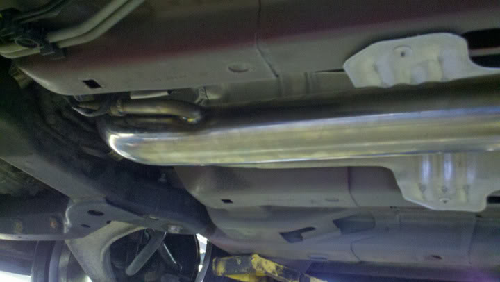

It's an awesome piece, was my first mod, if you're not going to be tuned immediately to avoid a CEL spend the money and get the angled option.

Looks amazing! How's the sound? Hear the turbo better?

is it just me or did you remove the heat shielding from flange down to cutback connection?
