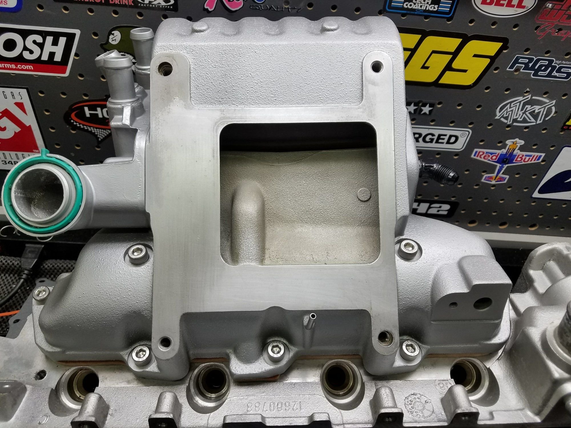

Yes you'd want a boost signal to signal high load for the methanol to spray. I don't have an SS but I'm running the LSJ intake and M62 SC, for "after" or post supercharger pressure I'll use the nipple as seen in the image below see the bottom [of the picture] there is a nipple near the middle next to the center intake manifold bolt.
