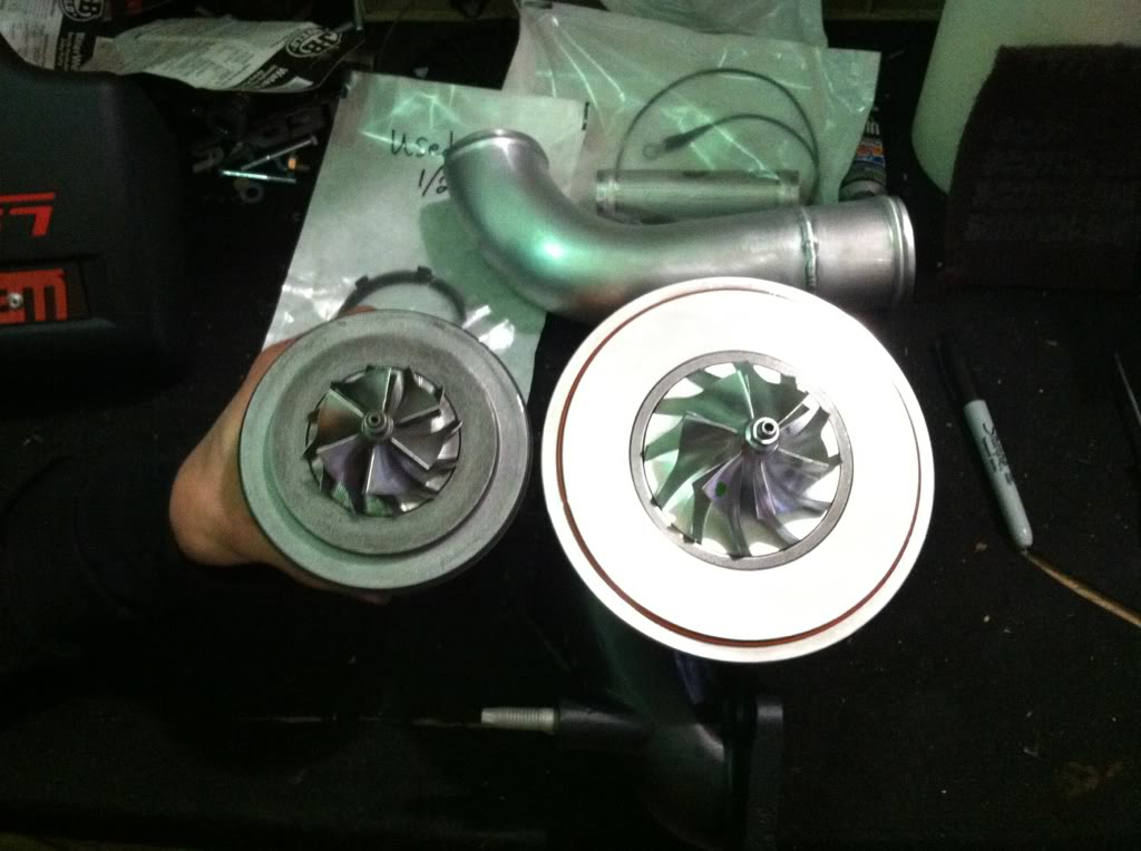

Wow a 55 mm compressor wheel in a machined stock K04 housing or does the WR3 have a different compressor housing?

the wr3 is a different compressor housing. it will fit but we saw the air flow being chocked up top with the standard wr2 SO the WR3 only comes with the larger compressor housing. both use the same exhaust housing.

I had a feeling that was the case because the stock K04 compressor housing is pretty small and with those relatively large compressor wheels in there there is not much space though which the compressed air can flow.

Stock k04 vs wr3

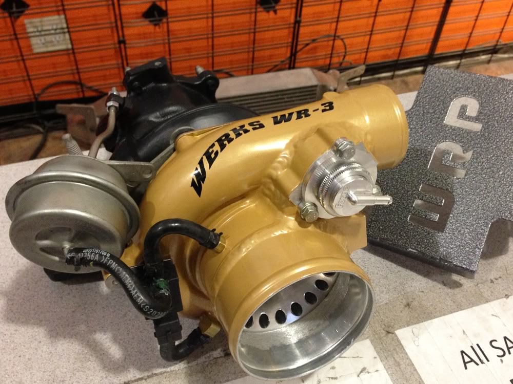

wr3 with 4" inlet

Wr3 looks huge!!

It's a big turbo, fitment was a big issue honestly.
I made 412/425 on 93 with 14* up top and 24.5#'s
