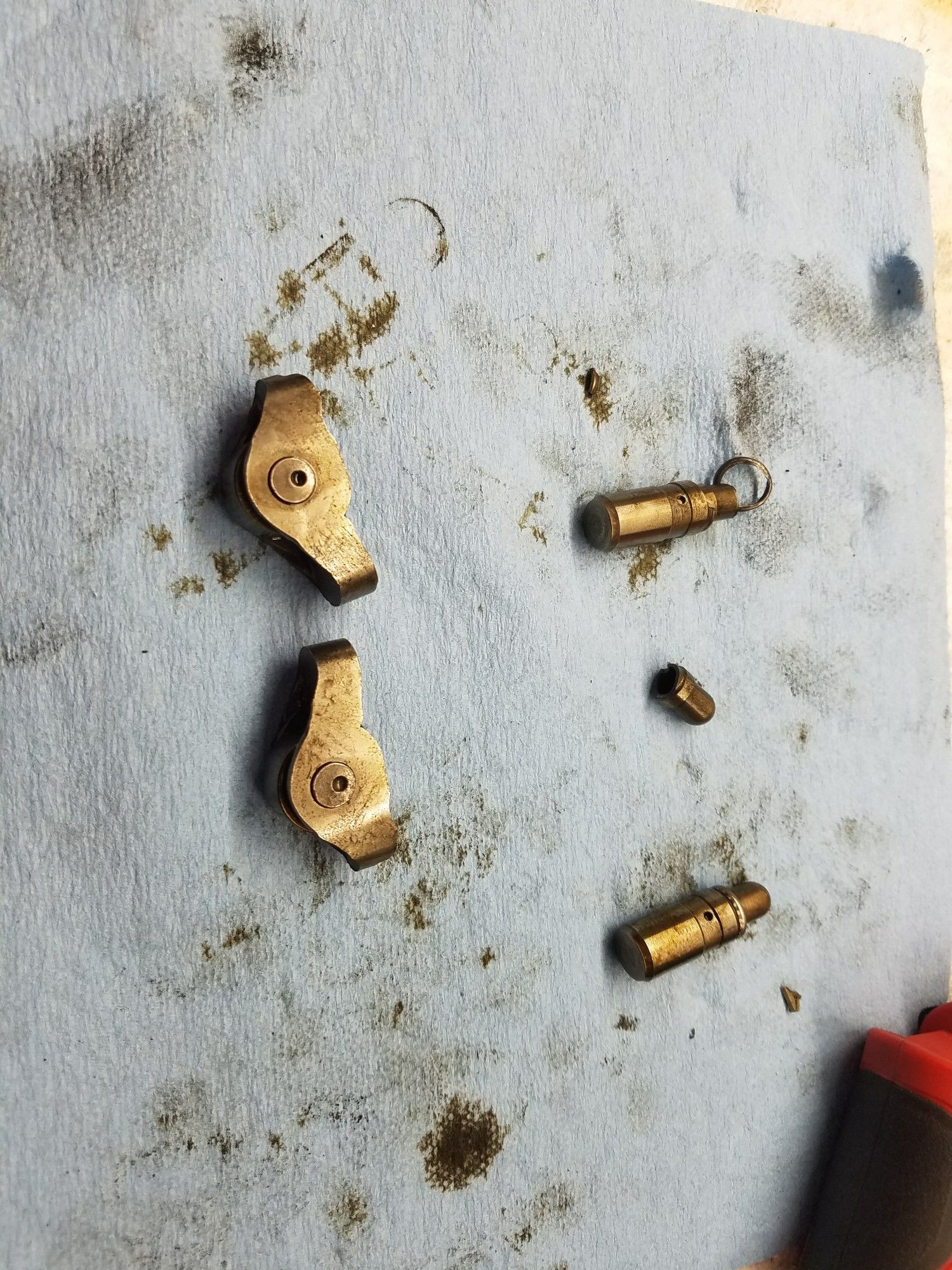

Well friends, look like I broke a lash adjuster and had 2 rocker arms fall off. One of the rockers fell of the exhaust side of cyl 1 and the other fell off the exhaust side of cyl 2.
I would love to just buy new lash adjusters and put everything back together, do a compression test and see if were good to go. Or should I pull the head, and take a look at the pistons to see if they are cracked or have broken ringlands , thoughts?

What causes these to break? Over-rev?
Yes, over-reving causes this issue. Hopefully its not too damaged when I take the head and pistons out today. Could have a cracked piston or broken ringland.
