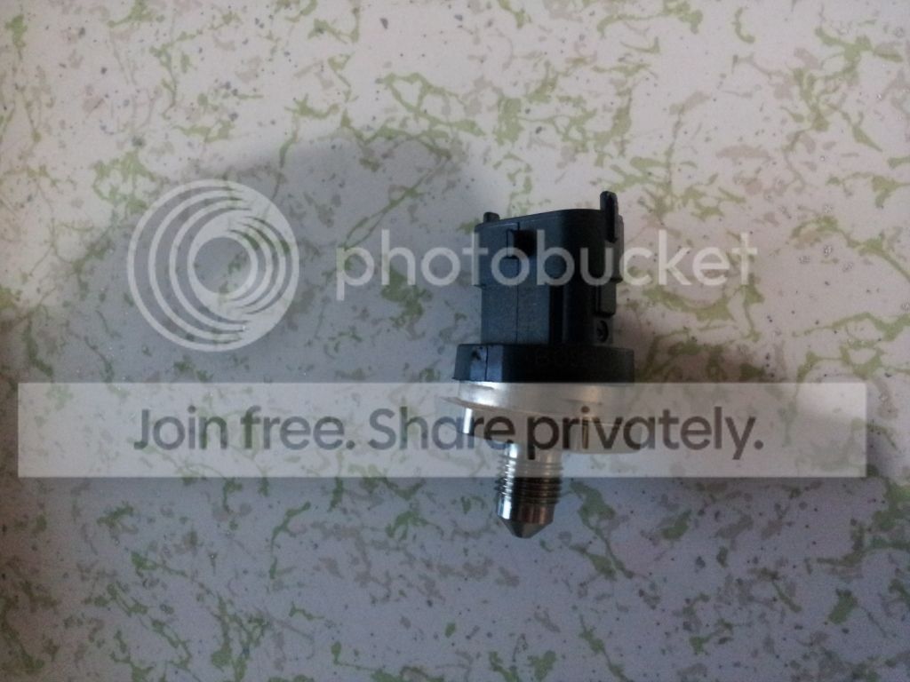

In my case, the sensor was brand spankin' new on a new rail, new harness, new injectors. But it looked like this:
I hadnt noticed it when I put the rail on the car. I assume it got damaged during shipping as that corner was right up against the box corner and looked banged up. I think inside of that is the sensor that is probably soldered into the harness. So, I figure the bend like that broke the connection inside cause no matter how hard I push it back so it look sflush, it just pops back up to what it looks like now.
Luckily, the dang thing screwed out of the rail fairly easy and I was able to replace it with the one off the old rail Car drives like it hasnt in a long long time. Damn me and those supertechs! LOL
