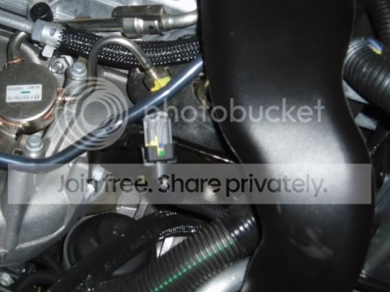

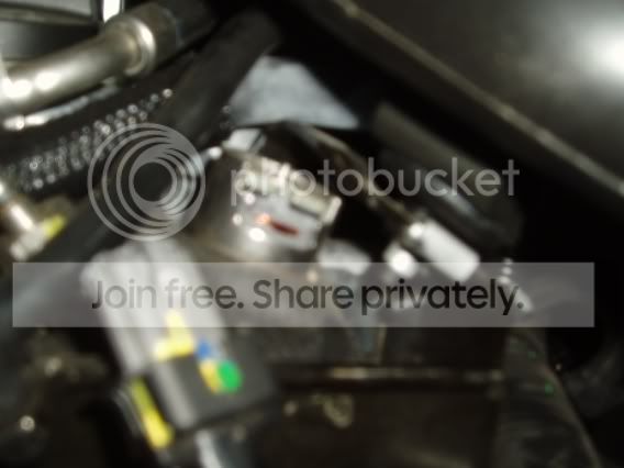

EXACTLY, and it looks like that too lol BROKEN
http://i528.photobucket.com/albums/d...3/P1010027.jpg
http://i528.photobucket.com/albums/d...3/P1010024.jpg
CHECK IT OUT, the similarity is ASTOUNDING, I was so pissed. and I Still am, I had a Really good run going too, ****! ASS!
What the Hell is that sensor anyway, and Why does my engine reduce it's power because of it, I demand answers.

From: Somewhere, MI
yea that's the high pressure pump

its the connector for the high pressure pump (that controls pump pressure) that broke, basically the engine can't control fuel flow, the dealership can fix it if you go int
it broke because of the engine movement, not sure how they didn't catch it in development, but when you only have 20 vehicles and you need to represent thousands sometimes you miss things
the high pressure pump controls fuel flow to the rail/injectors, if it is off then everything is off
