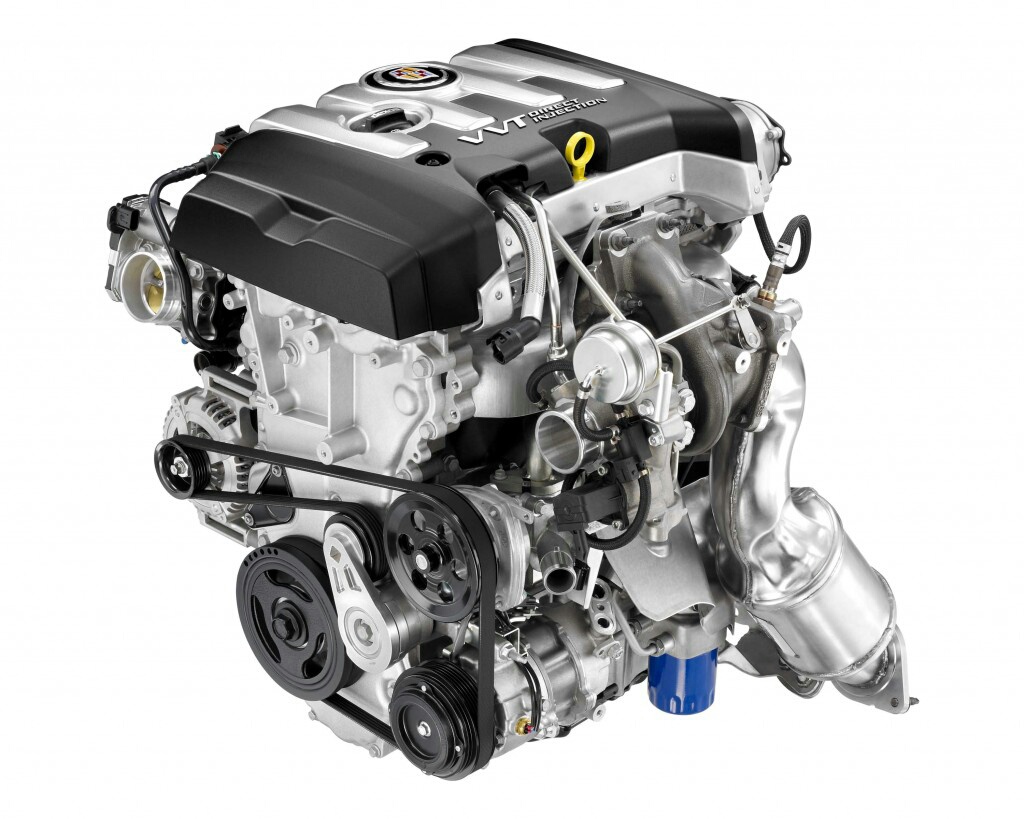

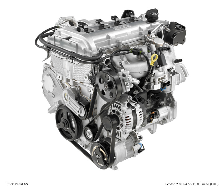

From: buffalo
LHU
LTG

If you look at the 2 engine pics, you'll see a MAJOR change.
The intake is where the the exhaust was...
And the exhaust is where the intake was...
The balance shafts are in the pan now in the LDG
