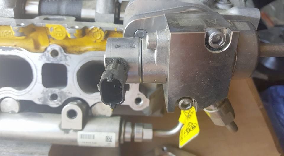

Done. tuning the Balt with the 2017 LT4 fuel pump. She runs unreal right to redline but now I have to figure out how to control the ungodly torque steer. Go to my facebook page for more info Jeffrey Nelson Reiland

well then i guess im screwed because i dont have facebook! damnit jeff!! how was the install and such???
Im on vacation in Arizona so you can call at 412 915 3183

I want this but with a pre bent line is this possible ?
I made a jig to bend them so I have a few ready

Nice! Does this eliminate the need for the bigger fuel lobe cam? Thanks for doing this jeff.

It was actually set up on the fuel lobe cam

I'm new to the LNF platform what is the difference in the LT1 VS LT4. What makes it move more fuel?
The LT4 pump is about 33% larger and runs up to 2900psi. Lt1 runs 2000psi

So this is a direct bolt on besides the line? Mounting point is the same?

It uses an adapter which is a direct bolt on.

IM ALSO WORKING ON A REVISED ADAPTER WHICH WILL CLEAR SPECIAL INTAKE MANIFOLDS. Should be ready soon

Send me for test fitting while I have 2 of the sheet metal manifolds available

Can't imagine he is running anything other than opels. I'm wondering if the LT4 pump will feed enough e47 on opels for a quick spooling turbo like a 6758 without the fuel lobe.

Mine was $850 from dealer. Im running a 7163 with no issues and have my limiter set at 6900. My last mod will be a Quaife 6 speed conversion
