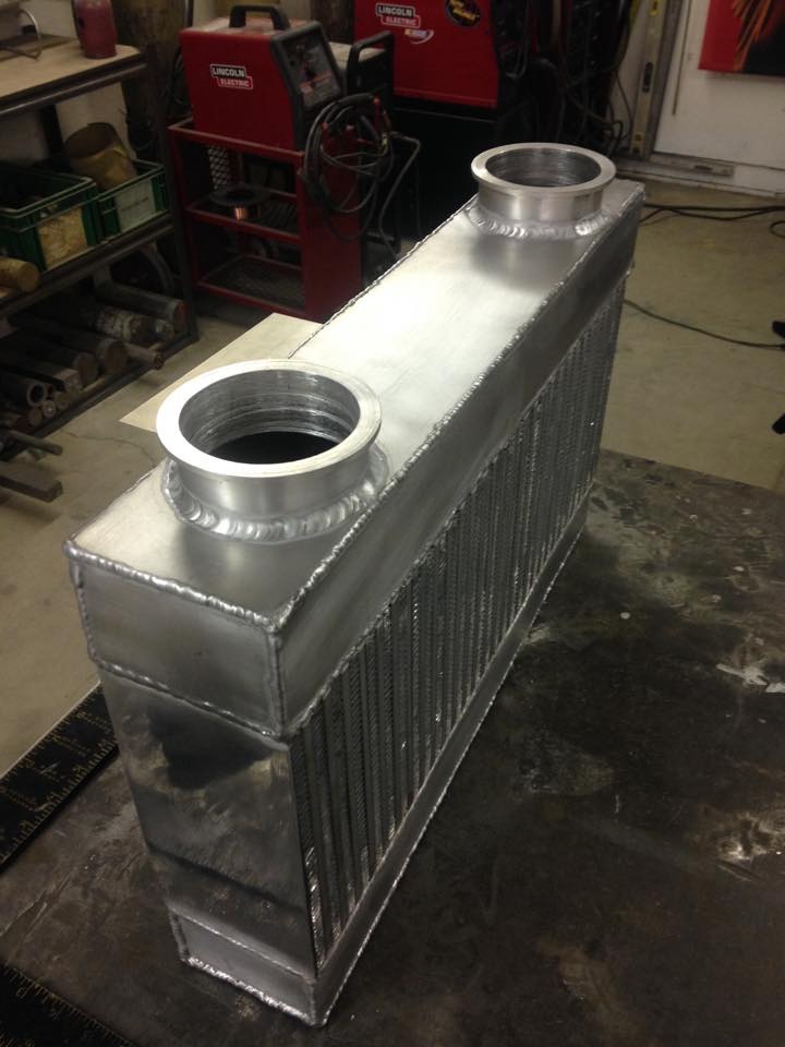

Things took time over the winter. Lots of custom fab work and the guy works full time so squeezing me in hasn't been easy. 3.5 Inch downpipe, full 3.5 inch exhaust, All charge pipes are 3 inch vbanded.
Should have the car this weekend, will be towing it down to the race shop to swap in cmiller8006's motor with stage 3 cams and phasers, as well as a clutch.
Then the tuning begins. Will find out if i need to go bigger on the hotside or bigger on the turbo in general to meet my goals.
Hell maybe the turbo is sized perfectly. We shall see.
Fab work mostly done minus charge pipes:
http://i1189.photobucket.com/albums/...scpjz1ctg.jpeg
Custom intercooler made with a treadstone core.
http://i1189.photobucket.com/albums/...sod7rpzxi.jpeg

Nice!
I forgot that you bought CMiller's engine...jealous!
That IC though...monster!
