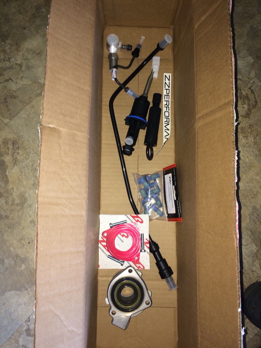

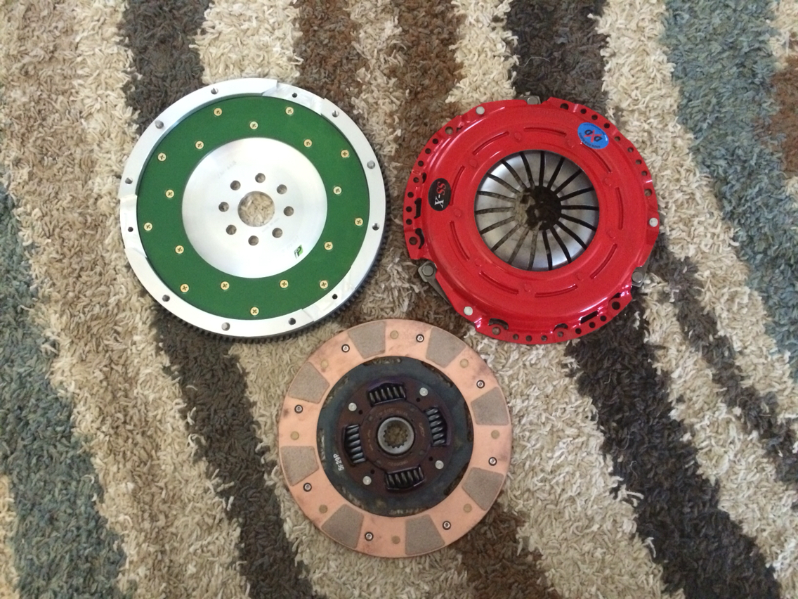

Parts!

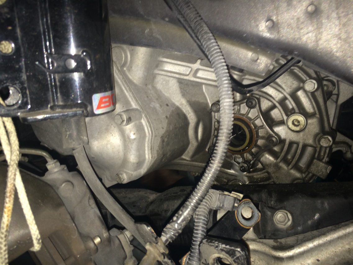

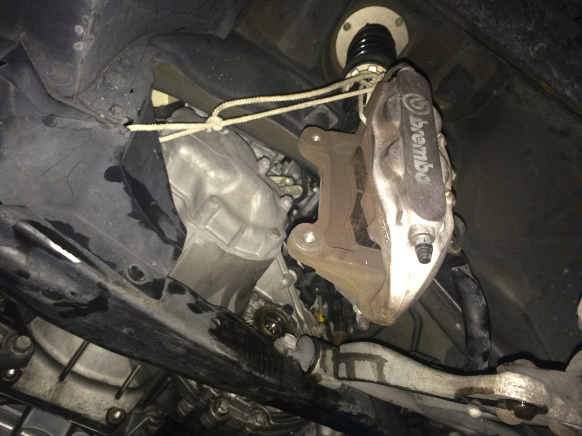

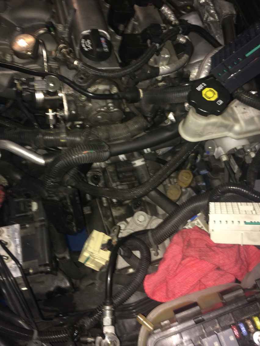

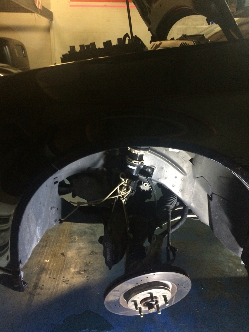

Some progress pics.
Got to my buddies shop at midnight after I got off work. Moved cars and put mine on the lift. Stopped at 3:00a.m.

Looks like you're removing the hubs. If so, you're kind of making more work for yourself that way. Just disconnect the lower control arm, sway bar end links and tie rods. The strut/hub/brake assembly can then be left hanging in place and is easily mananeuverable.
Some guys even leave all the suspension as a whole connected and just unbolt the strut assembly from the tower and lower everything together. That works just as good, but after doing about 2 dozen or so cobalt clutch jobs, it's not really my favorite method.

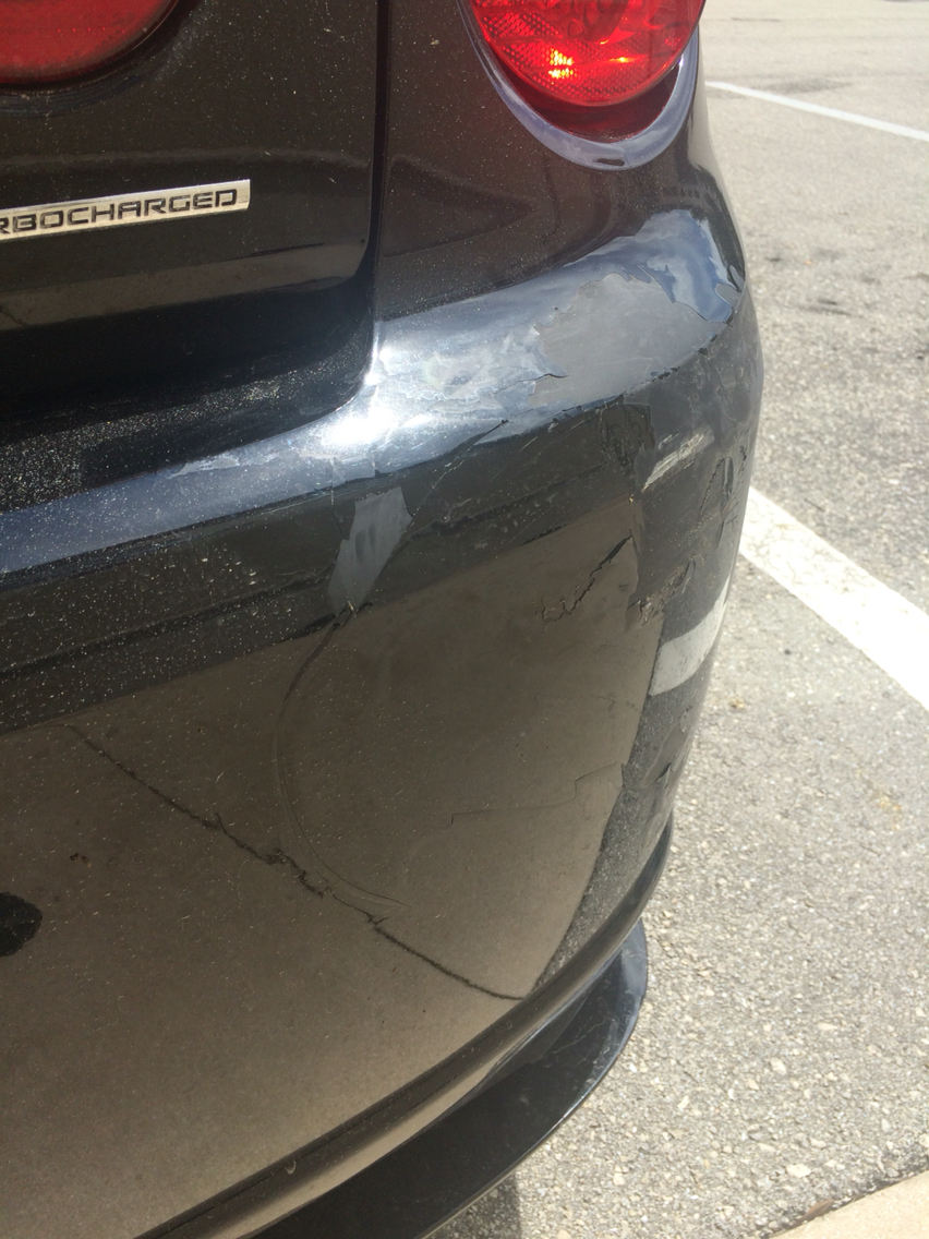

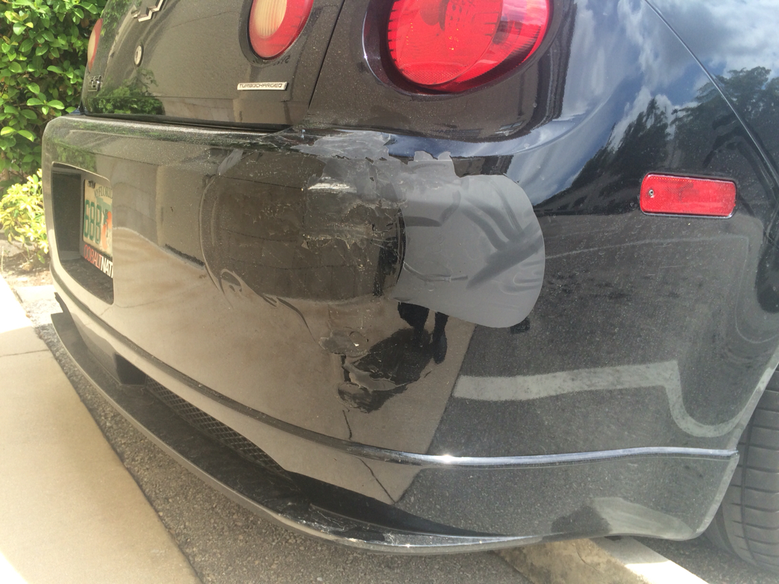

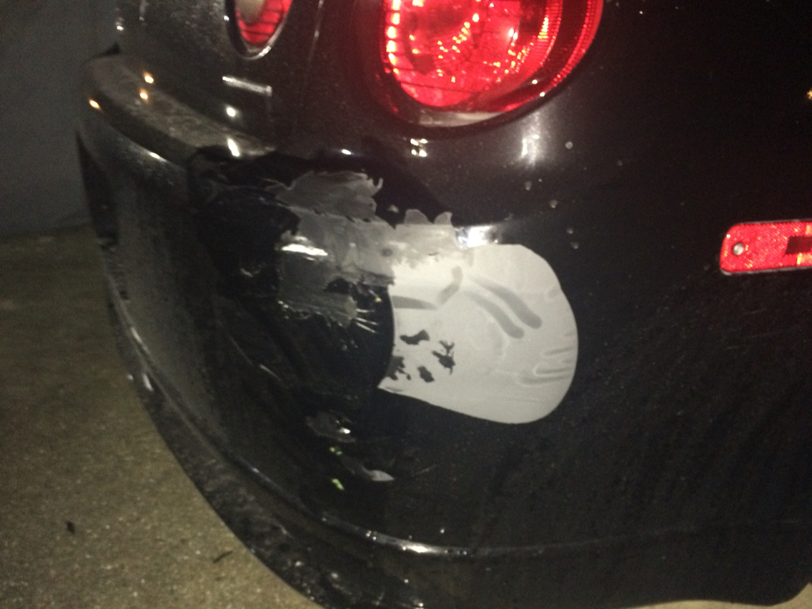

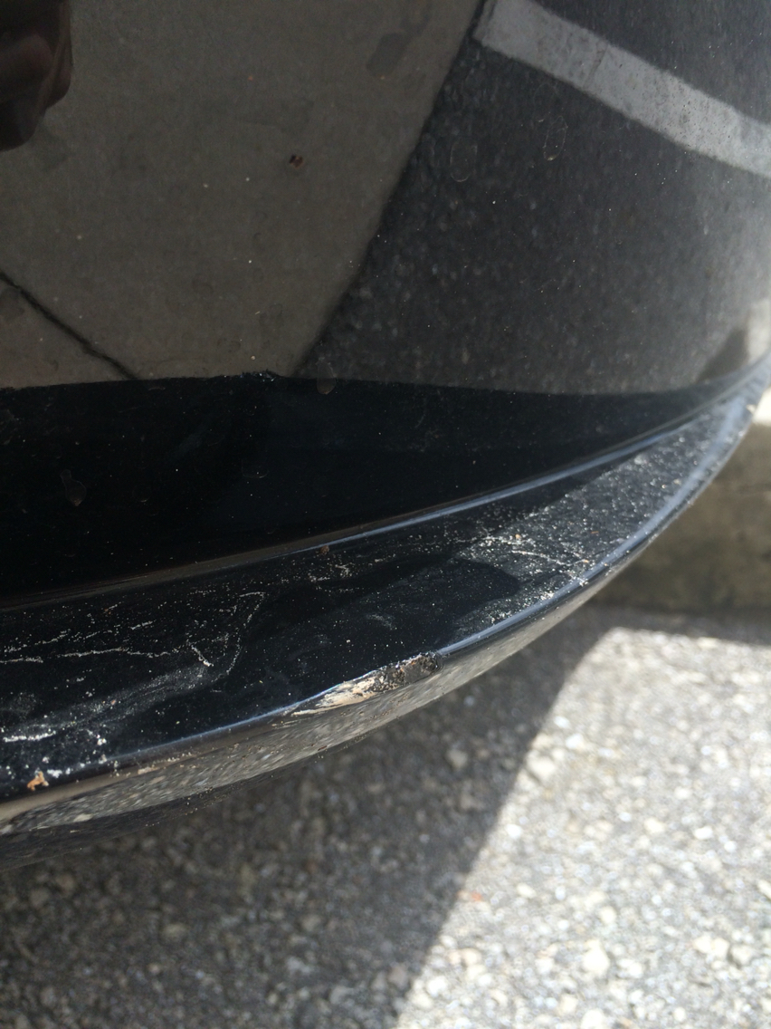

Ok so I had backed into a wall at night out front of my house (I'll just keep this part short by I'm an idiot) I got my bumper repainted and I have all my charge piping in FINALLY. I've been running lower hot and cold side pipes until just now. Clutch is broke in so I can finally start sending some logs to Kmo43.

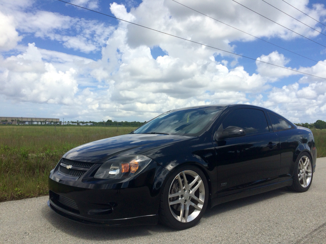

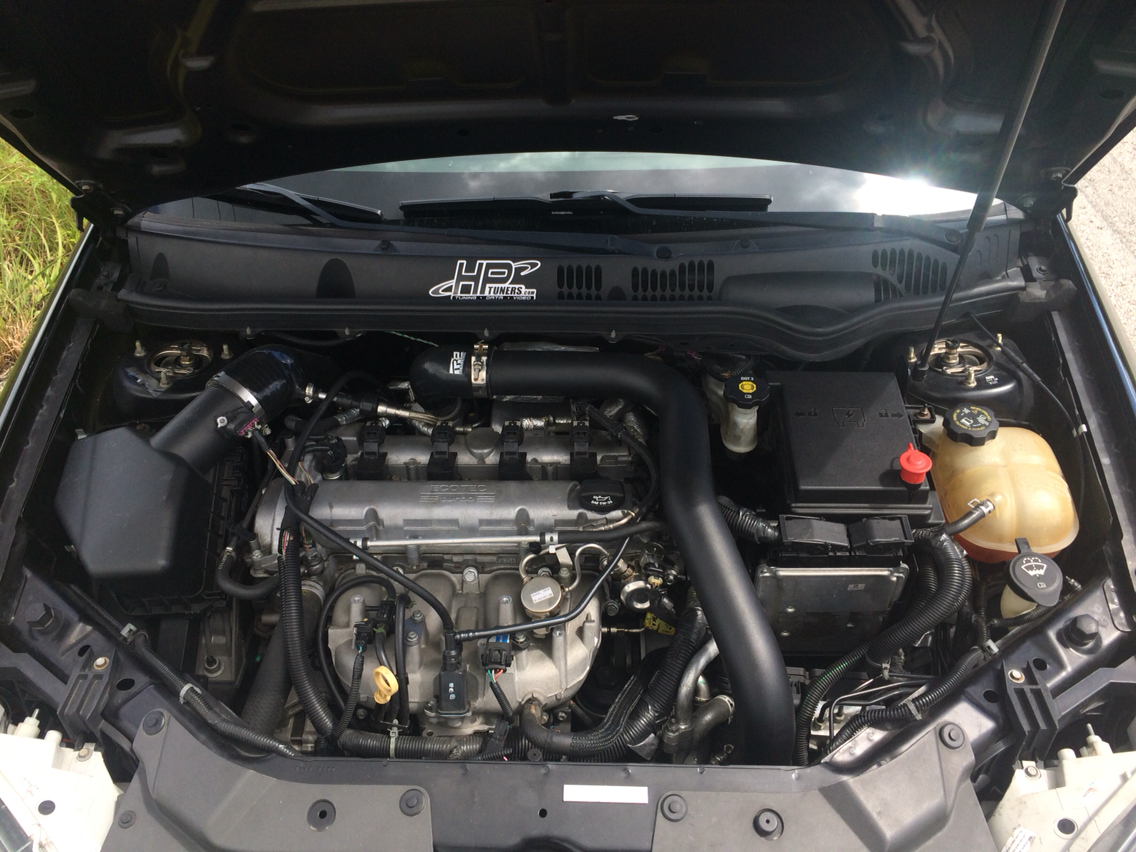

Pics
Attached Thumbnails photo739.jpg   photo734.jpg   photo104.jpg   photo134.jpg   photo306.jpg
