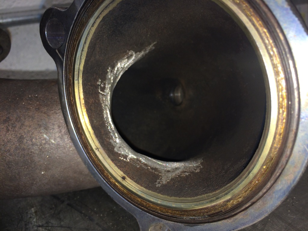

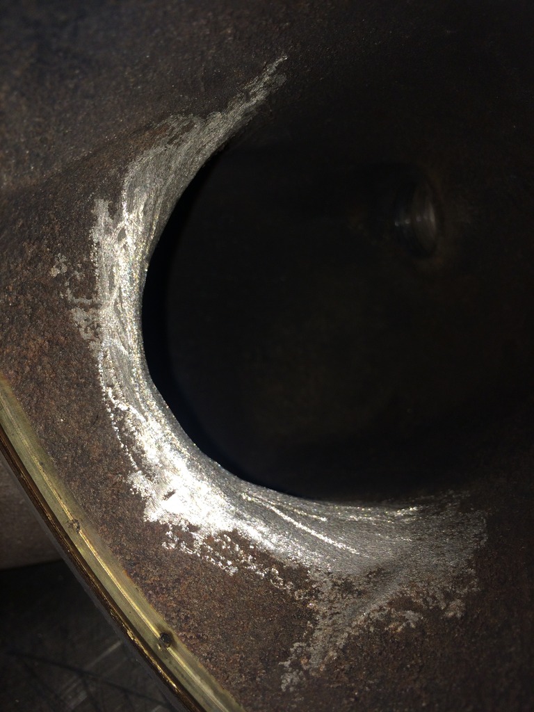

Ported my o2 housing

does porting the up pipe really help with anything? like how much material can you remove? Do you have a measurement?
Old Jul 29, 2016 | 09:07 AM
  #106
KMO43's Avatar
Posts: 6,894
Likes: 95
From: Calgary
Up pipe? Porting the o2 housing has 2 benefits that both in the end come out to the same conclusion. The o2 housing is a tighter than 90° angle so you can really smooth out the flow around the inside radius. There is about 3/8in you can take off. Having the o2 housing bigger at the smallest point and with a smoother flow will gain a bit of flow but I believe it helps more with getting heat out. I had my housing ported when I originally threw my R on and I had great results with it. People that know me know that if I take a part off to get at something I usually modify it if I can to improve performance
Sorry, up pipe is subbie terminology and im using it wrong. Its the O2 housing pipe is what I mean. I always called the up pipe, the tube from the turbo to the down pipe.

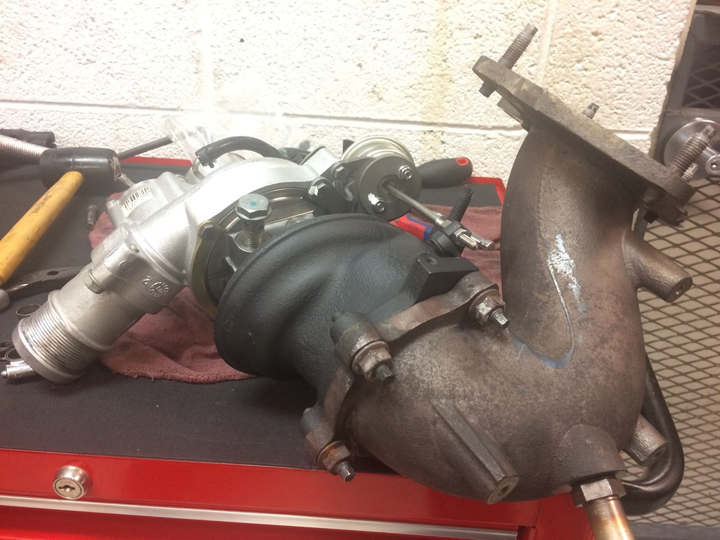

It's in

Seeing how I can't boost on it till its broken in it seems normal to me lol. Sounds good with ported o2 housing.

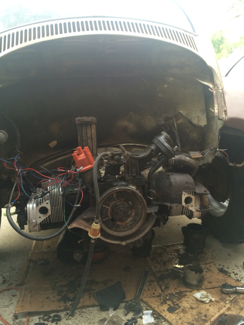

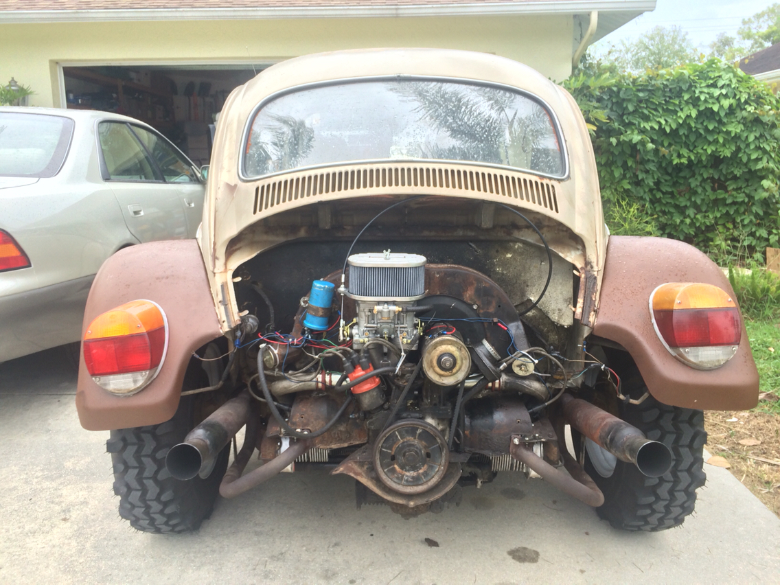

Not build related but helped a friend rebuild his car, new heads, pistons, cylinders, carburetor.

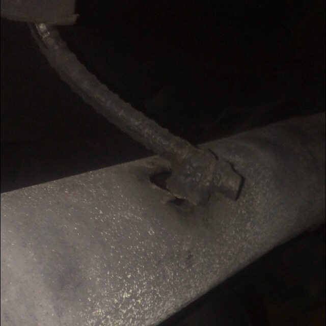

Well, previous owners home made muffler delete finally gave out in a way.

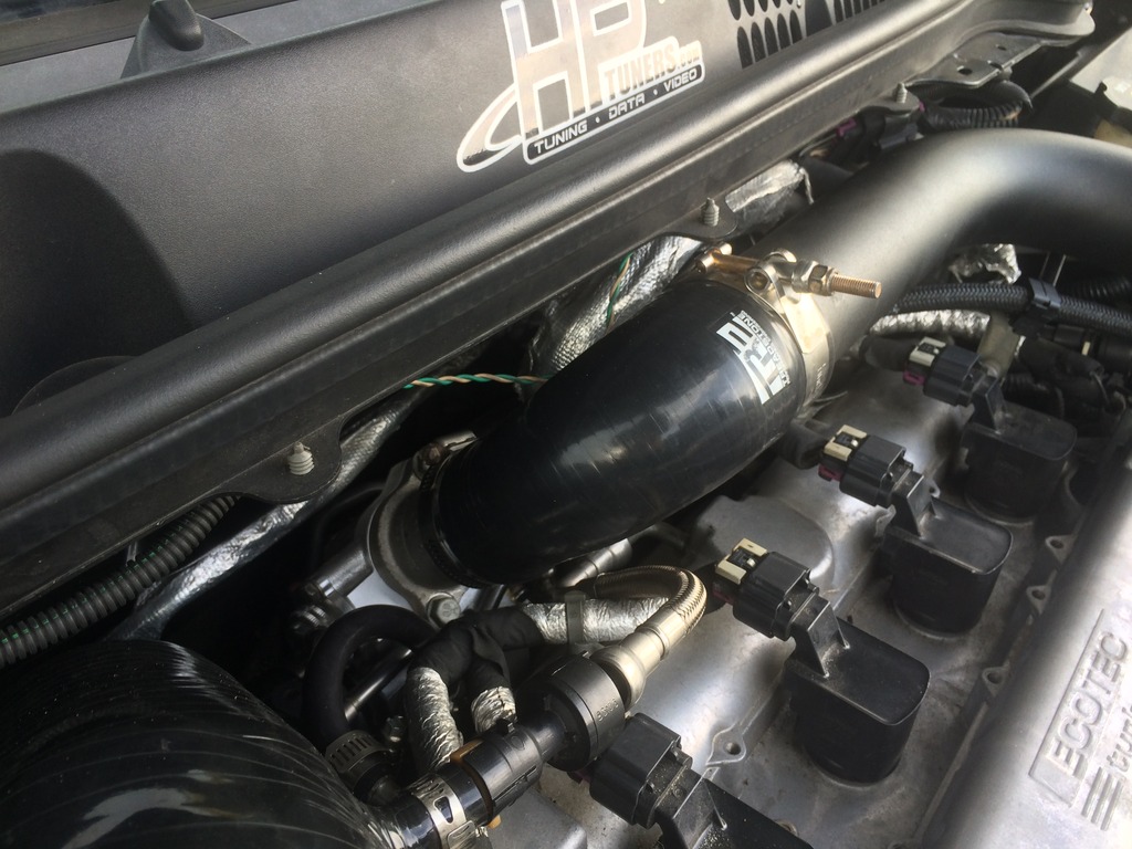

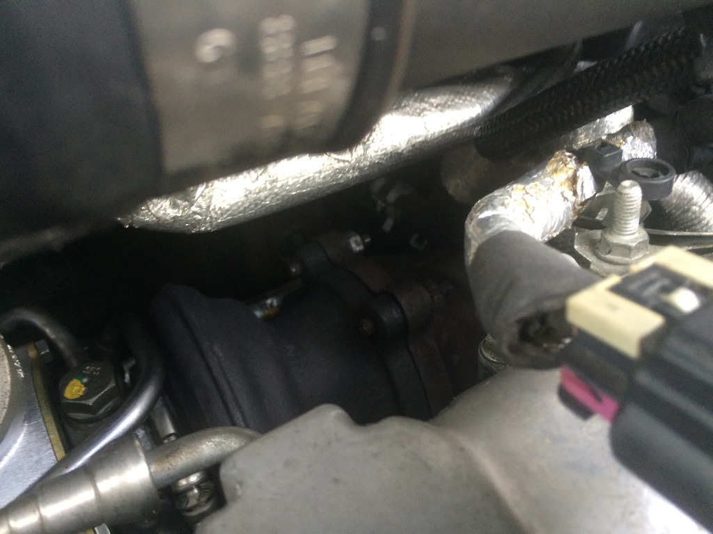

Had a leak somewhere and fixed it today. There was a slice in the hose from turbo to valve cover.
