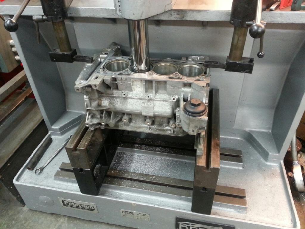

these are the gen2 sleeves and the machinist I use is really picky about how things are done

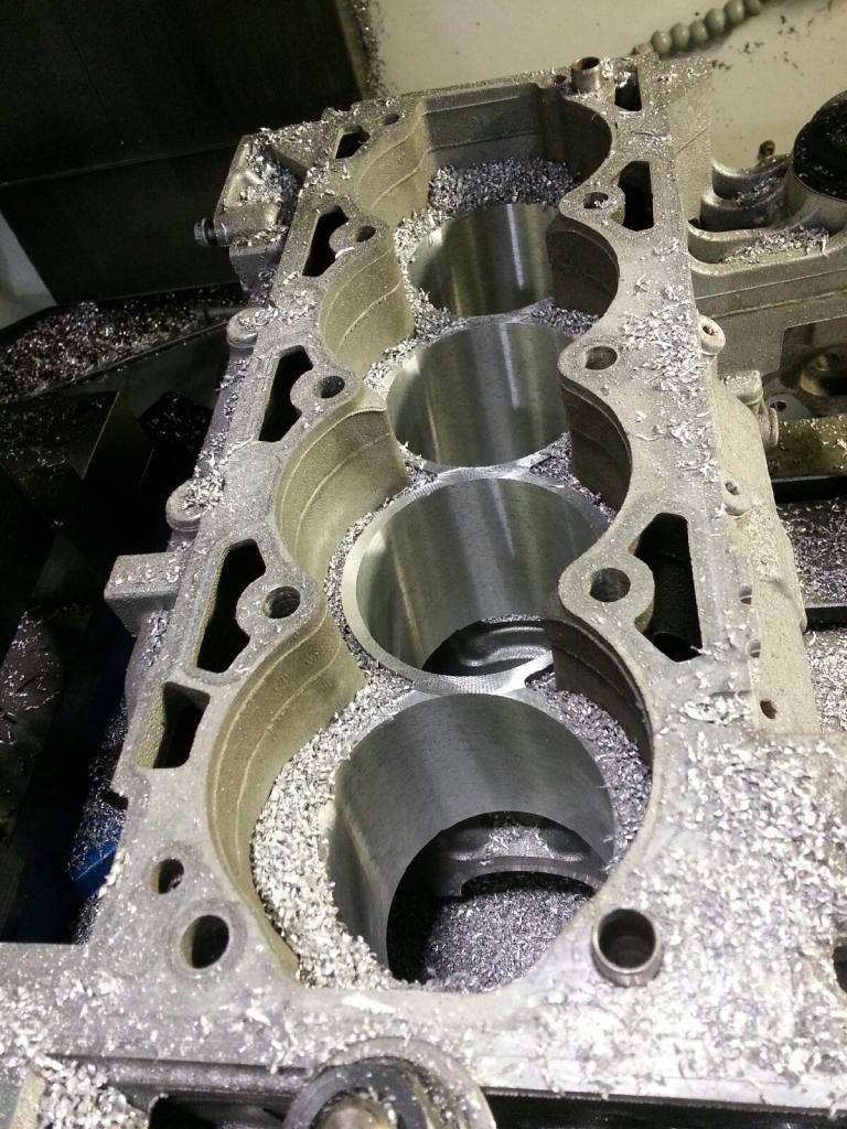

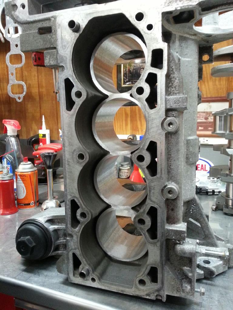

What's to keep these from shifting?

Originally Posted by 100% METH
BEEF CAKE
The stock sleeve support and the clamping force of the head. The place that makes these for papaw uses this exact design in open deck honda sfwd cars pushing 900 wheel at over 40psi.
is this block going on a turbo or blower setup?
Non-intercooled Borg Warner s360et t4 .91ar with a 75 shot. 10.5-1 diamonds fully coated, ap rings, Molnar rods.
That's the basics.

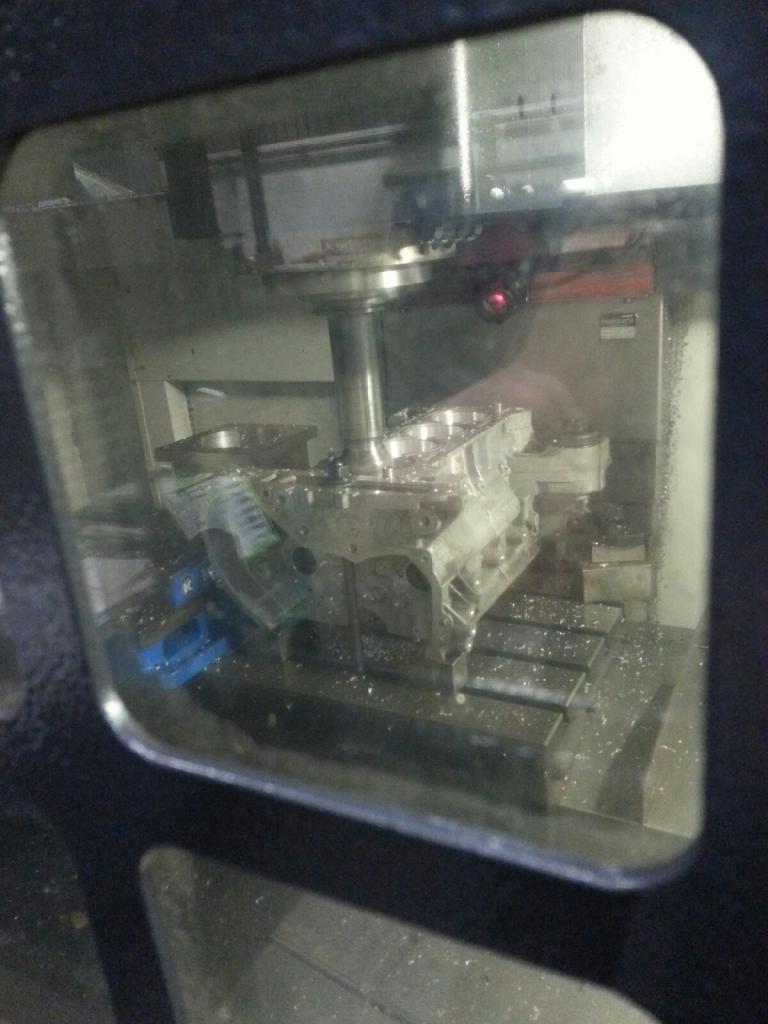

we dont remove block material like a darton or a bates sleevs does

Whats keeping the sleeves from settling

there is nothing to settle

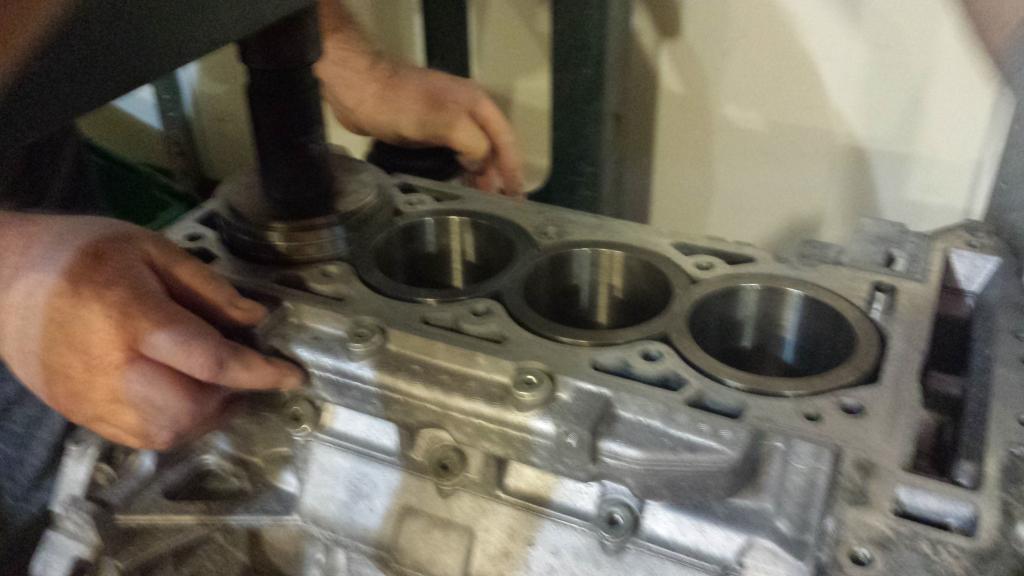

They sit on a machined shoulder.. There's nowhere for them to go.
I see that.
Sitting on a shoulder of a foam casting

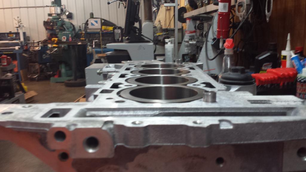

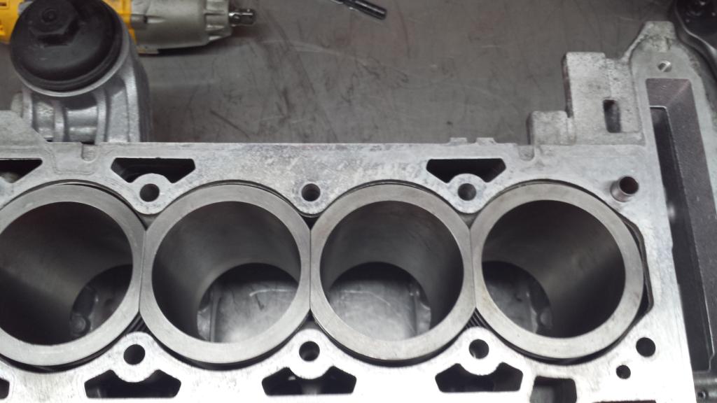

I see that.
they set really close to stock and the very bottom of the block is not used so get to your point
I see that.
So you think it's going to just shove the aluminum out of its way? Come on.
It's held the same way every other sleeve is. And with a much wider shoulder than most. On top of that, it's press fit and epoxied in place.

For the record im not against this idea. Its very clever.
y not stick to the drop in sleeves that seem to be working just fine. Add a little upper support to tie the block together. Steves engine is proof of that.
Bates sleeves settle into the block and yes alan it can push into the aluminum. All it takes is sleeve to move a couple of tenths to unseal the HG.
Y do u think bates calls for his sleeves to stick out .002-.003 and oring the top of the sleeves.
