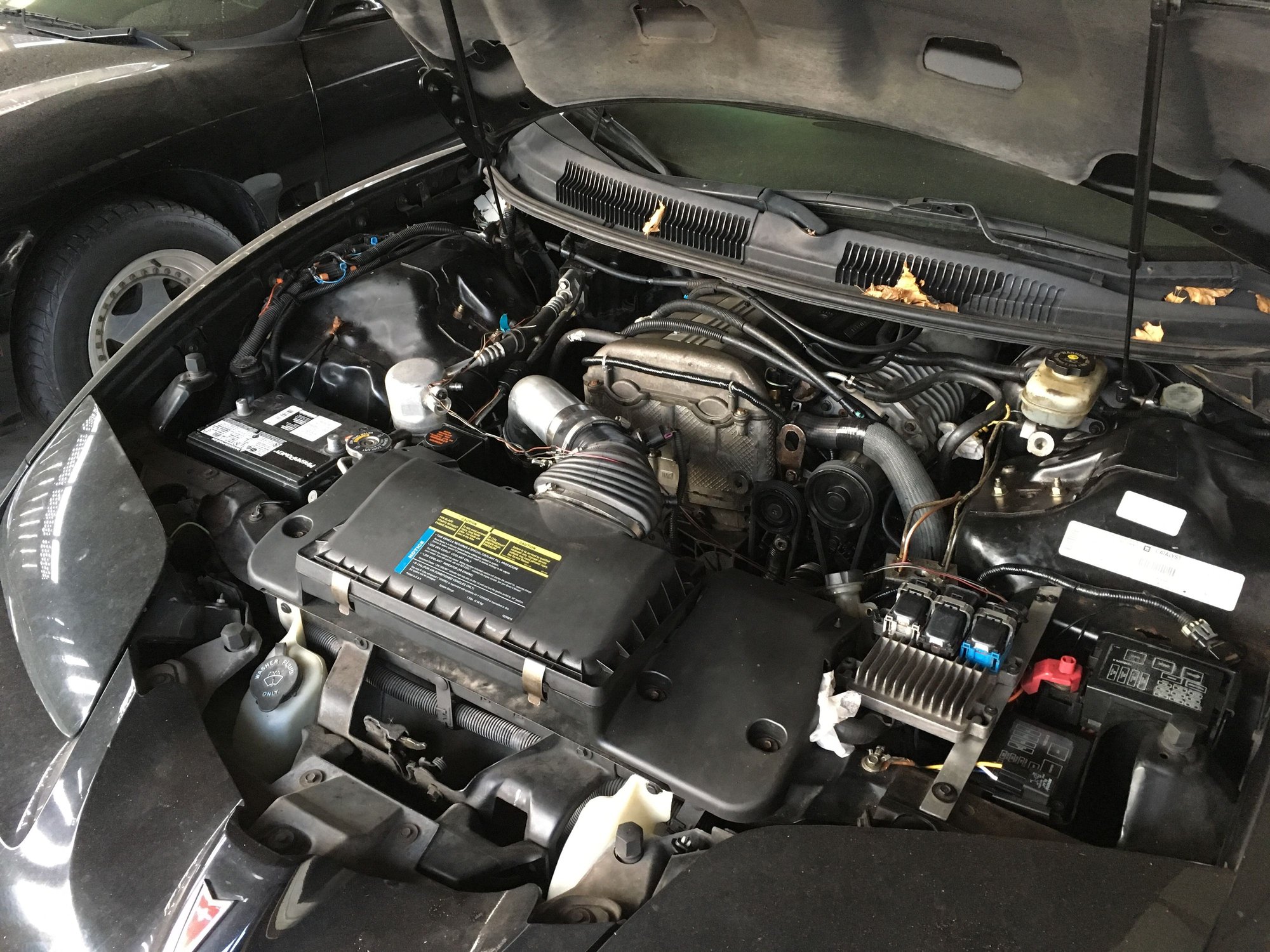

I've LSJ swapped a 98 Firebird. Its using a solstice transmission and crank pulley, and after a few runs at high rpm the crank seal is getting pushed out. I replaced it with a new one and had the same thing happen in less than 100 mi. I've since ordered a new crank pulley and seal since the pulley I have (bought new for the swap) looks like it wobbles a little bit, but am wondering if maybe the gen 2 blocks have different front cover and seal dimensions or am I suffering major blow by? Doesn't seem down on power and the second seal I ran with the dipstick hanging out so excess pressure had another escape in addition to the valve cover breather. The breather is running into the intake but its far away from the TB.
Heres a photo for fun,
