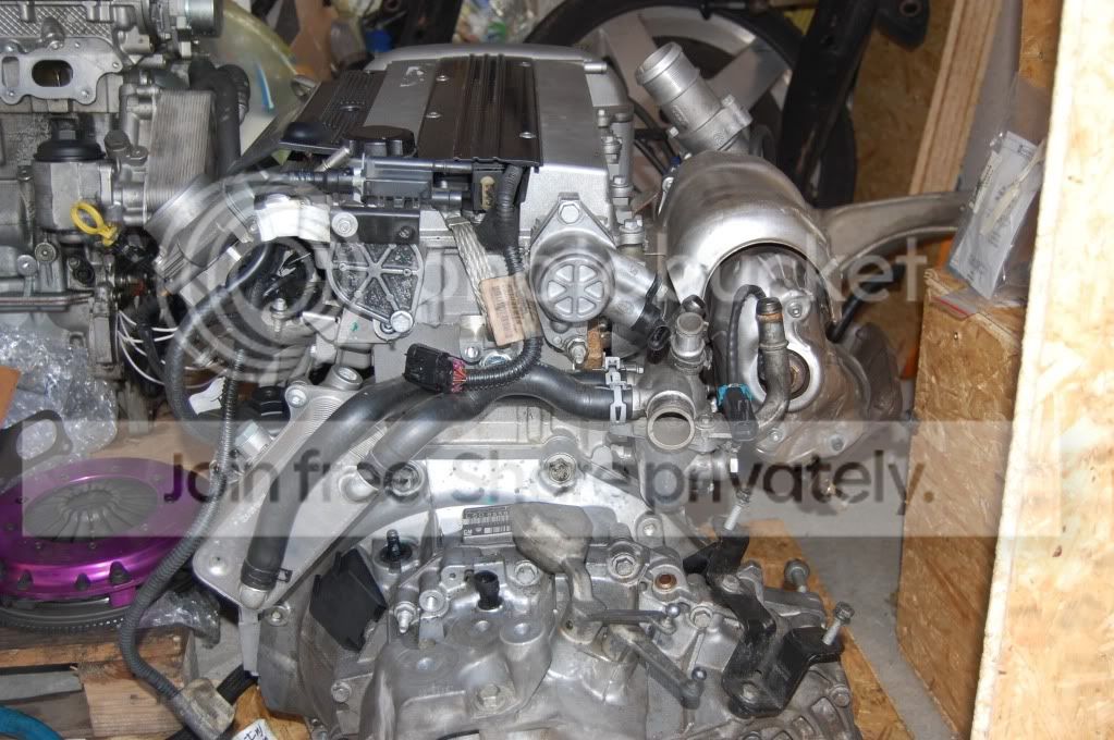

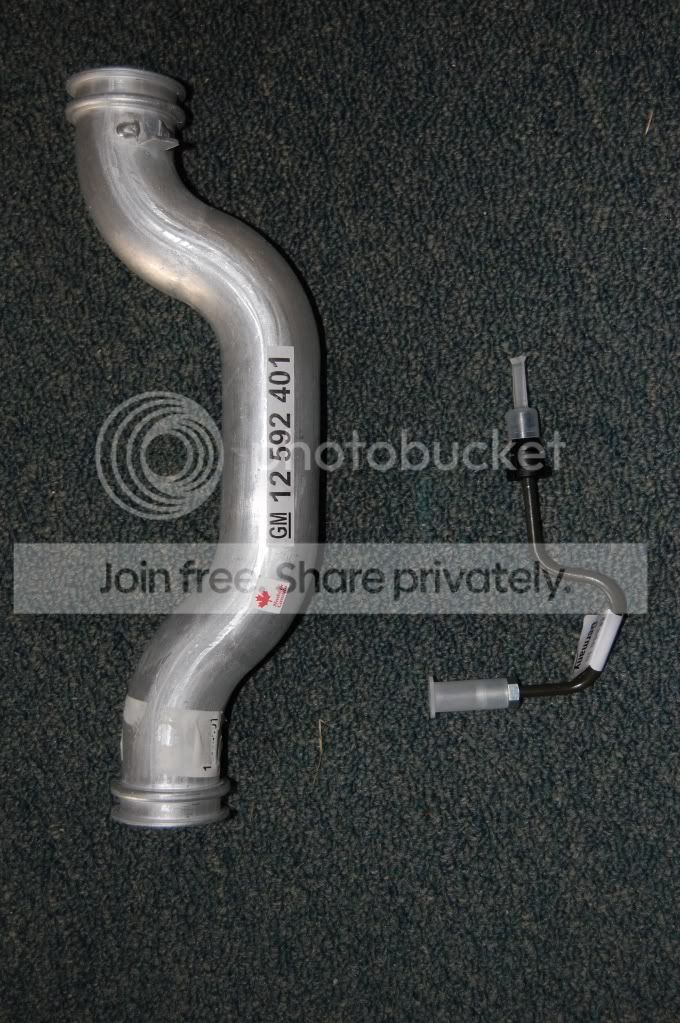

You will need to replace the LSJ coolant cross over pipe with one from the LNF to make clearance for the turbo/manifold.

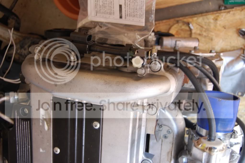

A cheap solution for the Intake manifold would be to use the stock M62 and LSJ IM as an intake. Remove the bypass valve from the M62 and it will never make boost. The rotors will spin freely and you don't have to worry about re-routing the serpentine belt or changing to a 2.2 alternator.
I am pretty sure the stock LNF charged air pipe would work to run from the outlet of the turbo to the TB. It would need to be cut off right at the TB and connected with a 90* silicone elbow. Then the MAf sensor would have to be relocated to intake. An aftermarket LNF intake should work in the RL although the Hahn makes an good option because it can be directed into the fender well to get the coolest air possible.
Another good option for the RL would be to point the outlet of the turbo down and run the charged air pipe up under the engine. Keep the top of stock intake with the maf holder and connect the charged air pipe to Maf holder. That would give you a blow through setup.
I have some of these parts if anyone is interested.
