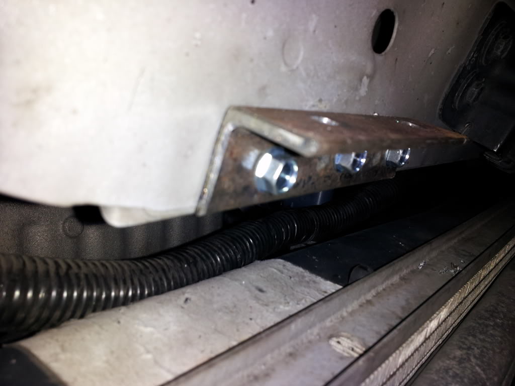

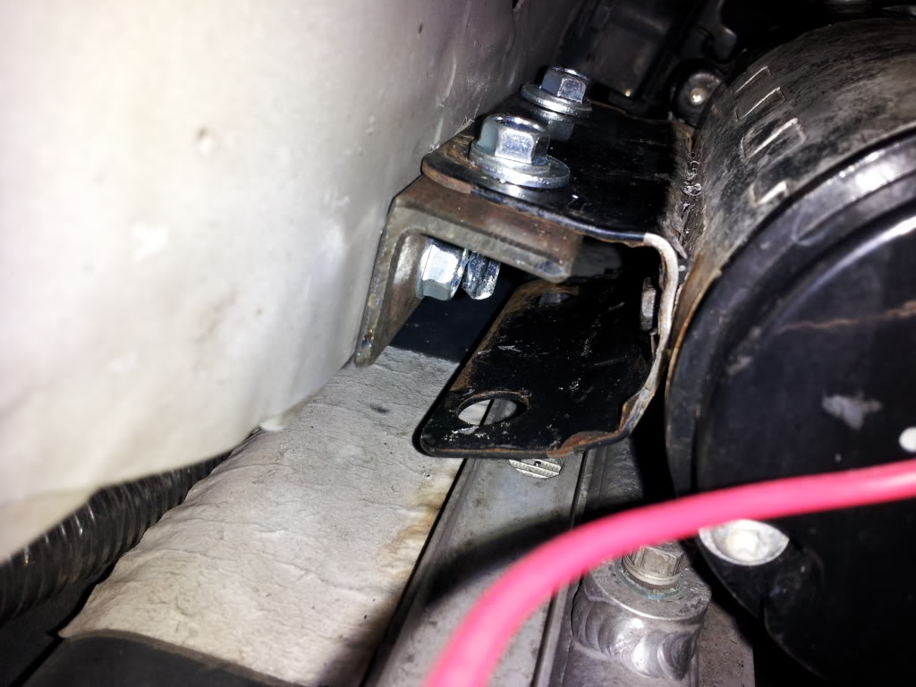

We made a different bracket for the pump and fit it right under where the top of the grill is, to the left of the hood release. Fit perfect.
Put in for test fit

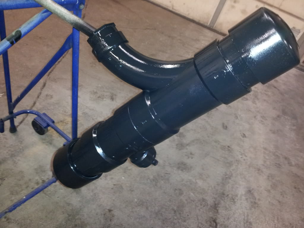

Decided to paint it to match my blower even though noones ever gonna see it

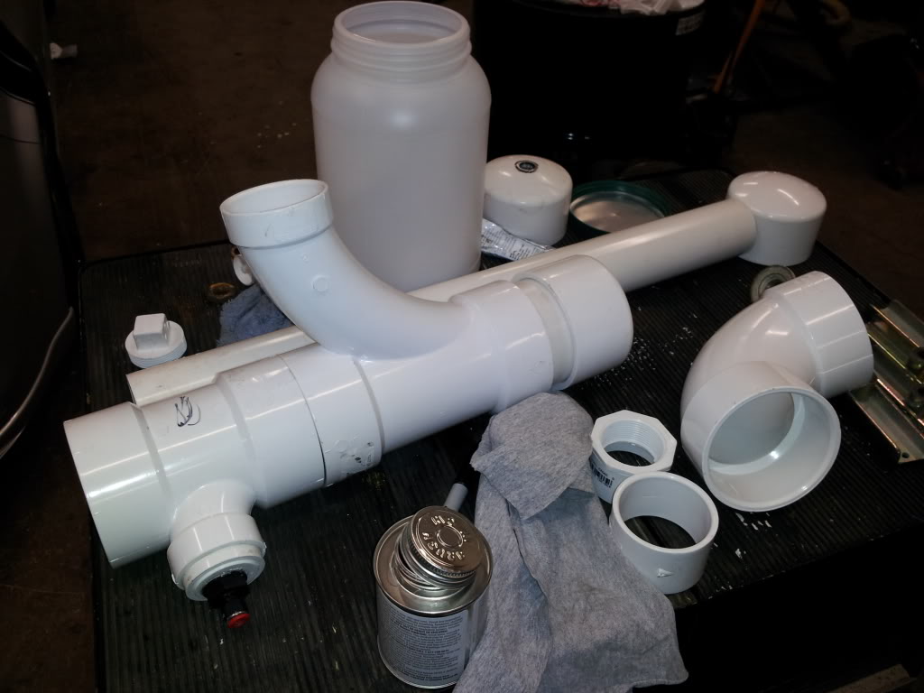

Now here comes the crazy part. The tank that i had was not about to fit in the front of the car. I'm saving space on the passenger side of the engine compartment for an option b, and i don't wanna give up my windshield wiper fluid resoviour. Putting it under the passy headlight would prove to be a pain in the ass to fill, so we decided to make our own front mount tank... Out of PVC piping and accessories
I gotta live up the riceburner name somehow right?

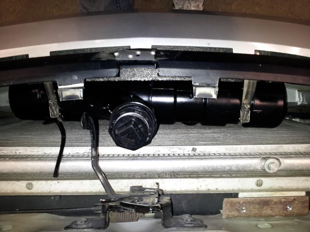

it sounds crazy, i know, but it works. We made a design the fit right behind the metal front bumper support, so that theres nothing blocking the ac condensor and all that. Also it fits right on top of my ottp stage one heat exchanger since its so small and only covers the bottom grill section.
So we found a piece of PVC with a branch to serve as a filler neck, then fabbed up the rest, complete with a sump at the bottom to ensure i'm never gonna be pumping in air under WOT.
The filler neck winds up right under where the hood release is, so i can unscrew and pour in fluid right there easily.

In the works.
Completely made:
It holds roughly .8 gallons, and could have held more, had we made it wider
It doesn't leak at all! PVC FTMFWWW
Painted. About ready to be filled with boost juice.

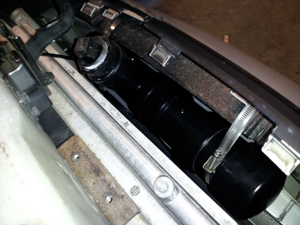

In-*******-stalled. We used some long stainless clamps and basically wrapped it around the bumper support and held them to the custom tank. Lets just say, its not going anywhere ever.
put the grille back in, fit nicely, not much more of a PITA than usual, as i was worrying about.
