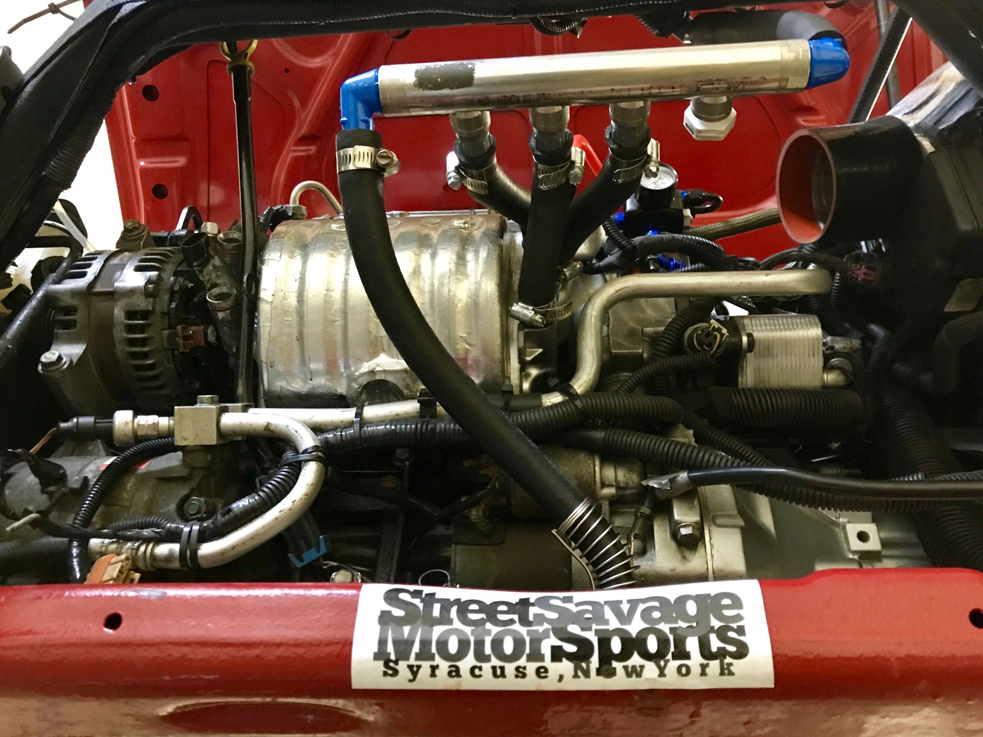

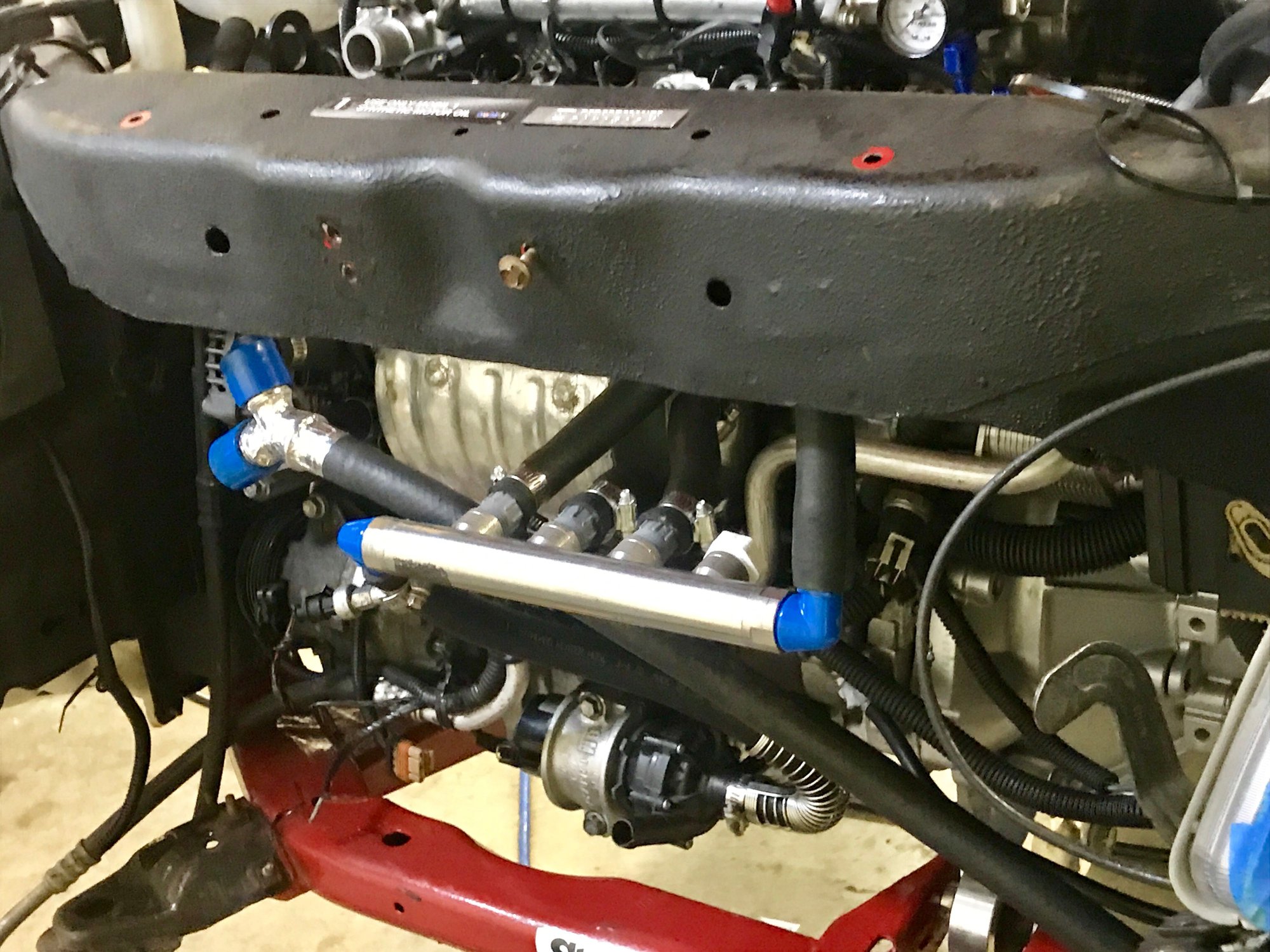

Pics of said manifold?
Stainless manifold above

In short, the answer to that question is,

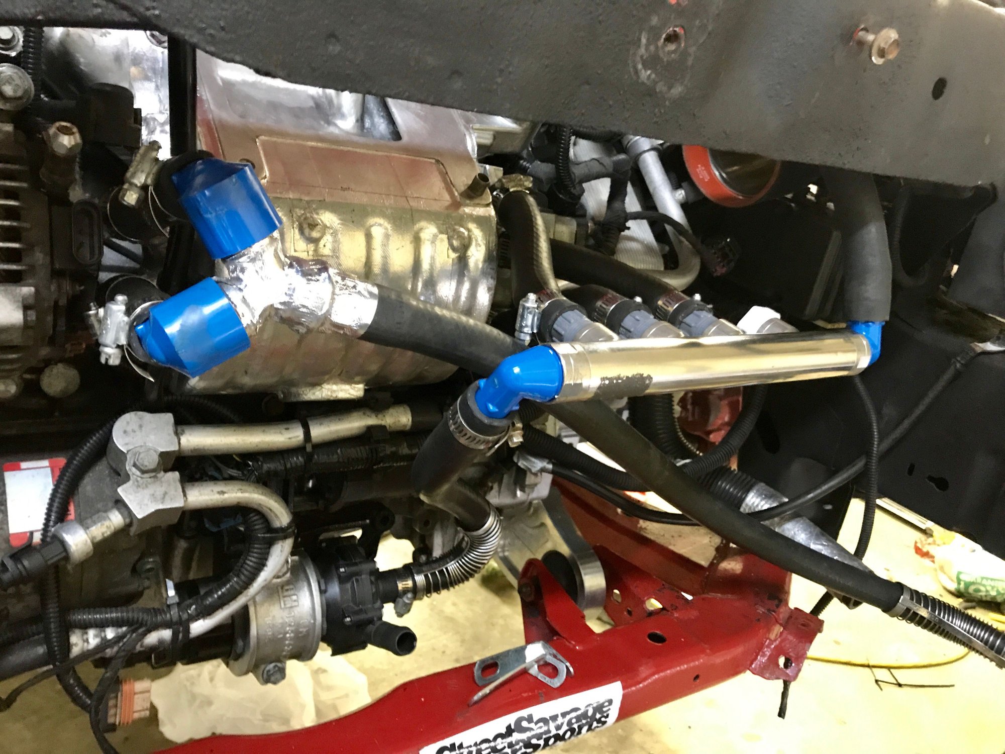

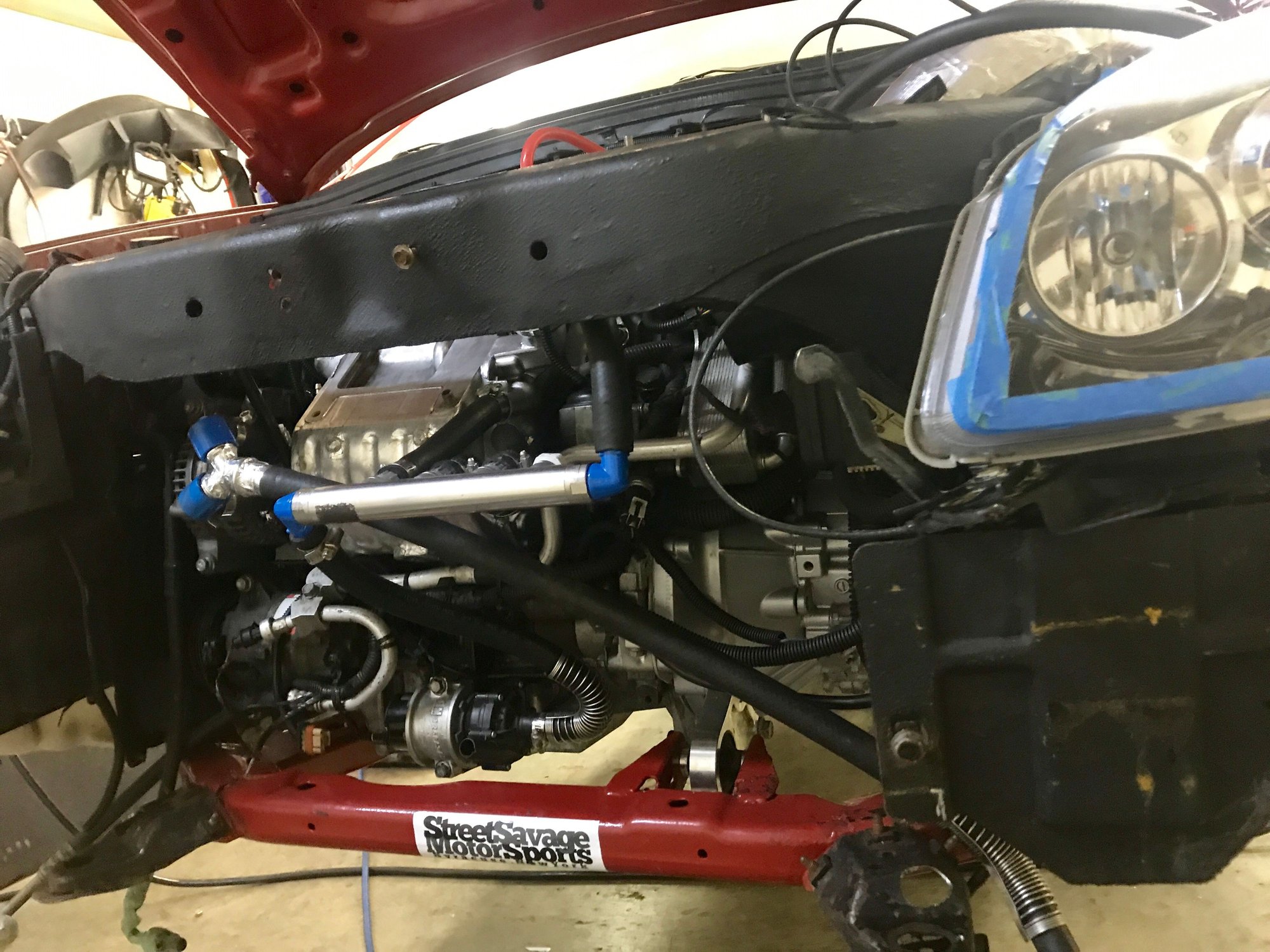

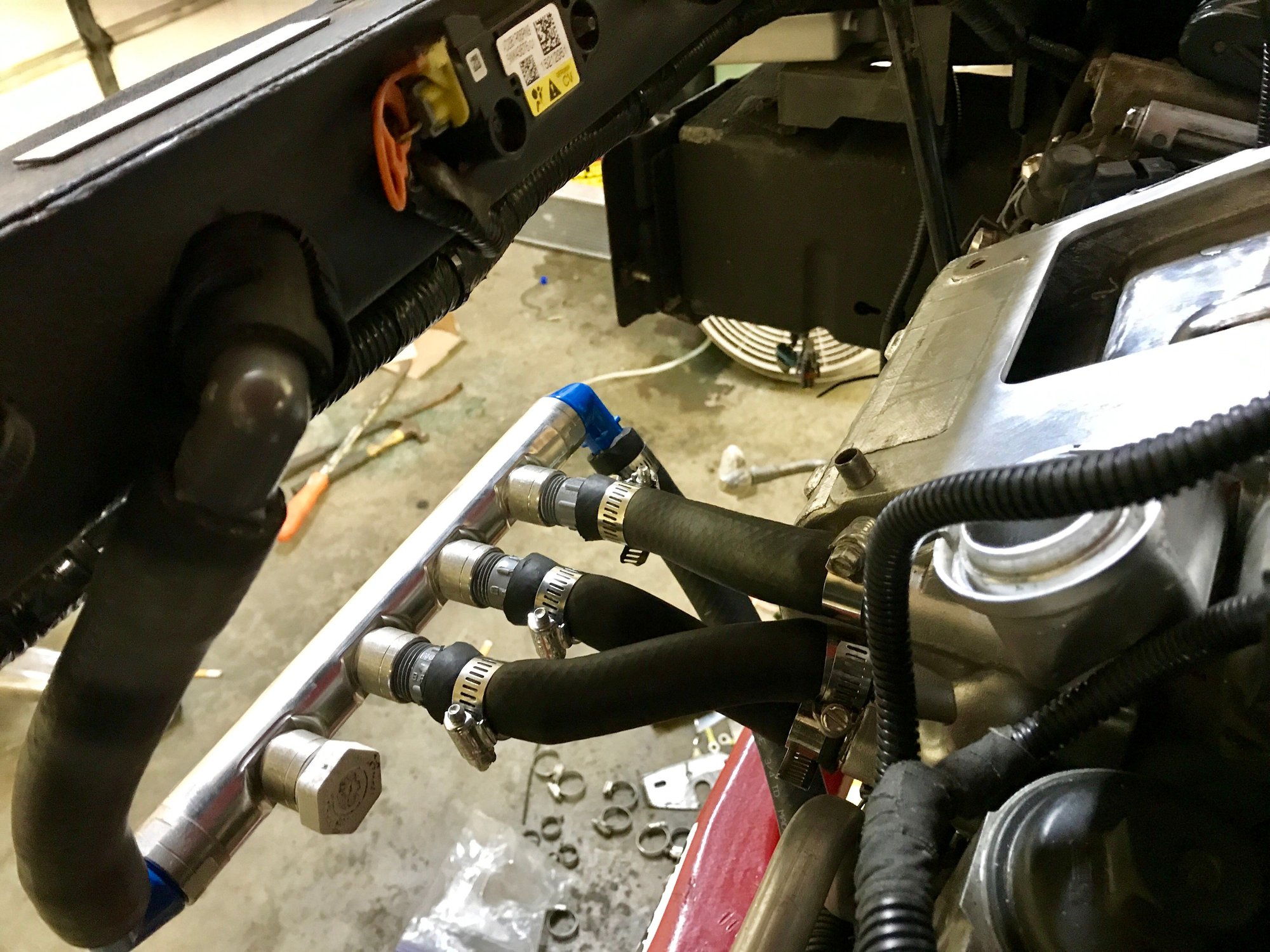

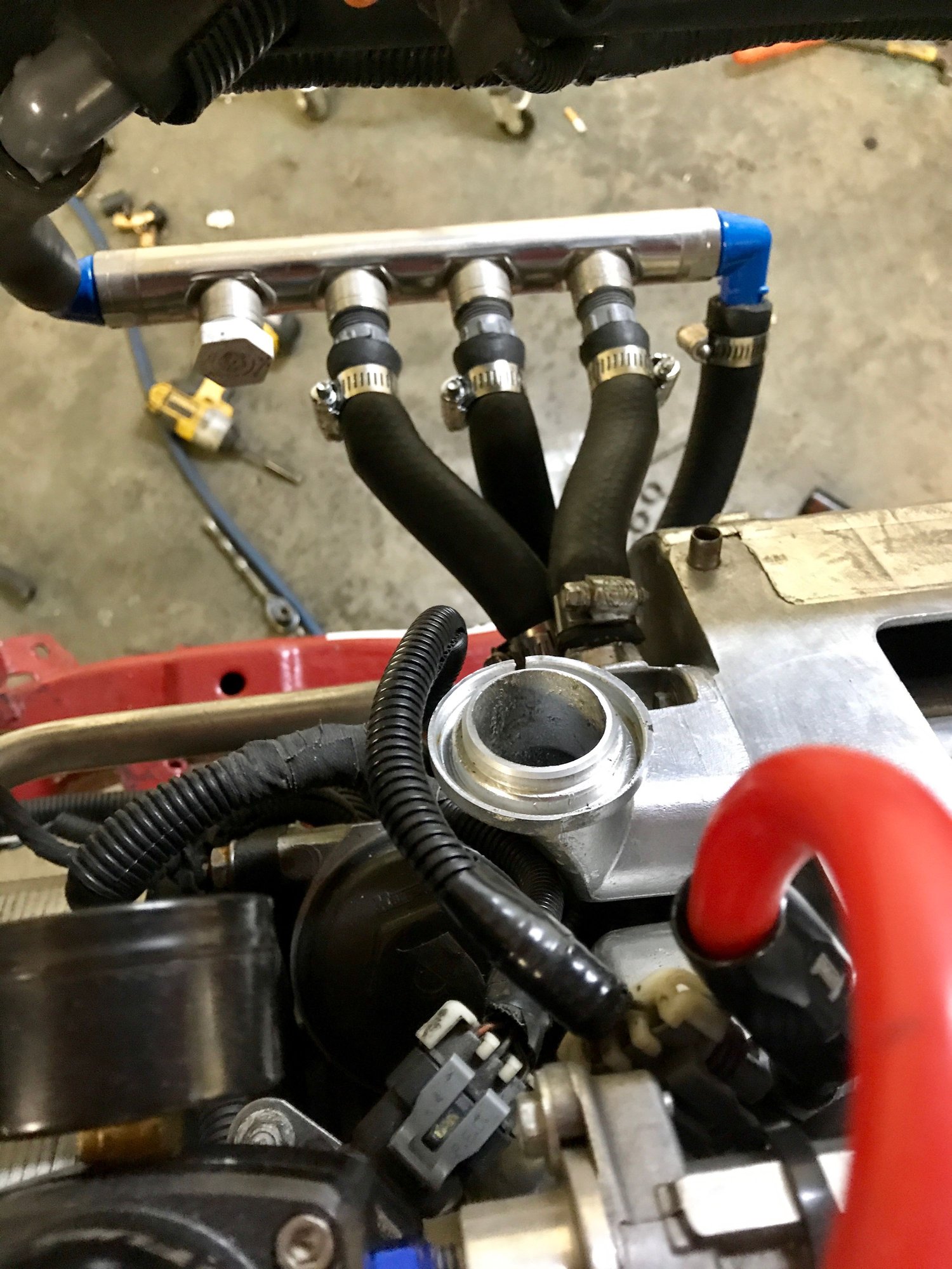

Purchasing parts, a lot of research, experiments, homemade engineering,fabrication, attention to every detail and a commitment to eliminating as much heat that isn't ambient as possible.
Detailed & specific answer to that question is here, a list of everything currently installed in my car that contributes to the low iat2's
Less air restriction from start to finish,
airflow:
-6.75" turbonetics velocity funnel taking in air from the from bumper w just a screen, no air filter
-, 4"-3.5" intake piping
-ls4 tb
-harrop tvs 1320, 2.8 pulley
-ported & polished intake manifold to match head ports
-Zzp ported head
-zzp long tube header 1.75" primary's - 3" merge collector
-zzp 3" cat less down pipe
-zzp 3" exhaust w resonator & muffler
intercooling:
-Custom fabricated 4 core x 1 pass intake manifold intercooler; 2 entrance fittings, 3 exit fittings (zzp dual pass)
-Custom stainless steel "exit manifold" -3) 3/4-1/2" inlet fittings, 1) 3/4" outlet fitting, 1) 3/4" overflow resivior fitting
-3 gallon inline icebox
-1 overflow resovior
-2) heat exchangers (zzp s3 & zzp stealth)
-2) inline water pumps
-80/20 Bottled water to Coolant mixture
-2 bottles of Royal Purple: Purple Ice
-2) 7" h.o. Pusher fans mounted to stealth he where the bumper covers/blocks air from hitting the fins
extra heat soak & transfer precautions taken:
-DEI titanium header wrap around header & down pipe
-dei titanium heat blocking sleeves over heater hoses & Coolant overflow Line
​​​​​​​-dei cold intake wrap around air intake
-dei aluminized heat reflecting tape over Coolant overflow, water pump & pipe, thermostat housing, intake manifold
-7" h.o. Fan over the blower
-zzp silicone radiator hoses w dei heat reflecting tape & 1" conduit/looms over the hoses
-zzp phenolic intake manifold Spacer & paper gaskets
-deleted pcv/intake return hose in exchange for a pcv breather filter
More misc measures:
-Zzp oversized aluminum radiator
-80/20 bottled water to Coolant
-1 bottle of Royal purple: purple ice
-NGK v-power spark plugs 2 steps colder
-Sunoco Race Fuel E85-R, which is always a consistent combination of 85% ethanol & 15% highly oxygenated race fuel
-AIT Racing Zen body kit (front bumper applies to this list being I bought it bc of how much larger the grill openings & side vents are than stock front bumper)
-Extreme Dimensions fiberglass Air Splitter

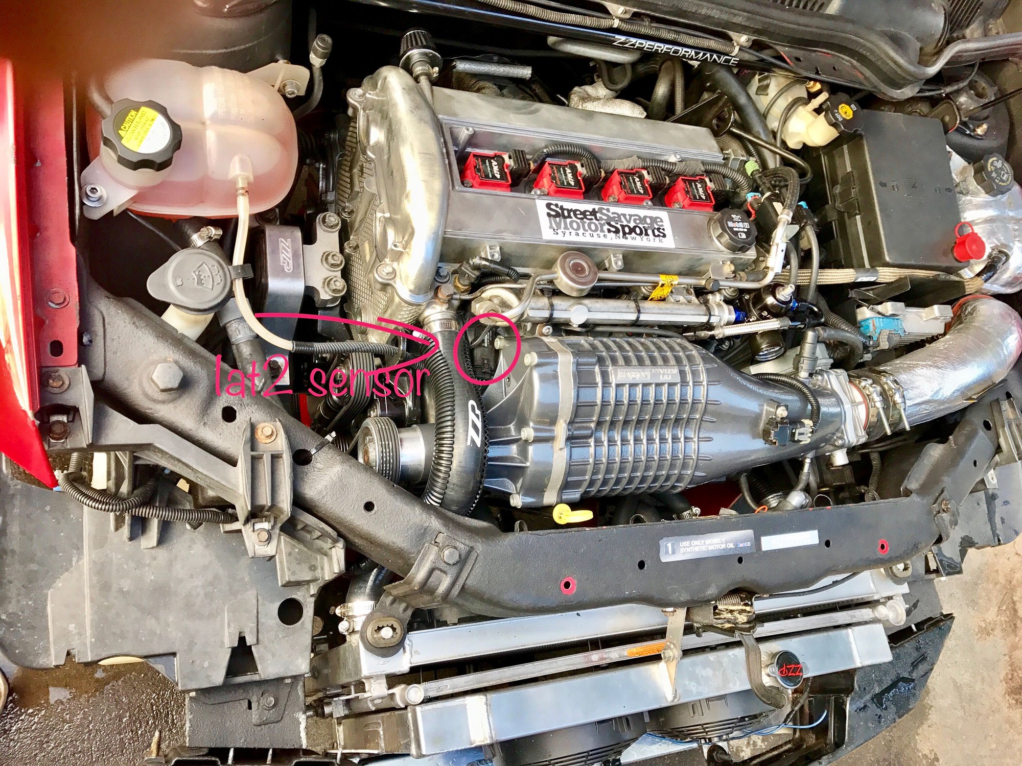

Originally Posted by ECaulk
I'm going to bet a lot of that is due to a delay in the heat transfer from the air to sensor. Not sure how fast of a response the IAT2 sensor has on the LSJ or it's location relative to airflow or any of his cooling lines. If he has a line running on top of or next to it he could be skewing the reading.
its sandwhiched between, a hot blower, Coolant Line & radiator hose, if anything it would be skewed in the opposite direction.
Refresh rate on my scan gauge is at 16x so it's refreshing more often than we blink

I'm assuming your iat2 must be really high during a pull and that's why you're having such a hard time believing this lol. Idk about idling for a half hour because obv the iat2 is going to go up at idle bc of the lack of air passing by the sensor. But even still, I have 3 extra fans on a switch So even idling for an extensive period of time, yea the temp goes up but as soon as I get going again it goes right back down lol.
Anyway i I seen your post last night, litteralky walked outside popped open the he resovior and the liquid in there was 30*+\- below ambient, without any ice in the icebox. Pointed at liquid in resovior
Pointed at valve cover
