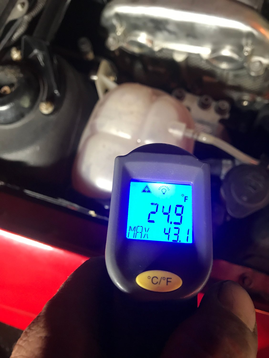

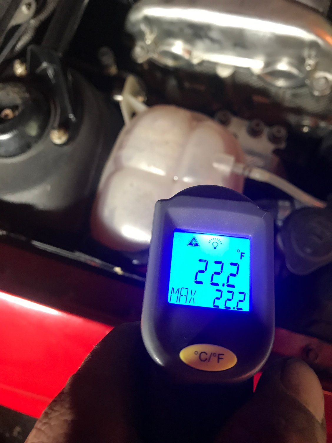

I'm assuming your iat2 must be really high during a pull and that's why you're having such a hard time believing this lol. Idk about idling for a half hour because obv the iat2 is going to go up at idle bc of the lack of air passing by the sensor. But even still, I have 3 extra fans on a switch So even idling for an extensive period of time, yea the temp goes up but as soon as I get going again it goes right back down lol.
Anyway i I seen your post last night, litteralky walked outside popped open the he resovior and the liquid in there was 30*+\- below ambient, without any ice in the icebox. Pointed at liquid in resovior
Pointed at valve cover
How are you breaking the laws of thermodynamics?

58 degrees outside and the gauge is reading 22 degrees?!?! im ******* amazed that this guy has crushed my child hood dreams of Bill Nye the Science Guy teaching me everything!!!

Like has been said, without ice it's against the laws of physics for a liquid to be colder than the air cooling it without a heat pump. Heat transfer is driven by temperature differential and if your fluid is that cold (we'll pretend it magically cooled below ambient without ice for a second) you would actually be HEATING the liquid with the air flowing through the heat exchangers.
Also this temp is below freezing. Do you use dry ice or put salt on your ice? If your IAT2 temps are BELOW ambient during a pull or normally that means that the fluid exiting your intake manifold is below ambient. Like I said earlier when the below ambient fluid flows through the heat exchangers they will actually be heating the coolant. So if you are actually telling the truth you would be better off just running your coolant through the icebox and having a bypass around the heat exchangers.

It has ice in the ice box monday morning, it's been 75 during that past couple days here, I can't see in the ice box to see if its melted, but the resovior isn't inline with the icebox, just an overflow. car idled for about 20 minutes to try set piston rings.
There is antifreeze in the mixture so that it can go below 32* and not freeze, a couple bottles of royal purple: purple ice & bottled water. Guess you'd have to see to believe idk. I was pretty surprised myself when I seen it reading in the 20s
I'll take a couple videos at dyno next week, there's nothing more I can say or do to explain why my intercooler works very well, I've already listed the reasons for why above. And it's not like I'm making some crazy claims out of no where looking for a attention or anything of that bature, I didn't even make this thread someone else posted a picture of my car and people stated askin. Questions, which I've explained to the best of my ability, I have no reason to lie or bullshit anyone.
i love how forums work though, someone asks a question, I answer it, Then argue with me about my answer lol 🤷🏻*♂️

You're still violating the laws of thermodynamics, you never addressed this. Unless you have an extremely well insulated ice box (or a huge one) there is no way you're getting 22*F. The lowest temperature for pure water ice is 32*F, those chemical additions will not allow ice to get colder since they don't come into contact with it. If you're running dry ice the 22*F is possible but after almost a week in there I doubt much would be left.

You do understand that even if your heat exchanger is 100% efficient it CANNOT cool your coolant to a temperature BELOW the air that is flowing through it right? It's physically impossible. And if your coolant mixture is BELOW ambient your heat exchangers are actually RAISING the temperature and you would be better off without them. These are just basic facts that apply to anyone. No matter how special your setup is it cannot defy the laws of physics.

if that tank was really that cold with ambient being what he claims, wouldnt the tank be covered in frost? kinda like your a/c drier gets.

Good point, it should at least have condensation on it.
