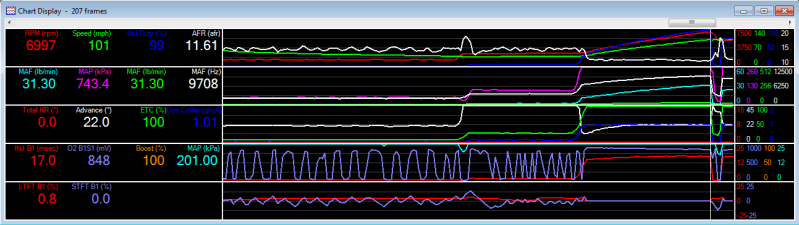

Originally Posted by ULWizSS
IMO you can run a 2.8. The only think you cant do is consecutive pulls in the car.
How do i know this, i monitored mine on the 2.9 and 2.8 with HPT. 2.9 was fine and consecutive pulls could be done but add a 2.8 with no cooling mods and 1 pull is gonna be it before it cools back down.
Post your logs where you rev'd it out to 7,000 rpms.
Back to back pulls really doesn't have anything to do with it. Its all about maxing the injectors at high RPMS and running lean.
Originally Posted by Vander Nars
I wouldnt run anything past 2.99 im running a custom tune with gm stage 2 pulley (3.06) and stage 2 injectors(42s) and im already maxing them.
Good advise. I did the same thing.
GM 42# injectors, stock GMS2 Pulley, custom tune.
99% IDC at 7k.
