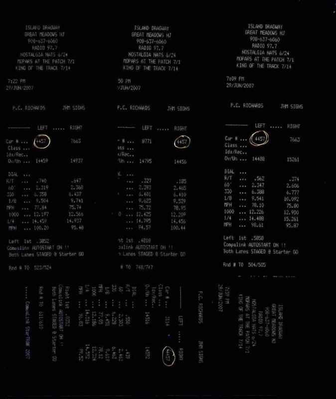

here are the times.
sorry if they are hard to read.
if it was my driving, my times wouldn't be so consistant.

Well, the 60' times are killing you.
What are your steps while you go through the water box to the time you launch.
Be descriptive as possible.

well i go to the water box put up the e-break and burn them up or like 3 sec till i got some smoke that at about 5200rpm in first than i line up tigger the lights and and rev it up to 2500 to 3200 rpm and than i dump it and its hooks than i take it up to 6900 rpms on each shift i cross the line in 3 AT 6500 RPMS im temp on the coolant were like 185 than after i burn them up casue of the meth it gose down to about 180 to 181.

DAMN!...if i launch at anything over 1300 i got 2.5+ on the 60ft... then again those rubbers you had on were out of control.

are you on the stock tires when you burn out..?
I'd suggest you not doing a burnout if you are.
I actually launch under 2k and I usually hit 2.0 60' times. I limit boost in first, it kicks it, just not as hard.
