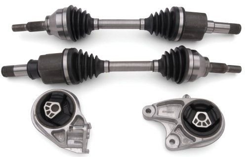

I get wheel hop like horny jack rabbits!
I'm thinking these three items would solve it 100% correct?
ZZPerformance - Rotated Front Trans Mount #05-02-00985-R2
ZZPerformance - Rotated Rear Trans Mount #05-02-00986-R2
ZZPerformance - Billet Engine Mount #05-02-00257
-Jamie M.

yes but its my OPINION(toss that part in before we have another pissing contest) that you will have alot of vibs prolly, id go solid mount up front and LNR mount with spacer in back and im not sure how bad vibs would be with the engine mount and just one solid mount.

a solid mount isent needed with zzp or ottp mounts or the lnf mounts the soild is gonna vibrate realy bad

Make sure you torque and install it correct are you gonna have hella vibs then.

The GMPP Wheel Hop Kit is back. Although discontinued from GM we have a limited number of these in stock at a special price of $560.00 plus shipping.
These kits include LSJ Heavy duty axles, LNF rotated mounts. All of this has been discontinued from GM but we do have some still in stock. Contact me for details.
