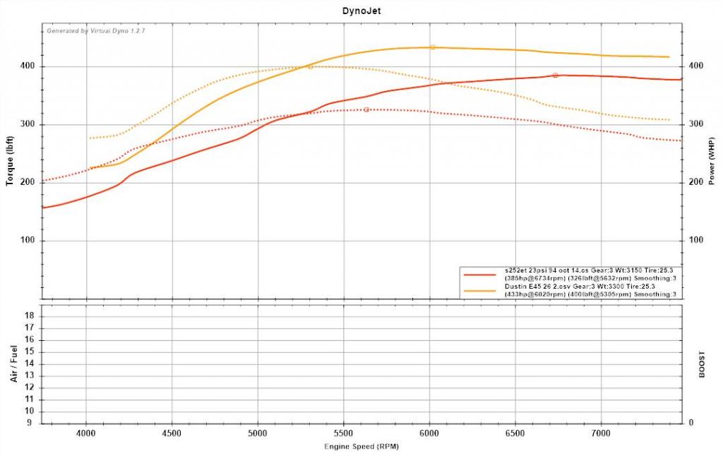

Well I got bored at work so I started going through some of Dustin's (Bluelightning) logs and stacking them up in Virtual Dyno. All runs were done on the same road, and the ones on E45 were done within about a half hour of each other. Only changes I made input wise was I added my 150 lbs to the 3 logs where I was in the car. Most of these pulls start right around 4k as you can see. Don't pay attention to the log names, as the E runs were all on the same mixture.
The car: 2006 Cobalt SS LSJ-Turbo converted
Gen 3 2.0, has factory Gen 3 direct injected pistons
ZZP s252et turbo kit
Ported head w/ZZP S2 turbo cams
That covers the important stuff
These are the 2 runs that we actually got to throw on the dyno to compare accuracy, of course I am using the Dynojet setting for VD, but the Superflow seems to be pretty similar, and of course the Mustang Dyno will read a bit lower. Torque seems a little inflated on both of them in VD.
Red Line: 94 octane E10 pump gas, 23 PSI falling to 21, 11.8-12.0 AFR, 19* peak timing up top. This made 380whp/307tq on a Superflow Dyno for reference.
Gold Line: ~E45 mixture, 26 psi falling to 21, 11.6 AFR, 25* peak timing up top. This made 406whp/340tq on a MUSTANG Dyno, wasn't able to get back on the Superflow.

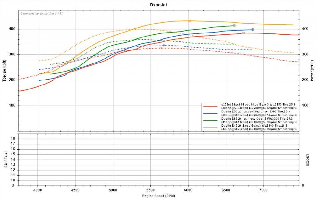

What is cool is seeing the difference in the runs between those 2, as we worked our way up to the final numbers.
Blue Line: ~E45 mixture, 23 PSI falling to 22 (didn't rev far enough to fall to 21), 11.8 AFR, 19* peak timing. Same fueling and timing as the 94 runs, just on E45 as a starting point before turning up.
Green Line: ~E45 mixture, 26 PSI falling to 23 (didn't rev far enough to fall to 21), 11.8 AFR, 19* peak timing. Again, same fueling and timing as the previous runs, just with more mid range boost.
Gold Line: ~E45 mixture, 26 PSI falling to 21, 11.6 AFR, 25* peak timing up top.
As you can see, hitting the boost harder moves peak hp and tq lower in the rpms since we didn't have enough wastegate spring to sustain any additional boost up top. Next year with that fixed we should be on track to some good power up top!
Another thing to note. This car on 94 octane picked up 18whp from slowly leaning it out from 11.5 to 12.0 AFR WHILE ON THE DYNO. Making progress every time an adjustment was made to fueling with no timing changes. It richened up a little on the dyno, so Dustin leaned it back out to what we ran on the street. On E45 however, there was less than a 3whp change from everything from 11.3 AFR up to 11.9 and anything in between. I have also experienced the same results with my car on E85, so I leave it on the safer side since no power is being left on the table.

Pretty sweet results. I used the VD after hearing about it from you and its a really cool program.
Your results are great. Those curves increased identically after every revison too.
Good work !!
Good work !!

Here is what I can tell you. Most of the runs we started so the boost came in right around 70mph and we pulled most of them to 120 or so, but the 2 short runs I posted above didn't go that far, and one only went to 107 mph at 6700 (first 26 psi pull above) so for comparison I'll show the 70-105mph times.
70-105 times corresponding to the lines in the graph I posted:
Red Line: 4.3 seconds with him in the car alone
Blue Line: 4.2 seconds with us both in the car
Green Line: 4.0 seconds with us both in the car
Gold Line: 3.6 seconds with us both in the car
That's about the best I've got for comparisons at certain speeds, so hopefully that is worth something to you!

That's also going from 26psi falling to 22psi by 6800 rpm I may add on the 3.6 second pull. Need to tackle that issue in the spring so it holds boost all the way to redline.
