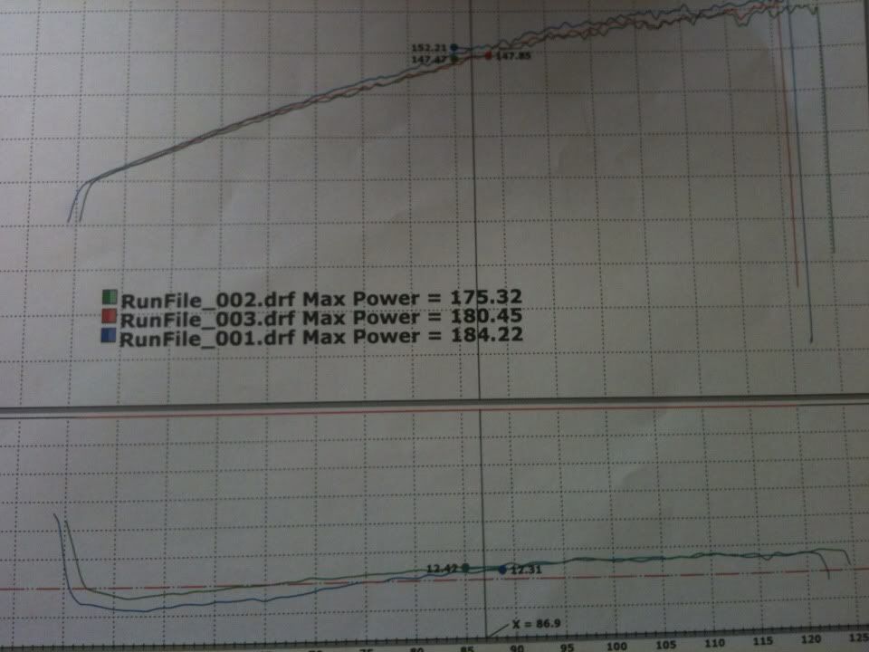

just got back from speedtek running 184whp and 152 ftlbs
wut dafuq? What size pulley do you have? Injectors? AFR? Is the air being cooled? How does it drive?

3.4" Pully. 39# injectors. Stage 2 exedy clutch. It runs good tune still a bit off little bit lean at about 6k rpm at 9psi on 93 octane
