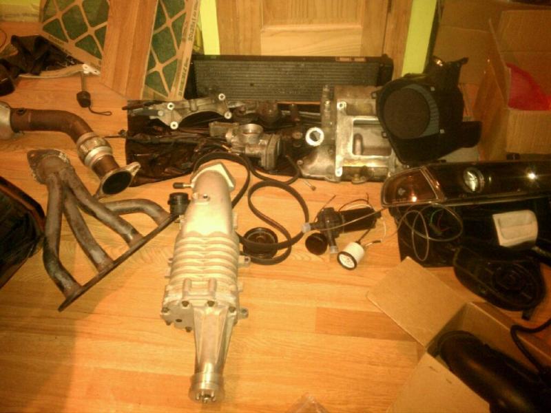

bluestreaks sc build be prepared for some Q&A
I got most of the major parts off this site so thanks to:
Sc. Guy on craigslist
42lb injectors. Twoofjuiced
Lsj tb, intake mani, idler pulley and tensioner. Dannycin
Lsj belt rivaldore
Zzp headers and dp combo rivaldore
Wideband agita san
Boost guage some doode at work
2.9 pulley zzp
And more
I will be starting this build as soon as my tune and cable come in from bnr.com hopefully this weekend

Generator Relocation Bracket does anyone know what this look like? GM Part #12584365
Old Jul 16, 2012 | 01:44 AM
bluebalt07's Avatar
Joined: 09-07-11
Posts: 3,221
You have one in your pic in the first post. It's the thing with four holes right on the bottom left of the heat exchanger. Also known as the alternator bracket.
