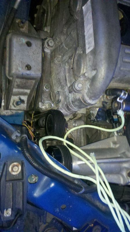

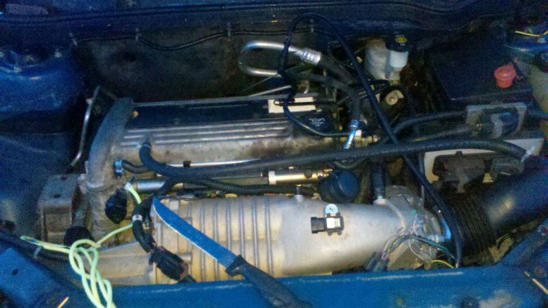

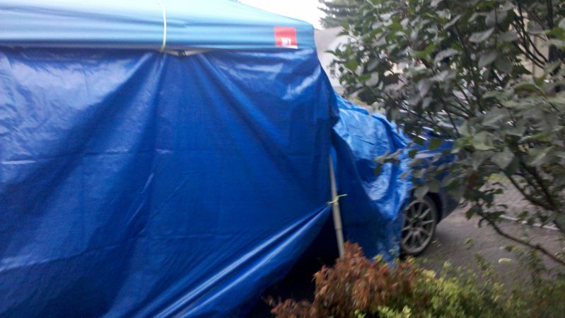

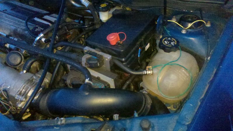

not even rain can stop me!!!! Name:  IMG_20120720_180458.jpg
had to saw zaw the lift hook/motor mount and move the bolt more to the middle Name:  IMG_20120720_180529.jpg
