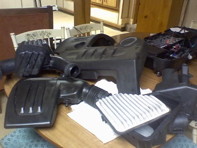

Old Jul 21, 2008 | 12:53 PM
bboyfreeflow's Avatar
Joined: 07-08-08
Posts: 711
From: Boston
thanx to everyone for helping out, appreciated! ,,here is the pics..
http://img.photobucket.com/albums/v7...ow/plastic.jpg - all the **** taken out
http://img.photobucket.com/albums/v7...low/intake.jpg - after! i wish the filter was showing, i like the appearance, but then again, the air wudnt really be that cold near the engine,
also i know this is kind of silly, but does the brand name of the intake really make that much of a difference,,, because, it is really just the steal pipe and the filter.... just wondering, because i found mine off of ebay, so just curious
Old Jul 21, 2008 | 02:12 PM
Whitty's Avatar
Joined: 05-03-08
Posts: 1,357
From: Halifax Nova Scotia, Canada
no real difference other than the name. sometimes they will throw a CEL other times they wont. I dunno there really isn't a substantial difference. Except with Injen you can go between CAI and SRI
