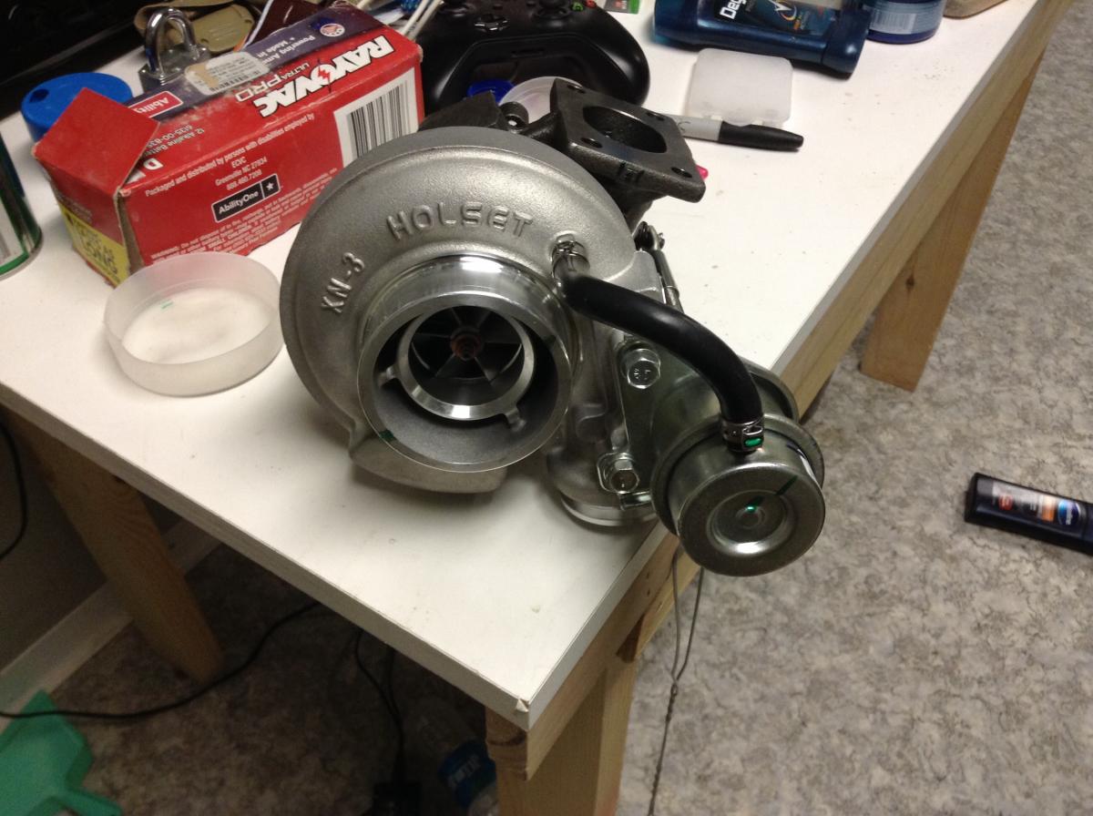

Il take a couple of pics of it when I get off work amd il post them

Here's one pic I have a couple more excuse the mess getting ready to end deployment

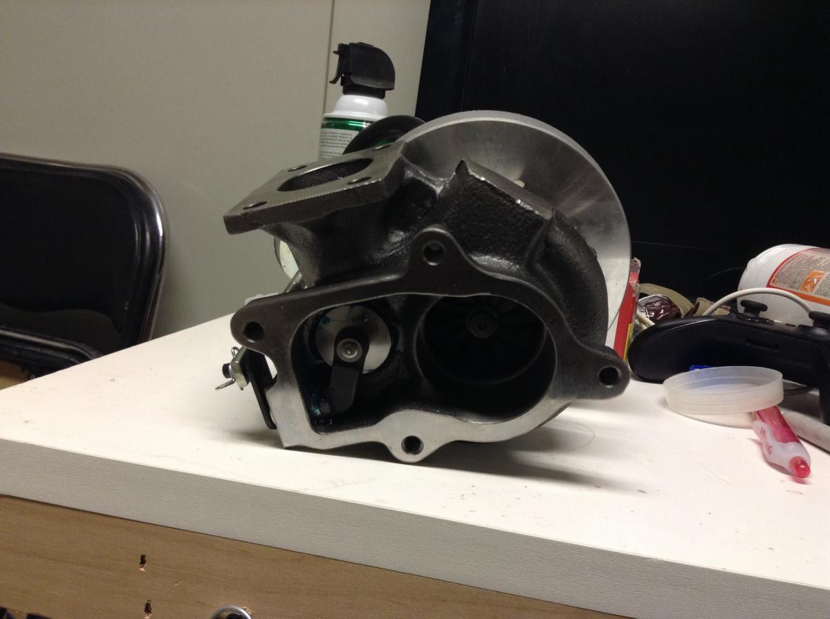

Here another pic

Did you say you have something for the exhaust side to connect it like normal?
Old Sep 12, 2014 | 04:24 PM
  #359
Kiddj246's Avatar
Joined: 09-09-14
Posts: 36
From: Virginia beach
No I said I bought the adaptor for it to connect to that turbo manifold from zzp

But after the manifold you have that weird thing to the DP, have an adapter for that too?
Old Sep 13, 2014 | 03:38 AM
  #361
Kiddj246's Avatar
Joined: 09-09-14
Posts: 36
No I was gonna take it to a exhaust shop and have them make me one idk what that paters is even called to buy one
