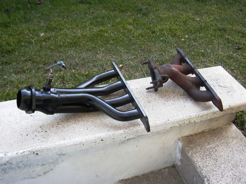

Originally Posted by 06Pursuit
right here man
yeah, the stock header looks like that with a triangular shape end while the one i ordered doesnt, would u mind telling me how the installation would work because my friend n i tried n it just wouldnt fit unless we were doin it the wrong way
yeah, the stock header looks like that with a triangular shape end while the one i ordered doesnt, would u mind telling me how the installation would work because my friend n i tried n it just wouldnt fit unless we were doin it the wrong way.

Originally Posted by MagCobalt
I got OBX Racing header, they fit perfect. i'd put a picture but i dunno how. but they look just like that guys black one.
I ordered obx headers too but they just dont fit or im doing something wrong because the picture above is what i have, the stock have a triangular shape end while the obx only has too unless theres a piece missin, someone help me out here

so is the picture above showing that what i have is wrong or that its right, cuz if so than thats what i have, What is the whole purpose os the pic than
right here man
Can u give me specified directions on how u installed those headers because i have no idea, thank you, can u see the difference with the headers?i do
the one you have is not a direct replacement. it's not missing a piece. you have to cut your downpipe for it to fit. there's nothing else you can do. it fits fine, you just didn't cut the downpipe.

you need to cut, flair, and flange your orig dp or buy a new one designed for it.
