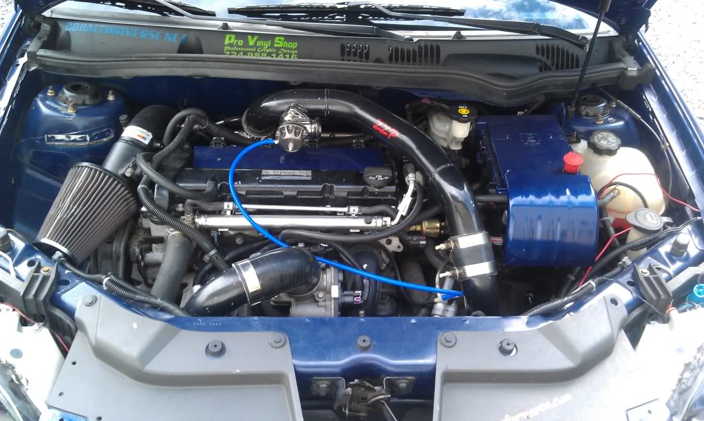

Old Jul 13, 2012 | 10:28 AM
  #44
stenguyen1's Avatar
Joined: 06-03-08
Posts: 1,962
From: Spring, Texas
yes it will. take a pix of your head for me and i can tell you if it does or not. and the valve cover.
Old Jul 13, 2012 | 12:53 PM
  #45
klutch814's Avatar
Joined: 03-06-11
Posts: 3,023
From: philipsburg, PA
i will later on today man
Old Jul 13, 2012 | 05:37 PM
  #46
klutch814's Avatar
Joined: 03-06-11
Posts: 3,023
